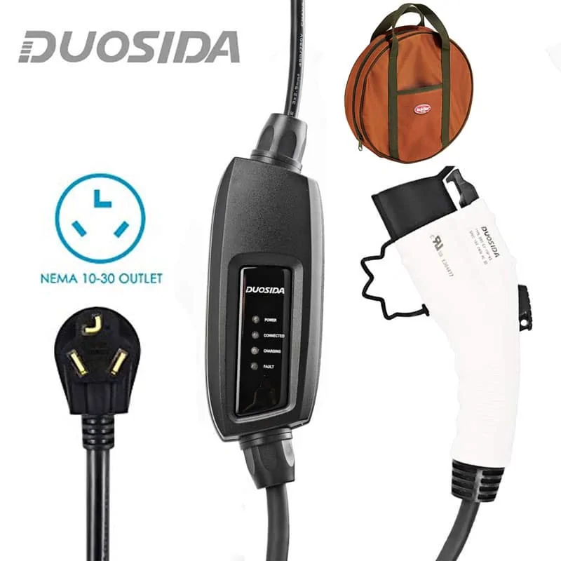

For the safety of your home please don't buy an evse off eBay. Go straight to the manufacturer or a reputable retailer and ensure the unit is UL or ETL listed, if not both.
EVSE bought from Amazon I have been using for 3 years now with ZERO issues and never had a problem since day 1 for my Honda Clarity PHEV:
Ford F-150 Lightning Charging details... doing some pre-planning 2
The charger itself limits the current to the car by the onboard inverter.
When I get the Ford EV, I will be installing the 32 or 40A charger as it's a straightforward 240V circuit. I normally have my charger on a timer overnight when rates are lower.
As for the power backup, unless I get a solar PV panel installed w/ auto switching inverter & battery pack, I am not springing for the 80A option.
I'll run 10ga extension cords from the Ford to my house for essential items (lights, refrigerator)....
