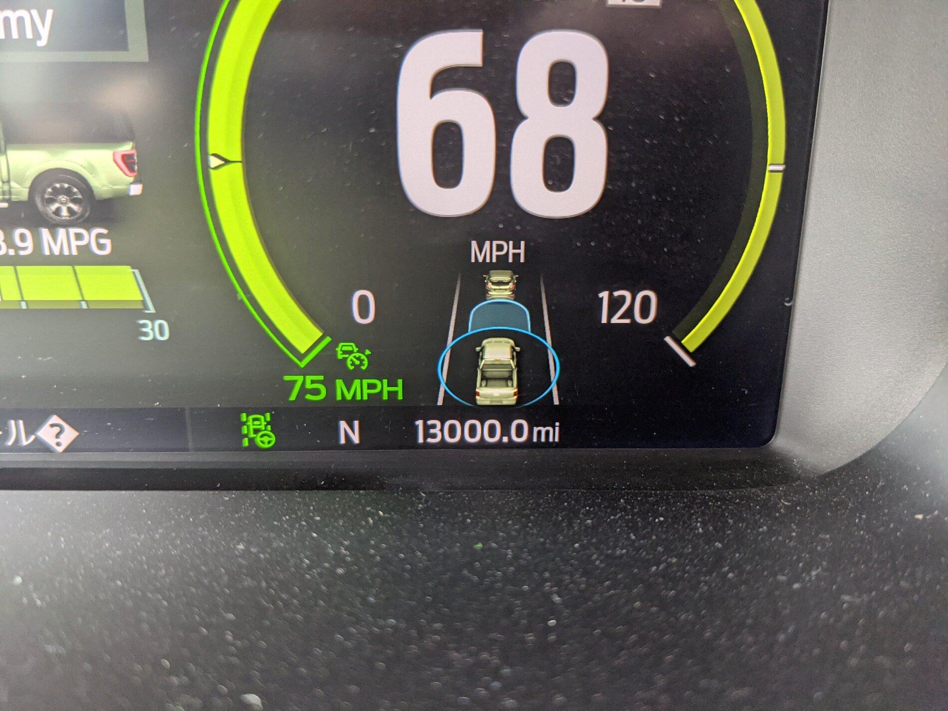

I got this interesting message randomly. Went away when I unplugged my phone and dash went back to normal. Unrelated to losing the dash settings after every restart (probably).
Anybody else ever see a weird message like that? A friend said it's just jibberish like a corrupt message.

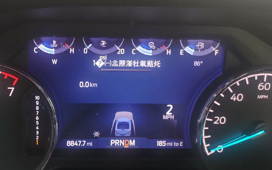

Is that possibly where the title of the song playing is displayed on you cluster? I'm not familiar with the layout of the 8" cluster, but on the 12" it's on the bottom center, and depending on what is playing it will attempt to display other languages as closely as it can. If however it comes across a letter or character it can't reproduce it throws up the question mark in a diamond symbol.
Below are a couple of shots I've taken, and you'll see that in the lower left side they are displaying characters displaying in Japanese and the second photo is also displaying the question mark symbol. Please excuse that they are offset and cut-off, that wasn't the original intent of the photos.
It could be the "Now Playing" info that's trying to display, but the fact that I'm seeing a mix of metric/imperial units on the same screen leads me to believe it was more of a general display bug.
Ah yes, I didn't notice the 0.0km at odds with everything else on the screen, just what I assumed is the Now Playing banner.
Interesting.

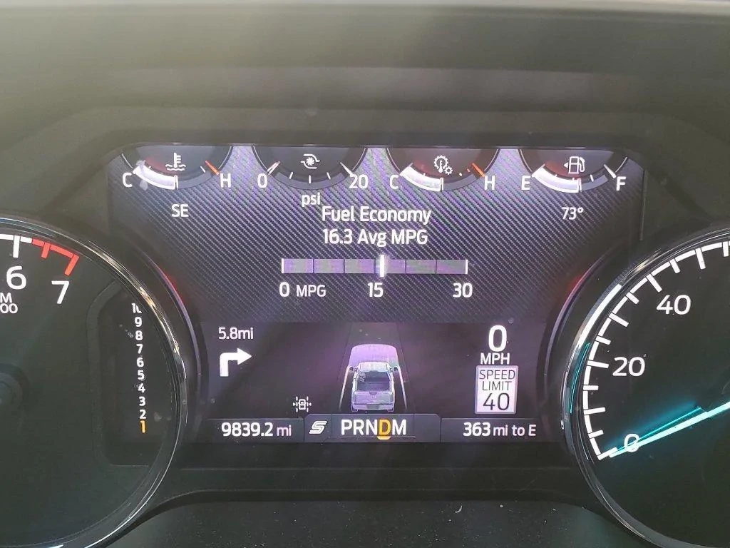

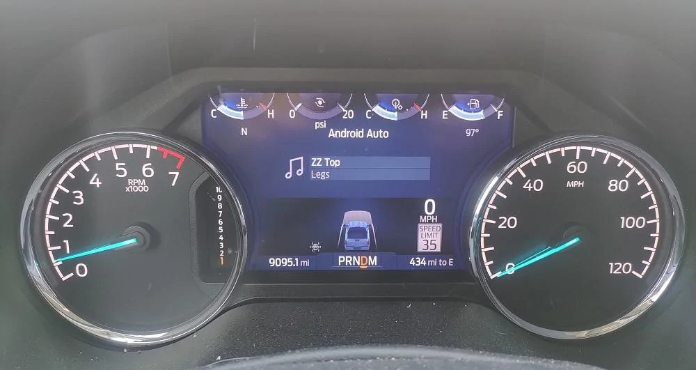

Anyway here's what the 8" cluster looks like when playing a song from Android Auto. I think you're right, it was probably just a weird glitch, only twice now in 9000 miles, resolved by unplugging/plugging. I have had to unpair/join Sync4 with Android Auto way more times than that, it just stops talking. Also seems picky on the cable, I'm having good luck with a 3 foot Anker right now, USB-C to USB-C.
Overall still very happy with the truck. Just hate my routine of push auto-stop button*, run through menu to turn boost gauge back on, sometimes set back to Eco (doesn't really hit my MPG so I'm not anal about it). I like settings that stick, and this truck was built for people like me that love a bunch of buttons. Buttons for days!

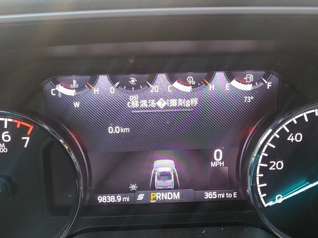

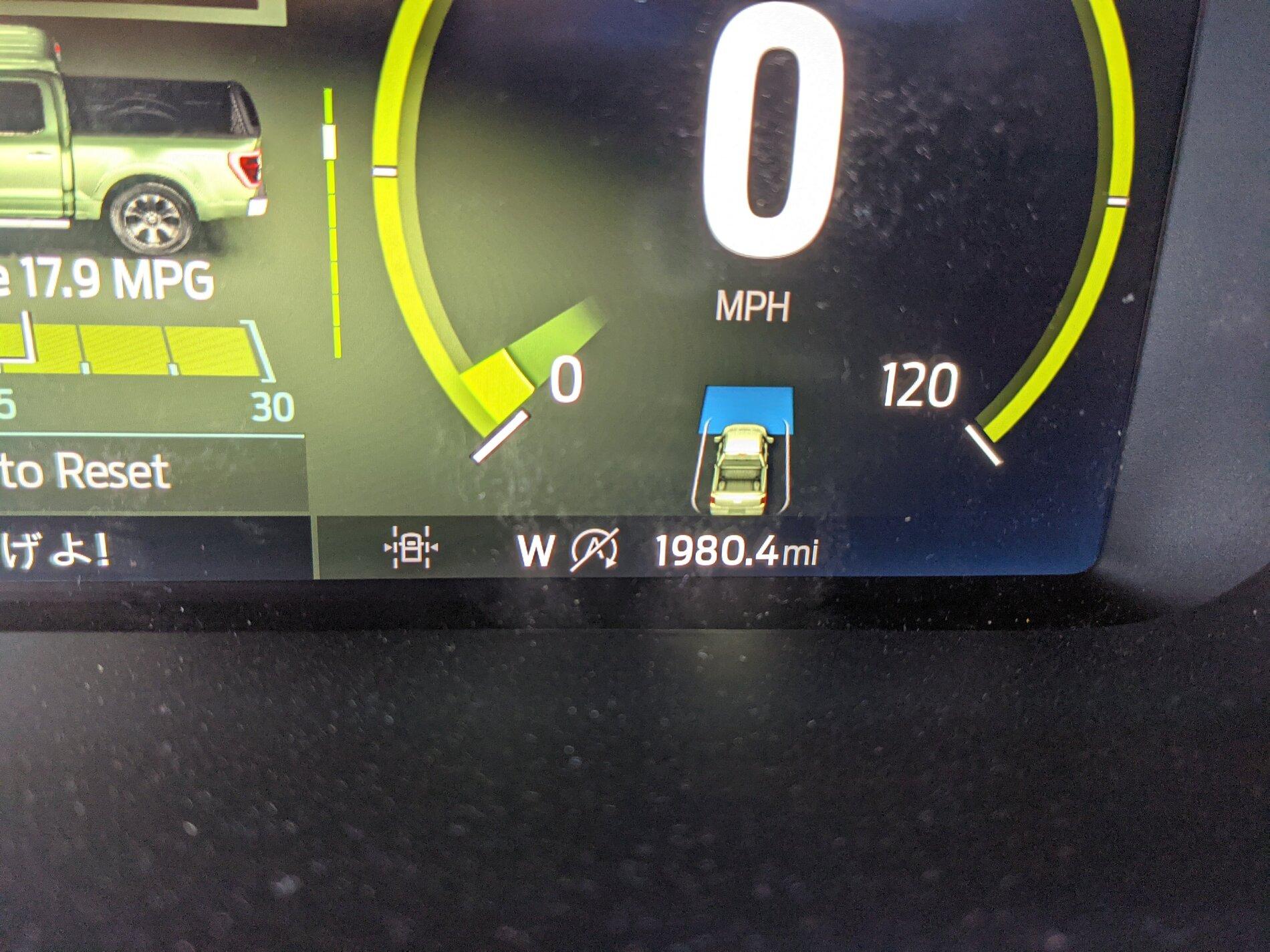

Smitdog I had a similar reboot last week. Had driven somewhere, shut off truck & got out. Few minutes later got back in, depressed brake, pushed start button. It started, but then I got a warning that collision something was unavailable, and I think it warned about reverse camera unavailable. The radio screen stayed black, not even the Ford logo. I was a little worried about driving it but after a couple minutes the radio came alive with the Ford logo then everything seemed normal. I was on 1.6.0 before, and was on 1.6.0 after. Felt like a software update got pushed. For at least 5 days after that though, the turbo gauge stayed put! I was like "Yay they fixed it!". Then it went back and has been reverting almost every time I drive again.
Oh and I got the weird Chinese characters again this morning, so I played with it for a while - Waze was up on the Sync4 display, routing to home. It went away when I selected End Drive in Waze from the radio screen. What replaced it was the screen I had prior, fuel economy. Didn't have to disconnect my phone.
