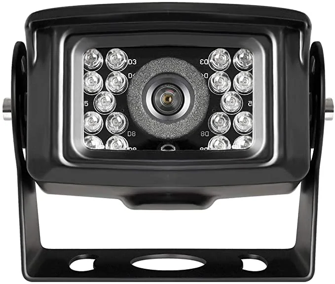

Objective:
Display "always-on" video through the "all-new" F150's 12.3" center-stack screen from a camera installed on the back of a Trailer or 5th-wheel.
Ford F-150 Lightning Customer-Installed Aftermarket Trailer Camera 61ebylVPLTL._AC_SX679_
Considerations:​
  • We need a good view directly behind the trailer, day or night, rain or shine .
  • Since the interior rear-view mirror is useless when pulling a trailer, a camera on the back of the trailer will be a substitute.
  • Wireless would be best, but running wire from the rear of the trailer to the hitch area could be an option.
  • The "rear-view" should be visible optionally at all times, at all speeds, whether in forward or reverse gear.
  • Adding an "extra" monitor to the cab is not a good option (whether mounted on the dash or interior mirror); Likewise, viewing the rear facing trailer camera with a portable phone is not viable, IMHO.

This TFL video has a ford rep explain all the camera tech in the superduty (that is now in the new F150). She explains why the rear camera is wired (for reliability).
I have not figured out whether it can be used to see if someone is up your a$$ on the freeway but I would love that. No video I have watched has said it that I'm aware. BUT I have seen mention that the BED camera is useable at speed so you can monitor your load, so perhaps the AUX camera is as well?

I've been researching trying to be able to toggle cameras while in motion for F150 2021. I am optioned for the Camera 360 which also seems to come with the wiring for behind the trailer camera that can be bought/installed.
Unfortunately, there isn't any FORSCAN optioning for this yet...still too new. But in previous model years there were two companies, NavTV and Naviik, that produced an inline module that enables cameras while in motion. Nothing has been announced for 2021 models.
Its intriguing that other model cars like Honda and Tesla allow the driver to trigger all outside cameras while in motion, either by using the assigned switch or turn signals.

I have submitted a ticket to Ford for this idea. I don’t understand why I can’t view my cameras at any speed. You can if your below 5mph,
but after that the screen goes back to normal. I need to make sure that weird sound I just heard is not my hitch coming apart.

It has been part of the "ultimate tow package" from the Superduty line since 2017, so you can find videos of it already. The gen14 F150 is just getting this tech waterfalled from there.
This is the short Ford video:
And here is some dude choosing to route the cable under his trailer chassis:
And this ford rep showing the 360 camera tech to TFL:
The reason for wired is for reliability is my guess. It isn't just simple data packets exchanged, we want live streaming video on our high rez screen and to guarantee that on longer trailers you'd want a powerful signal (like 11n MCS0) even though we'd want a higher Mbps for better video.
Your trailer is most likely pre-wired for a Furrion backup camera right? I have never gotten mine because I don't want ANOTHER thing crowding my dash area. I also want it in the Sync4 AUX camera but I will absolutely hate that long ass cable. Le sigh....
