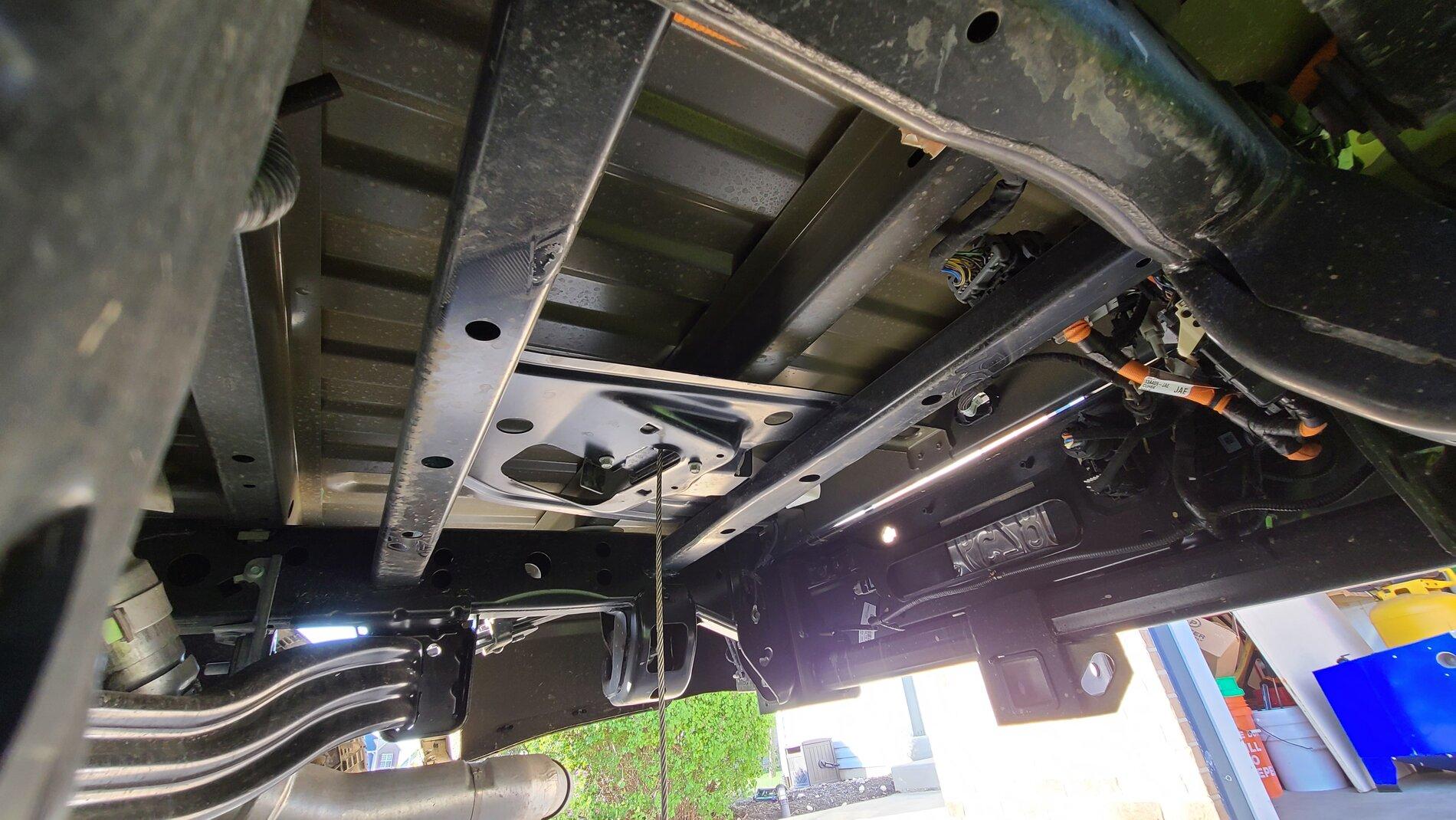

I dropped my spare today to see if I could find an unused harness, or connectors without all the wires on one side, etc, and couldn't find anything.
Ford F-150 Lightning Yaw sensor AND trailer camera together? 20210501_174258
Ford F-150 Lightning Yaw sensor AND trailer camera together? 20210501_174312
Ford F-150 Lightning Yaw sensor AND trailer camera together? 20210501_174328

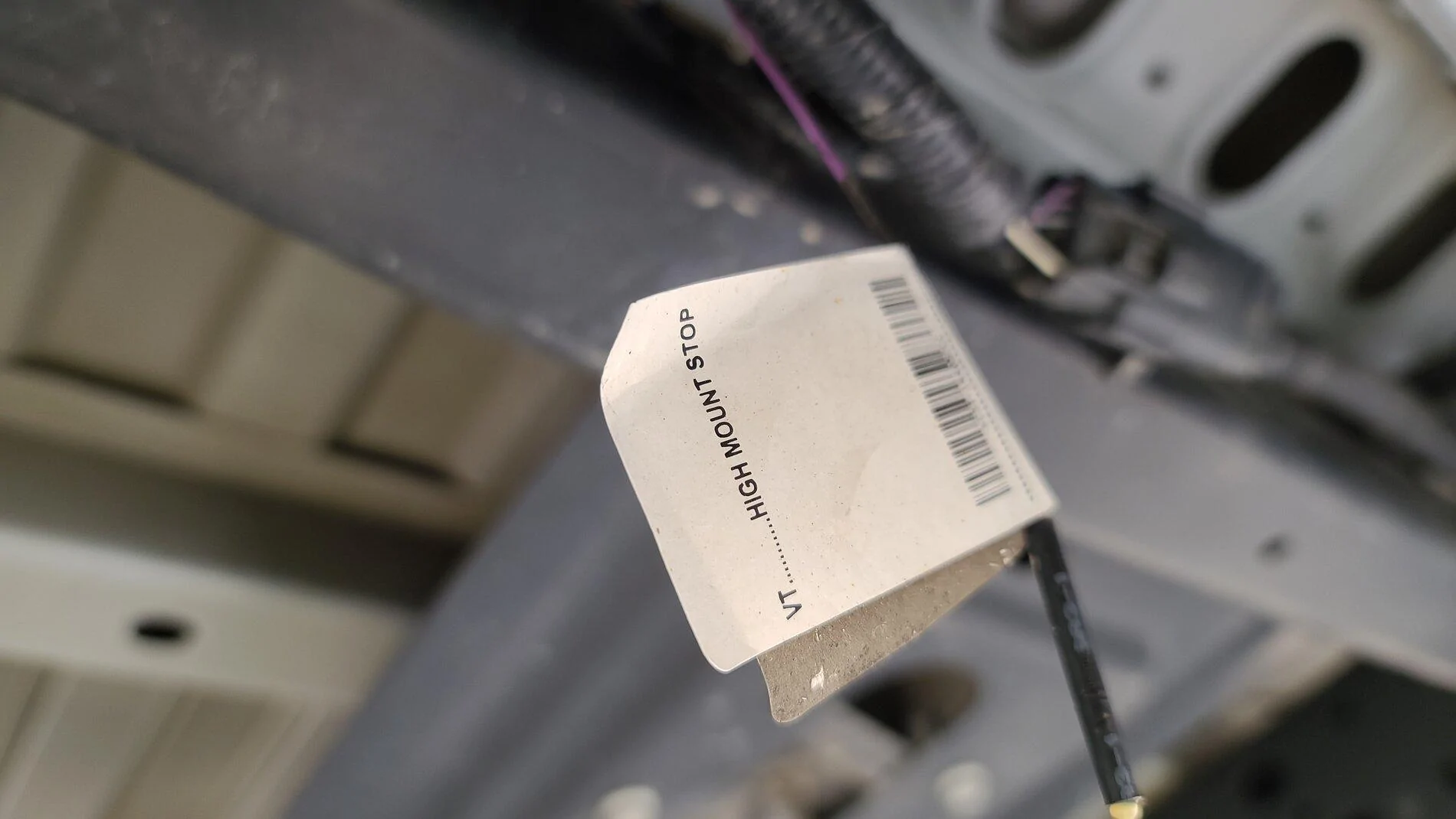

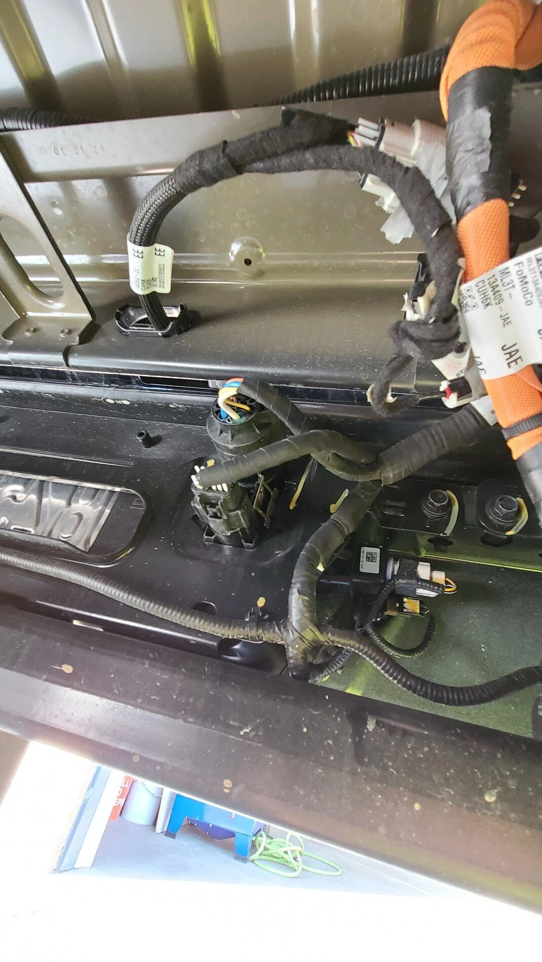

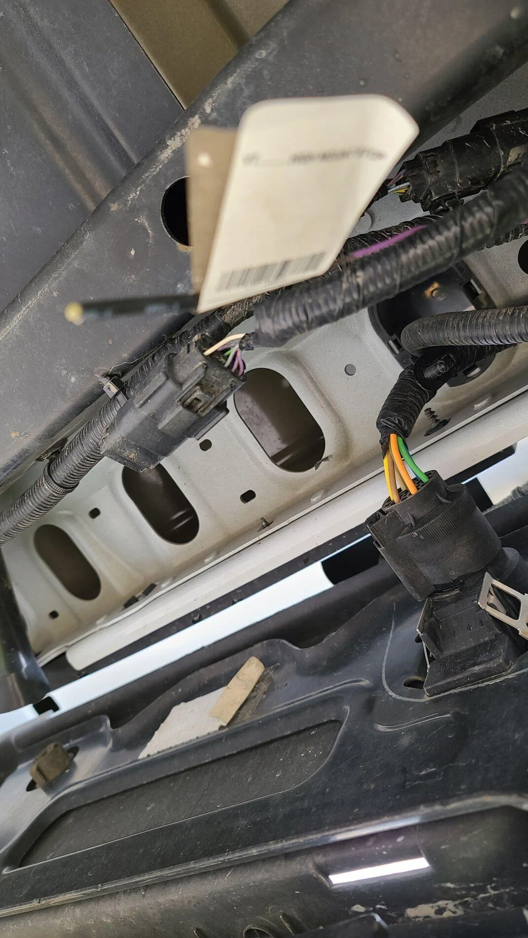

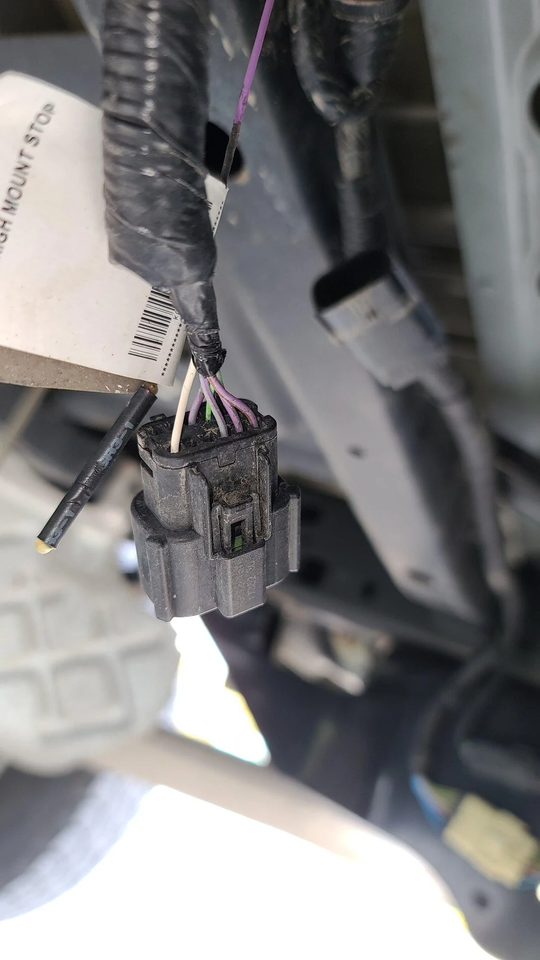

Unfortunately, it looks like we got the short end of the stick on this. Here is the plug for the trailer mounted camera and TPMS setup on the F250 super duty equipped with the ultimate tow camera package. There are 7 wires populated on the connector, with an extra wire dangling next to it. Versus our 2 wire populated plugs. Very disappointing.
Ford F-150 Lightning Yaw sensor AND trailer camera together? 20210510_054305
Ford F-150 Lightning Yaw sensor AND trailer camera together? 20210510_054311
Ford F-150 Lightning Yaw sensor AND trailer camera together? 20210510_111231
Ford F-150 Lightning Yaw sensor AND trailer camera together? 20210510_111239
Ford F-150 Lightning Yaw sensor AND trailer camera together? 20210510_111310
That was my conclusion from the superduty video I linked above. The superduty kit is not compatible because we only have power/ground populated to our connectors. The new F150 system is either fully wireless modules using private BLE/15.4 CAN bus bridges, or they really really f**ked up badly and overpromised.
I'm still betting it has migrated to a wireless solution and they are short parts due to massive semiconductor shortages.
