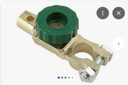

It has come to my attention a solution is in the works, while we wait, there things to consider which have already been pointed out:
  1. Change the audio input source
  2. Pull the Audio fuse
  3. Shut off & evacuate the truck, close the door and wait ~5 minutes to sleep mode.
  4. Disconnect the 12v battery.
Consider a quick disconnect like this.
