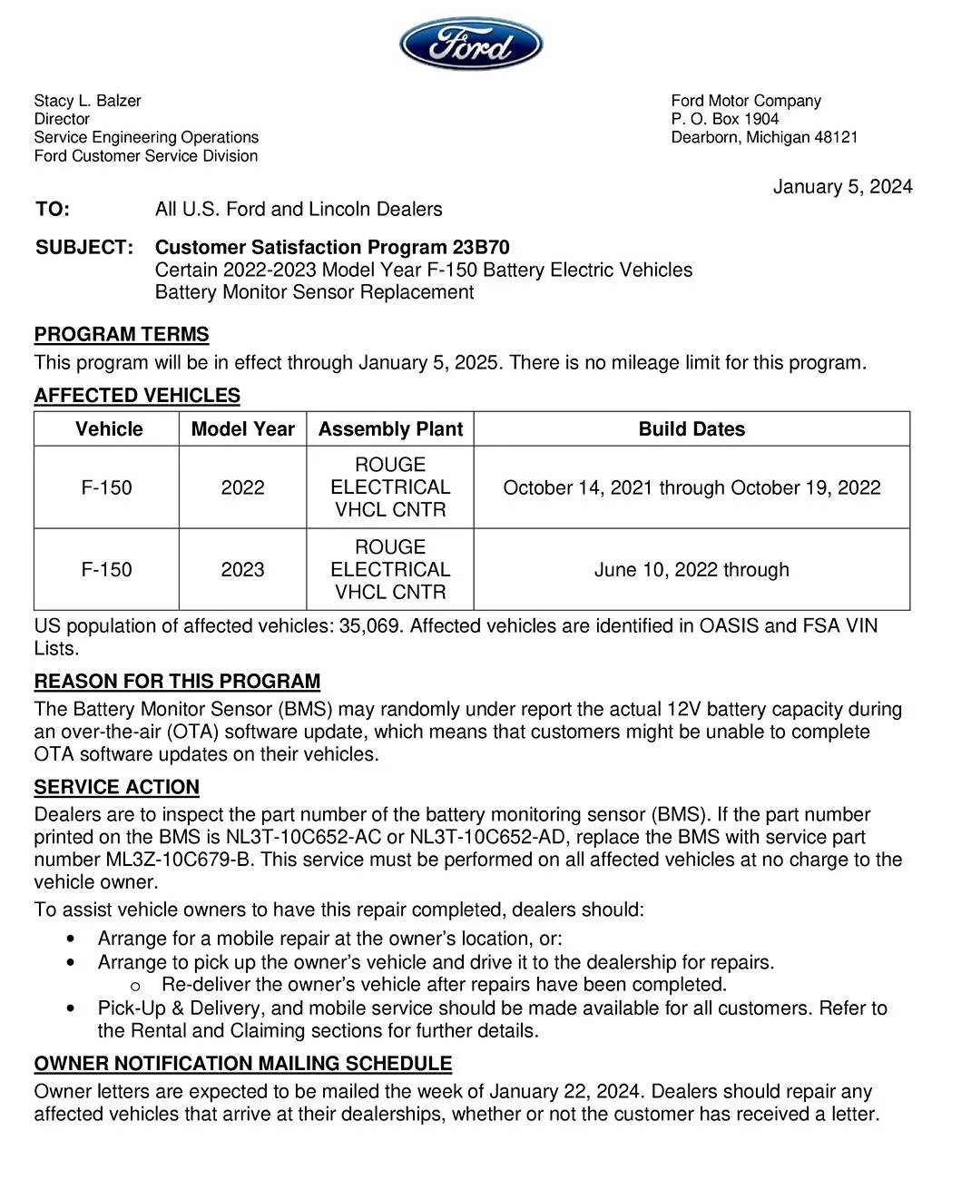

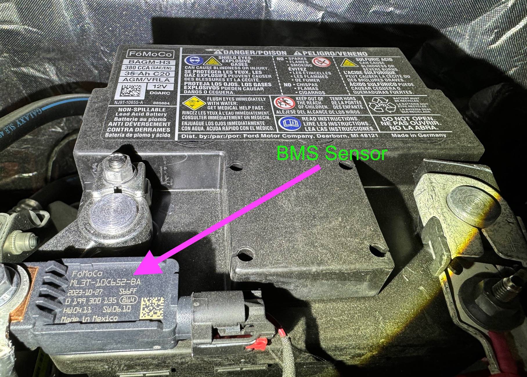

What year is your truck? There was CSP 23B70 to replace the BMS sensor on the 12V battery for some 2022 and 2023s. I get the messages much less frequently after they replaced that. Perhaps they did that CSP when it was in the shop?

Take a look at your BMS sensor on the 12v battery. It should have a date on it.
Can't recall the version # or the dates that were replaced, but if it is after October 2023 it should be good.
Itā€˜s not the date. If the Part number suffix is -AC or -AD, it must be replaced.
My truck was built in August/Sept 2023 and arrived in my town mid October.

You may be in the range. Best to check your BMS Sensor part number as @Maquis stated.
Here is a page from the recall notice.
