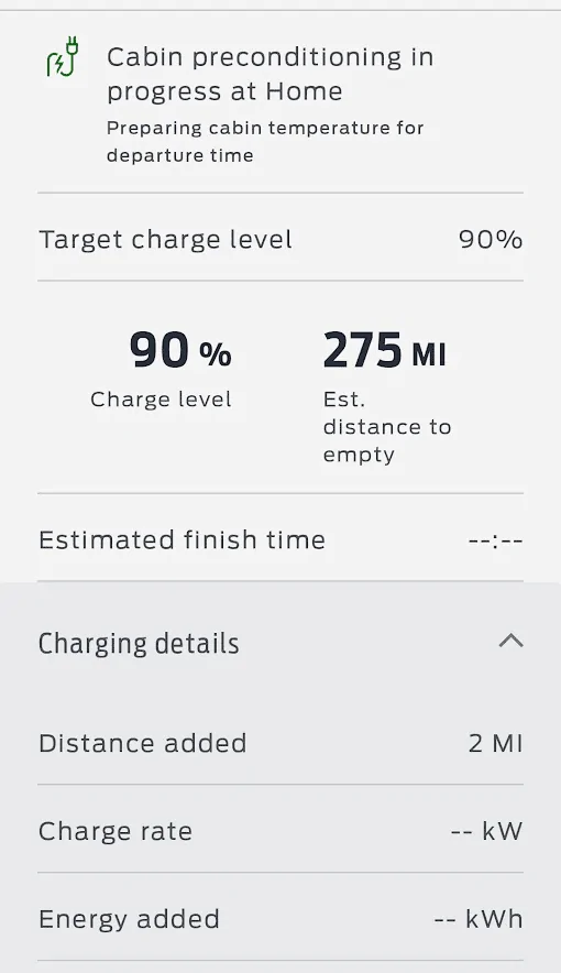

Fordpass Status-----------------

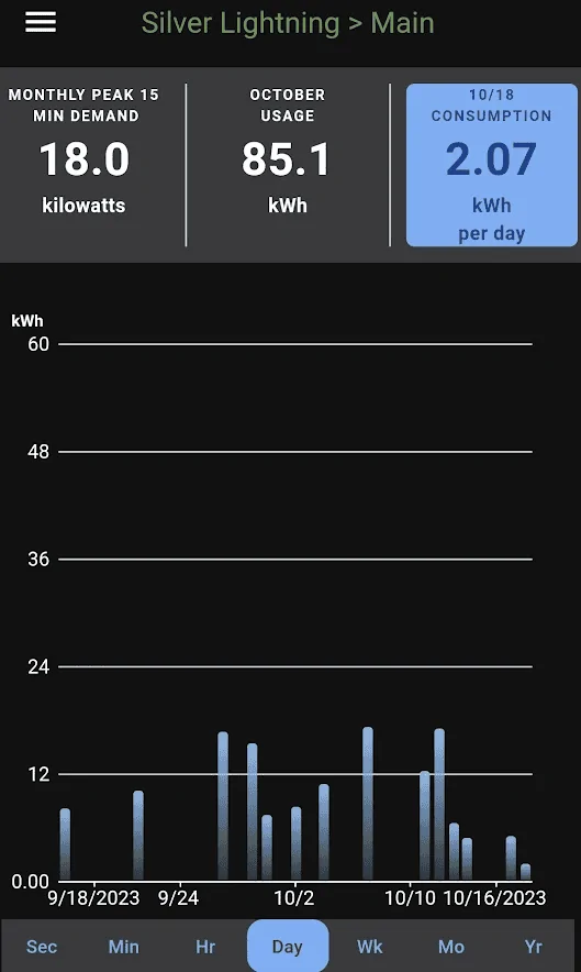

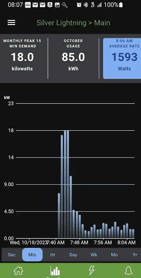

Emporia measured start 0741 for 0800 departure
Snap shot is 0806 just before I unplugged @0808
Total energy 2.07 kWh or 53 cents to warm up.
{4 miles of range conserved from the battery}
