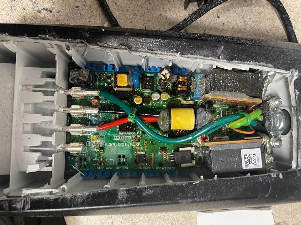

Nice.
I'd suggest you consider getting an inexpensive L2 EVSE instead of using the Mobile Power Cord all the time.
There have been any number of posts on the various Lightning forums of failures of the MPC, including some meltdowns with smoke and near fires.
They are made by Webasto and sold on Amazon, for example, as the "Webasto Go" Mobile Charger.
If you read the reviews there you will see some posts about failures.
They appear to be heat related.
It has been reported that they are covered by the Ford 3 year warranty when they fail.
If you search the forum you should see the posts about failures.
There are decent L2 EVSEs for under $500 that can charge faster as well if you are wired for it at your house/garage.
This is the inside of one that failed and the owner cut open to examine.

Thanks for the post. My electrician put in a 50 Amp circuit for the mobile charger. Iā€™ll definitely monitor it for sure. Iā€™ve used it for 5 months without issue. Most are short charges between 60 to 80%.

Yes watch out! One post I saw was from someone who used it exclusively for about 2 years before it failed.
In that case, the failure was a slow down in charge rate, as if it was charging at L1 and not L2.
He took it to the dealer and they reproduced the issue so they gave him a new one.
Time and heat are the enemies - the effects of heating up components and connections during charging then cooling down afterwards takes a toll over time. So the longer/more often it is used, the more the cumulative stress.

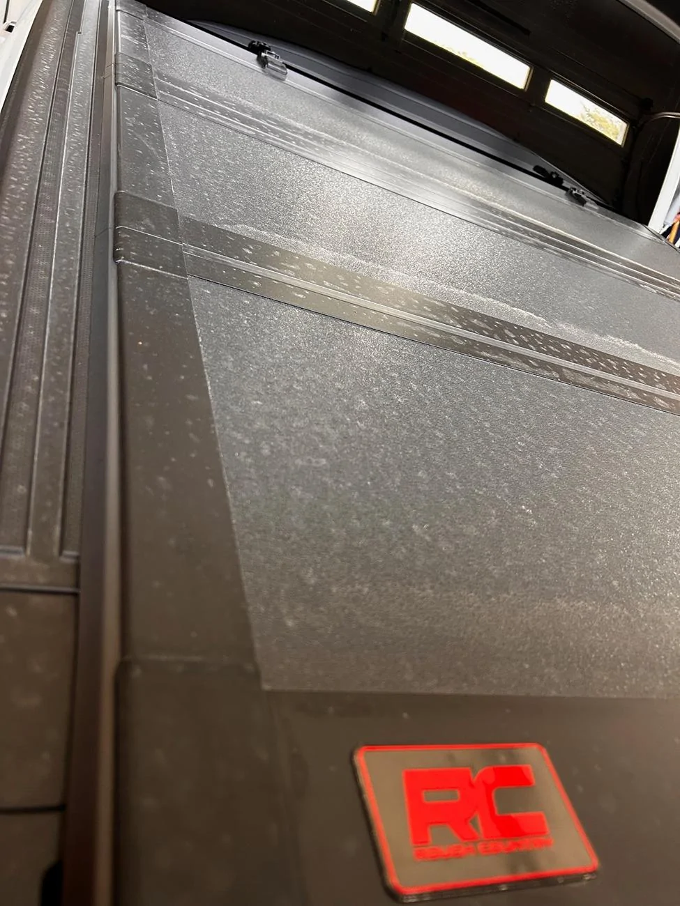

Rough Country Tonneau Cover: https://www.roughcountry.com/product/ford-hard-tri-fold-bed-cover-49221550

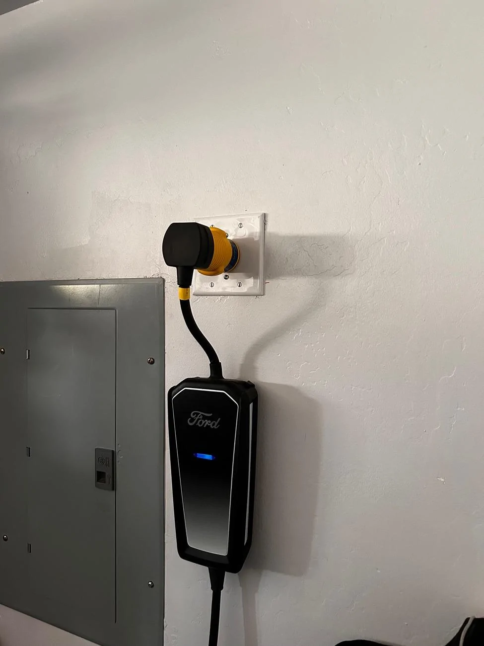

Charging at the Home with Mobile Charger: Overall very happy with that. I was going to install the Ford Charging Station Pro, but decided not to do that b/c electric company said I needed an extra meter to put that in. Still have it and may end up selling it. I am really satisfied with charging with the Mobile Charger.

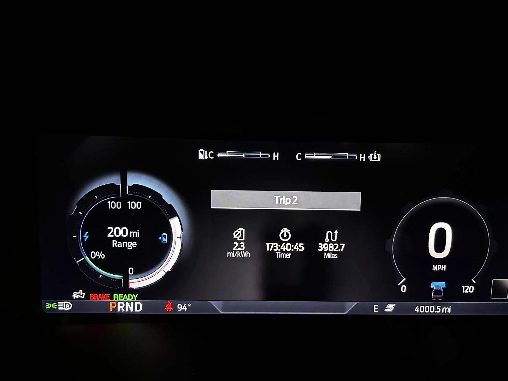

Averaging 2.3 mi/kw so far with all my travels including the trip home from Rio Rancho in 30 degree weather. Also, had another trip of about 170 miles to the lake where I had really bad headwinds and averaged about 1.6 mi/kw all the way home.

For the range in colder weather, as noted on several hundred posts here, Did you use cabin heat or just Seat warmers? The cabin heat has a large effect on range. Good thing you live in TX where it's cold 15% of the year.
For the charge station pro - you should be able to install it on a smaller circuit an not need a separate meter. Use a 30A or 50A or 70A breaker and set the max charge rate in the charger to 20% less than your breaker. I'm ignorant to your local codes and utility needs and your homes electrical equipment so take my input with that in mind.
NOTE: the cable on the charge station pro is annoying because it has the DC contact points and you have to lower the DC flap before you can plug in . If you use this charger, look at replacing the cable if you have no plans to back feed DC to your house.

Thanks for the info on the charger. Iā€™ll check that out for sure. I used the cabin heat on the trip. Iā€™ll try seat warmers next time. We do get some cold mornings in the winter.
