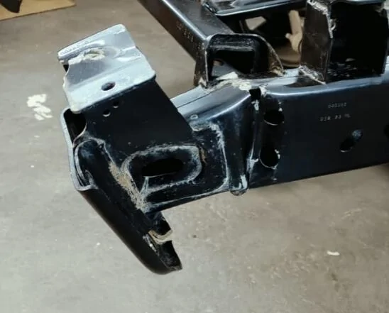

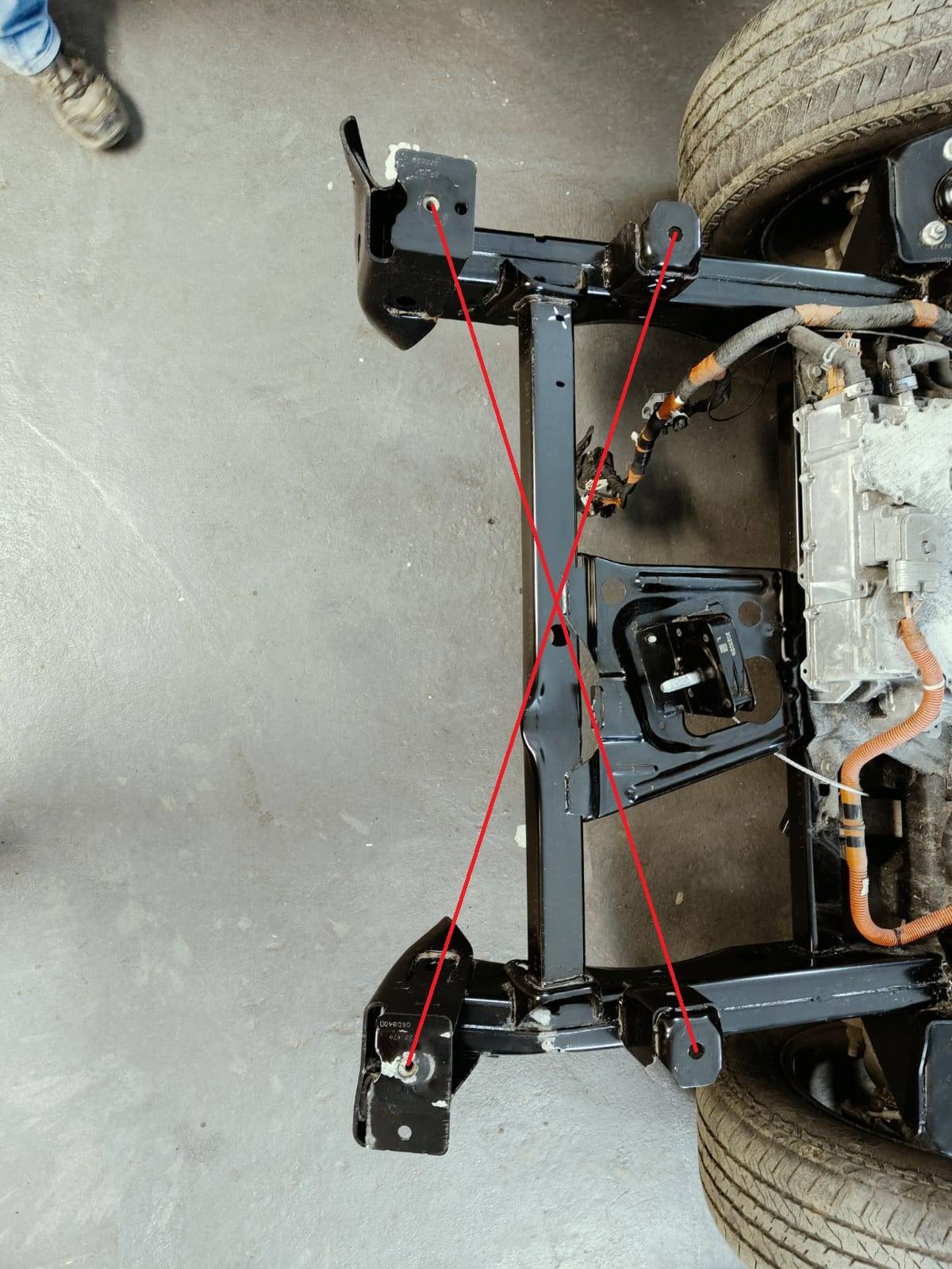

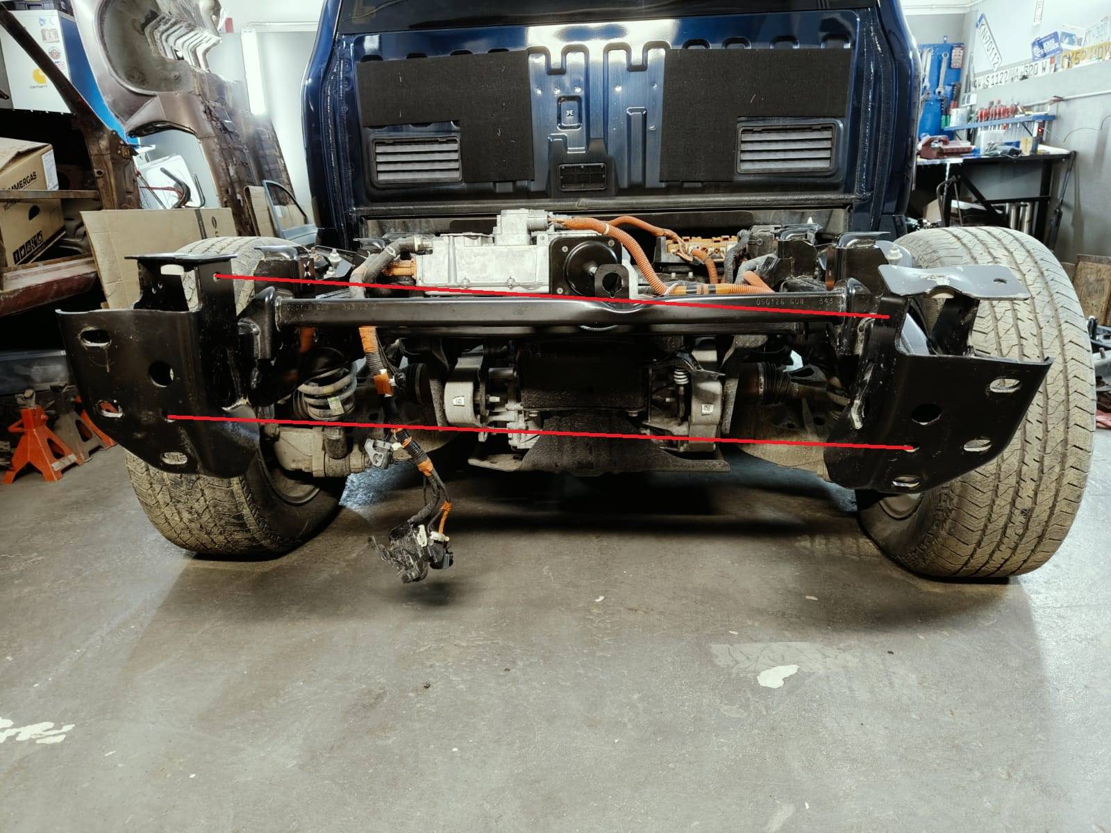

I have a lightning after a small collision, can someone measure the dimensions between these points for me? Or is there some document with these dimensions?

You don't say what got damaged - it looks like the right side rear of truck.

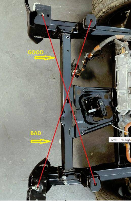

In your bottom photo, the two lines should be equal. Looks like the bottom left frame is bent at the very rear. So the line that goes top left to bottom right should be "good".
I would think again, assuming the damage is on the right side rear of truck, you can measure height on the left as "good".

I need to fix the right rear frame of my car

Well, not seeing it in person, I would venture to say that both segments should be identical . . .
