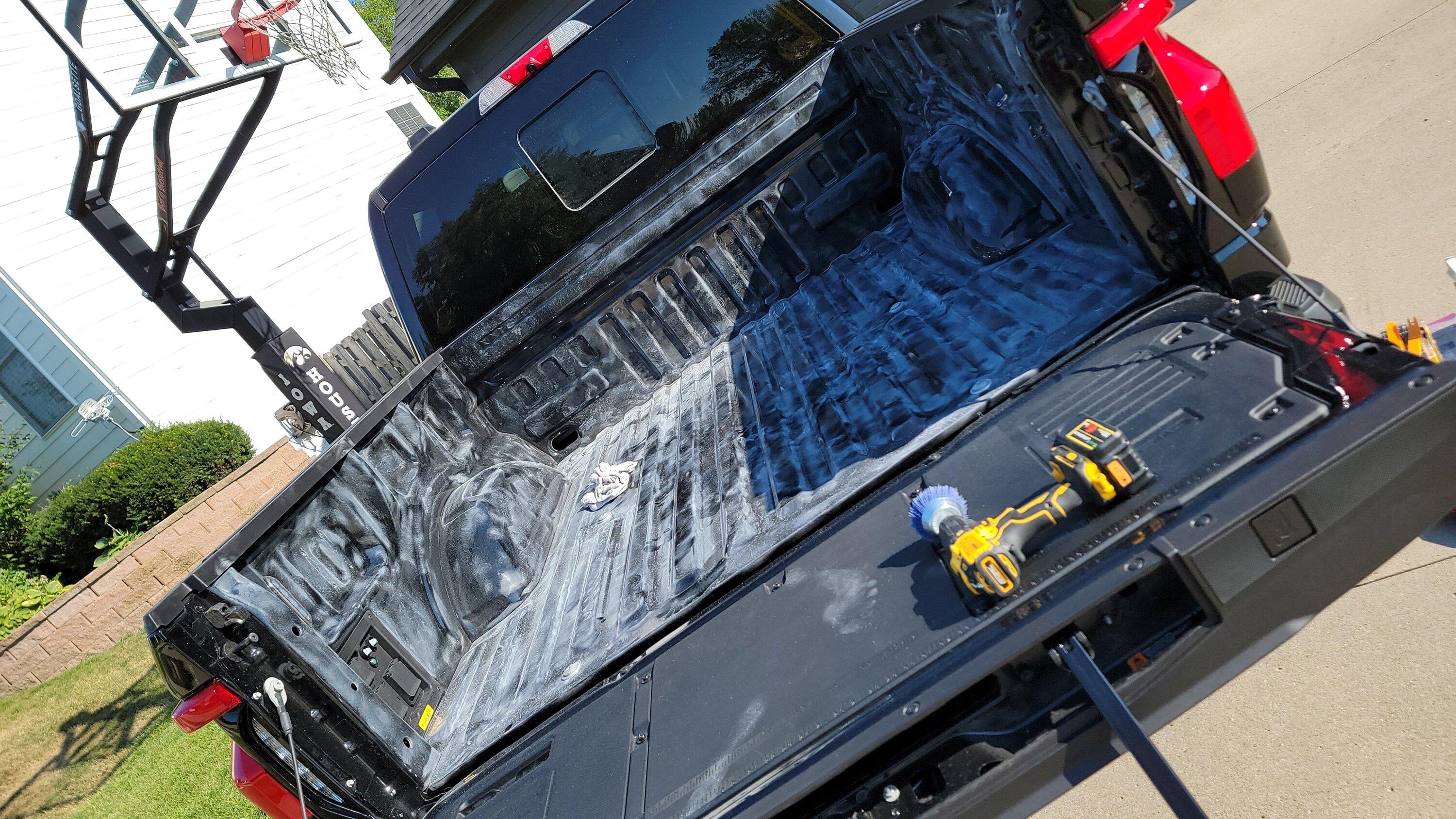

Sanding felt very weird, being that the truck is brand new, but I basically used a drill with the cup brush going over every surface that I planned to have covered in the liner. It was around this point that I had to start making decisions on where exactly I wanted my lines to be.
Ford F-150 Lightning DIY Bed Liner (U-POL Raptor Black) BL (1)
I was flipping back and forth on what I wanted to do with the tailgate, since it has the big plastic piece, but as I mentioned, I did end up taking this off and lining around it. I left the tailgate on for the whole process because I didn't want to jack with messing anything up regarding the power lift tailgate.
After sanding, I once again got out the degreaser (I was using Simply Green) and the garden hose to get all the dust cleaned out. It was still sunny and hot so this was drying up pretty fast.

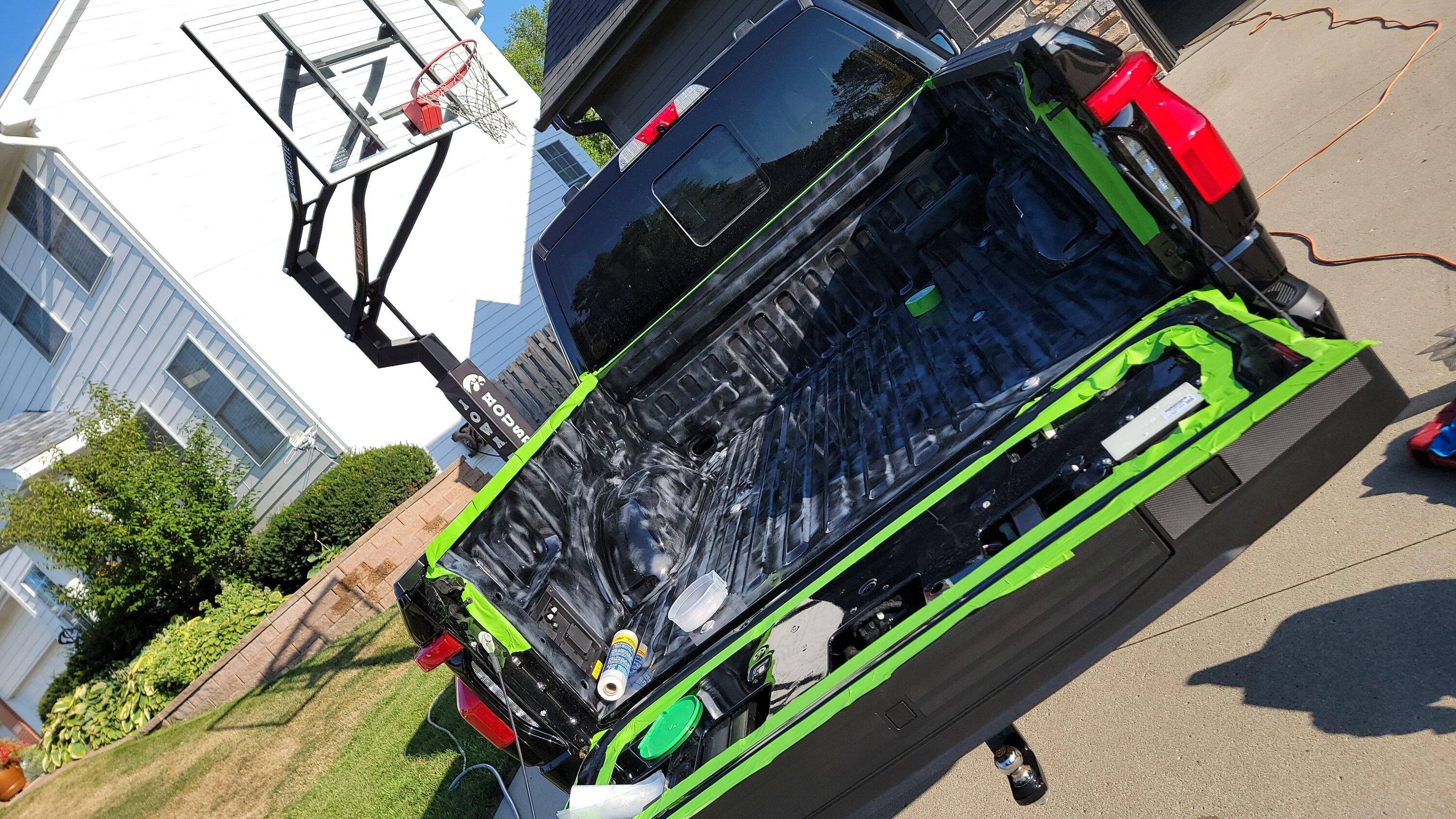

Next, I got out the Frog tape and started getting my lines where I wanted them. Around the top, I basically followed the plastic trim. I left the top rail against the window as paint for future bed cover potential. On the tailgate, I basically ringed the area where the plate will be, avoiding the latch type areas.
I masked off the power center, the lights, the front holes, and put tape in all of the bolt holes. I also flip flopped on whether to mask the bed bolts or not, but ultimately decided to cover them with liner.
You'll note I didn't mention masking off the light switch, because I forgot, which was my main F up of the process, I'll get to this in a bit.
After I was happy with all the lines, I came back around with the pretaped plastic, and just followed the green lines slightly back. Thankfully it wasn't windy.

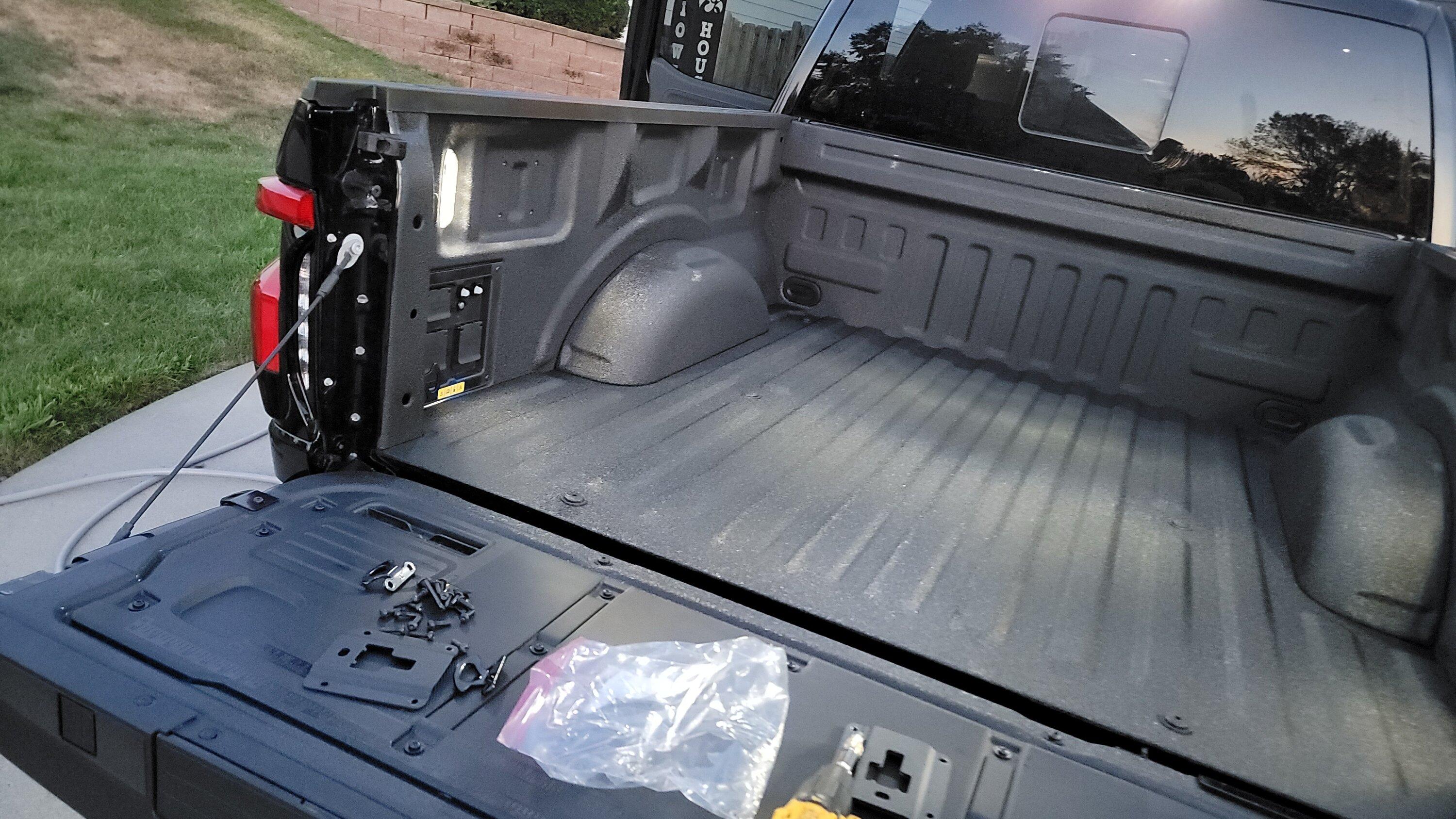

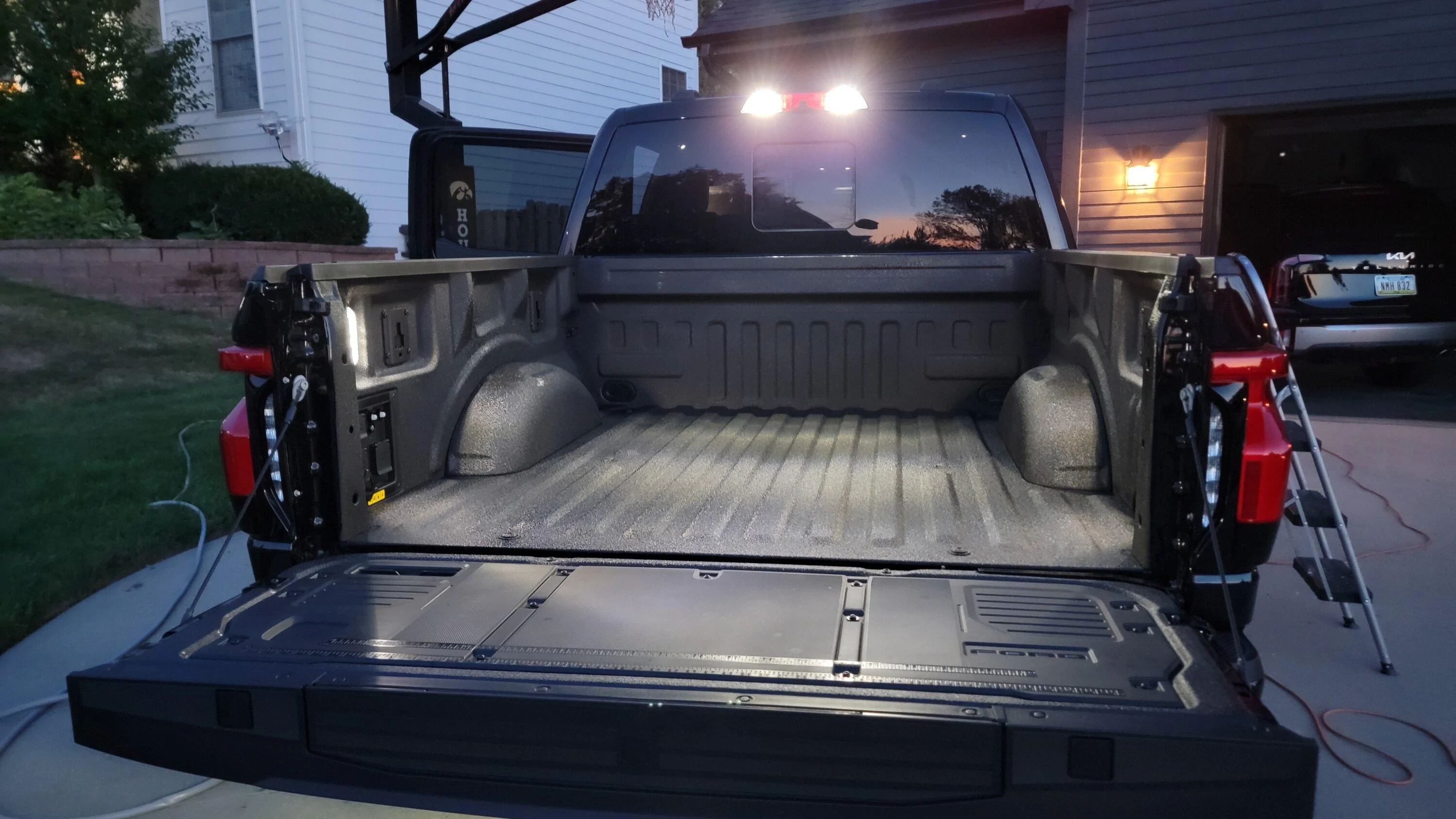

It was starting to get firm to the touch by the time I put most of the gear away, so I slapped all the hardware back on and took some pictures.

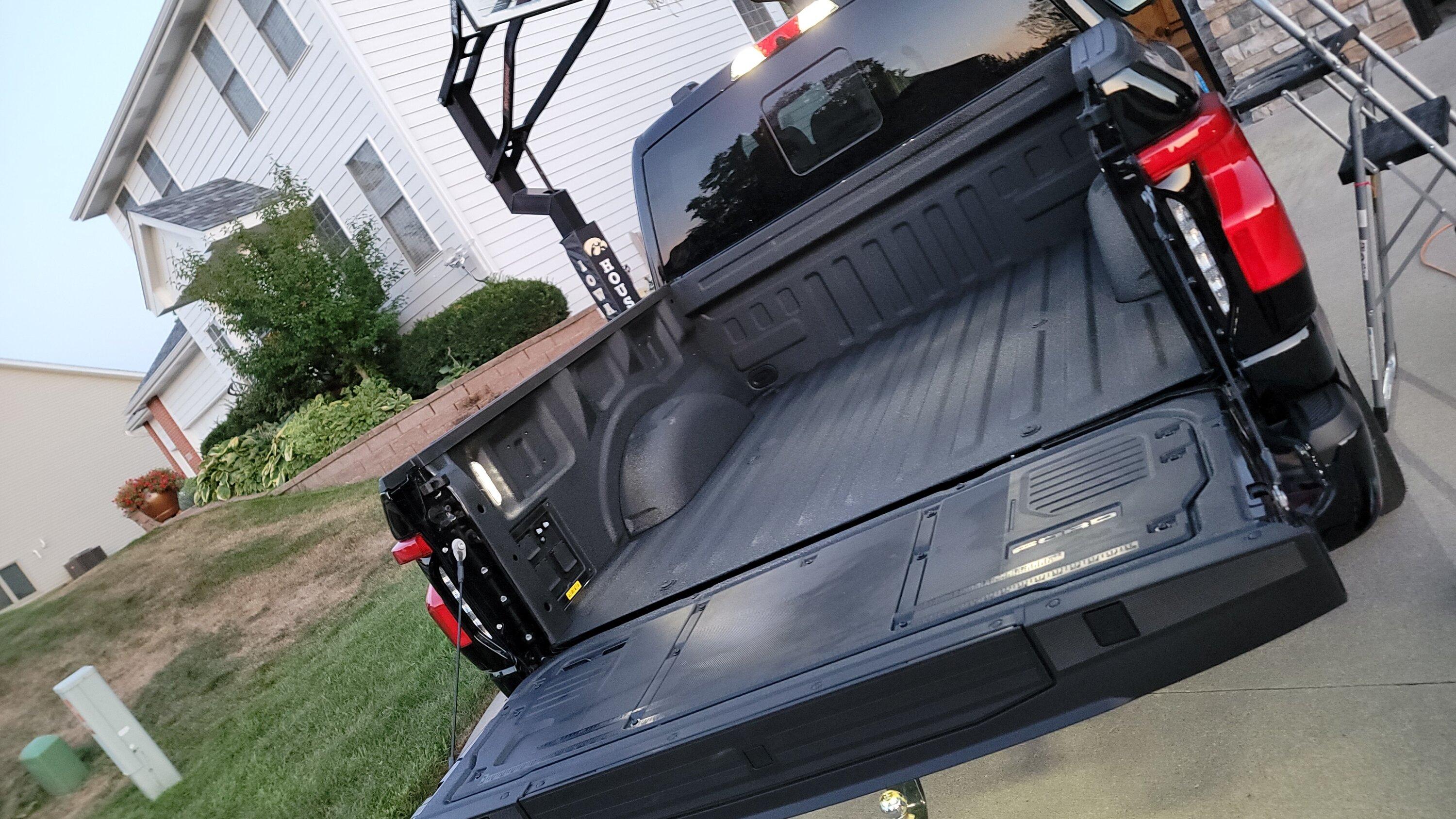

Total time was about 4.5 hours with a meal break and 0 experience spraying anything ever. I'm typing this the next morning and I'd say it came out great! If you look closely, you might be able to identify where the gun dropped out an unexpected blob.
Ford F-150 Lightning DIY Bed Liner (U-POL Raptor Black) BL (5)
Ford F-150 Lightning DIY Bed Liner (U-POL Raptor Black) BL (3)
Ford F-150 Lightning DIY Bed Liner (U-POL Raptor Black) BL (2)

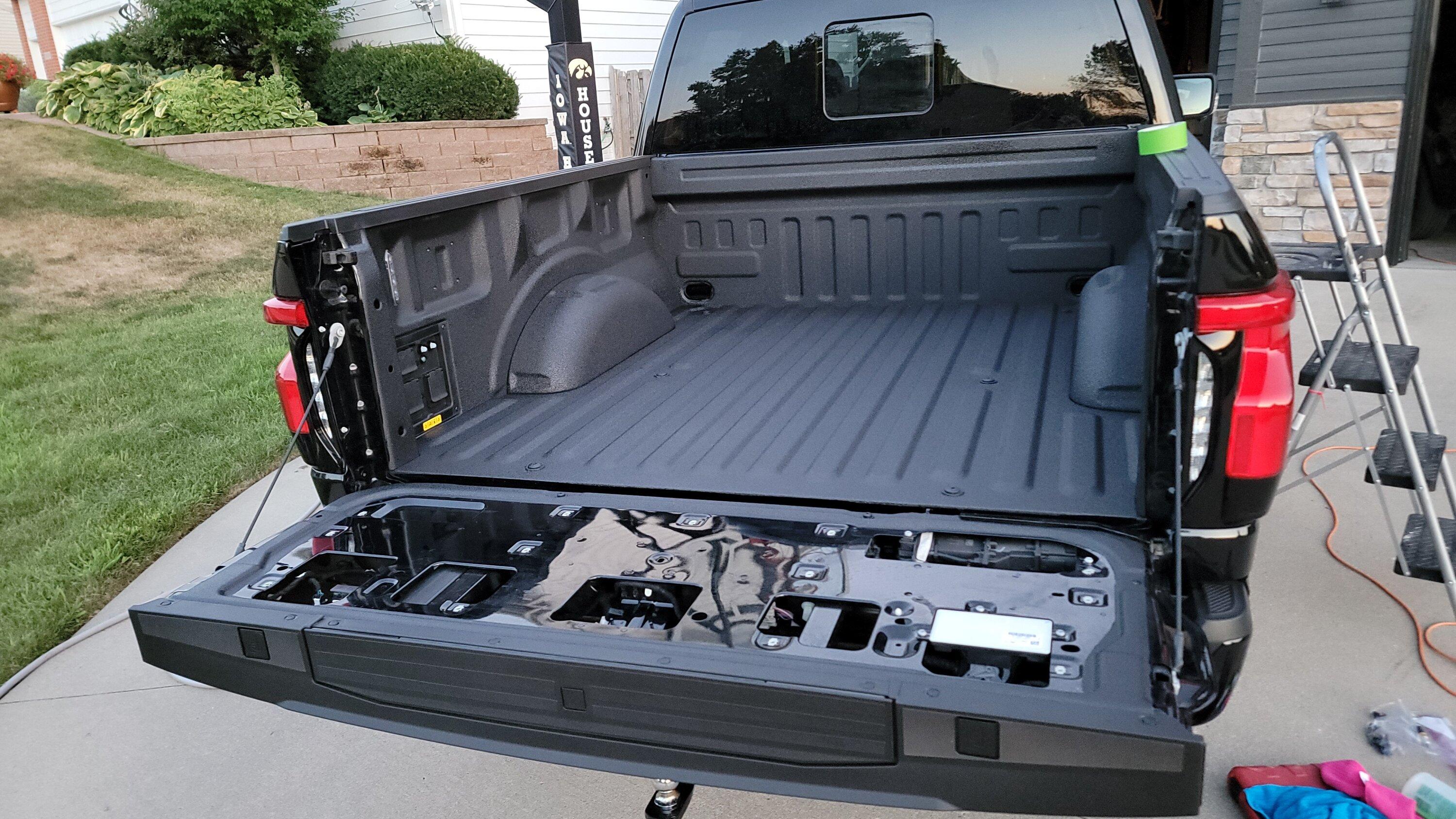

Next morning
Ford F-150 Lightning DIY Bed Liner (U-POL Raptor Black) BL (6)
