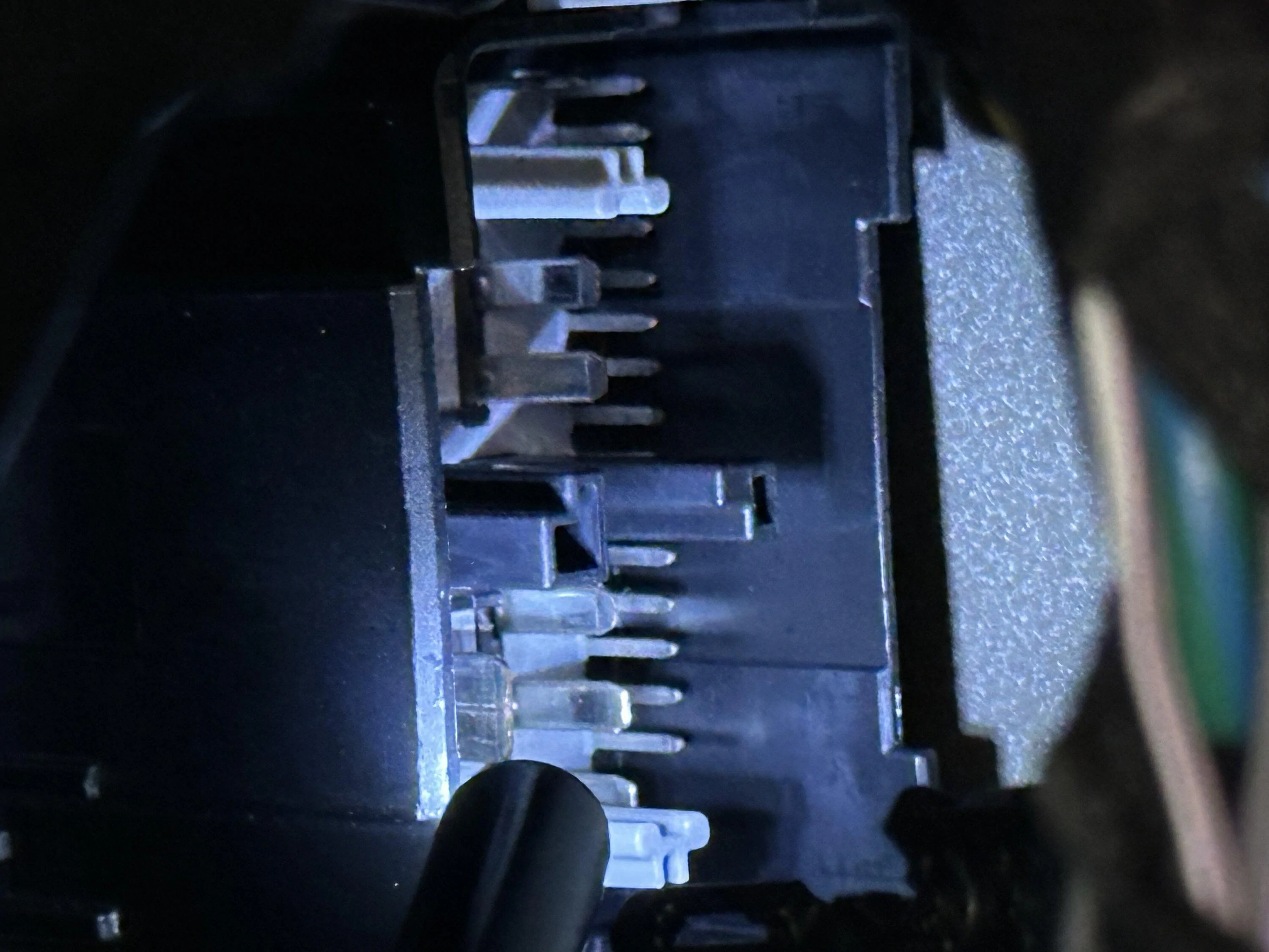

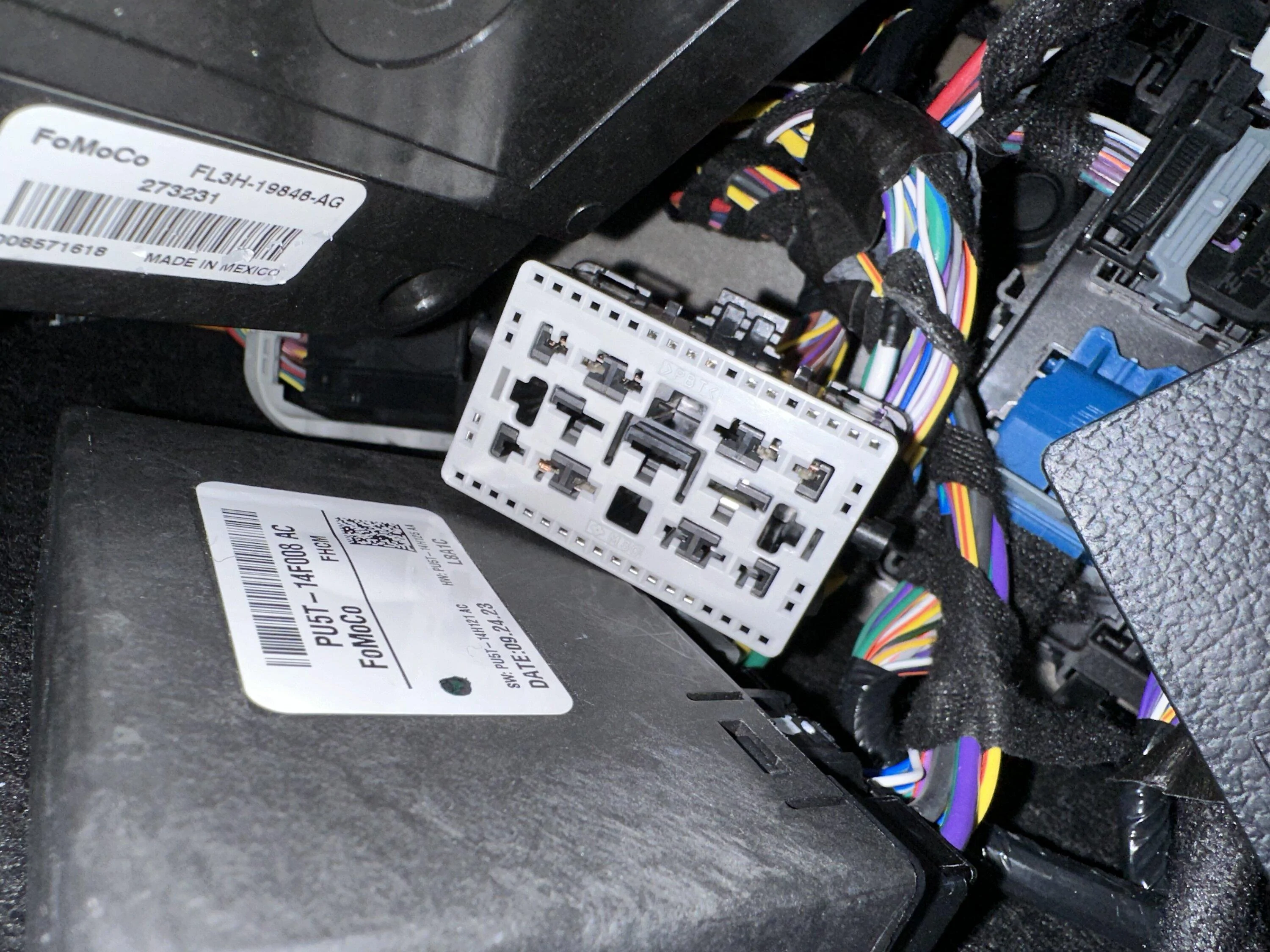

To the point of using a borescope, you might as well just unmate that connector and look at the pin locations in the one heading up from the bottom, you will be able to see easily if the male pins exist or not in the right spots. The front bumper side of C265 is the male side.
Finally got back in there and unseated the connector without breaking it!
Do we know if the pins are there that the wires are there to the bumper? The connector seems to be fully populated with male pins despite the female side lacking many wires. Certainly they could have wired for additional devices that I don’t have…

Find the wires on the female side you have easy access to. Then symmetrically look for the corresponding males up under the dash, if they are there just put it back together, your good. If not, pull out the female pins to use WAGO splices on to extend your own harness
