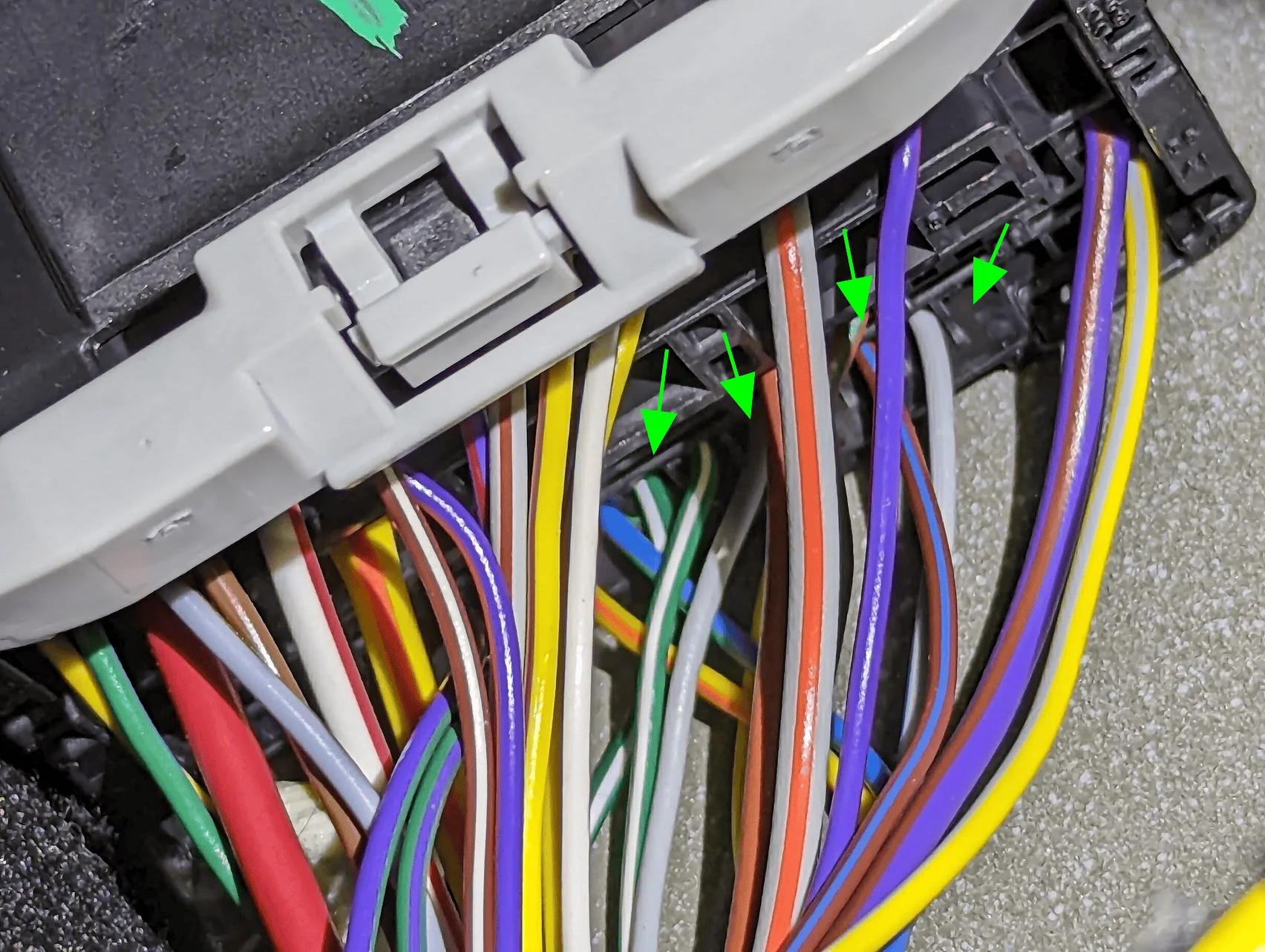

Thanks! I missed this post and was about to take the plunge and was considering making a similar writeup.
One thing I haven't fully done was fully verify the passenger wires. I think I see all of them but not 100% sure, is this picture clear enough to see them?

yes, looks like you have the required wires...
