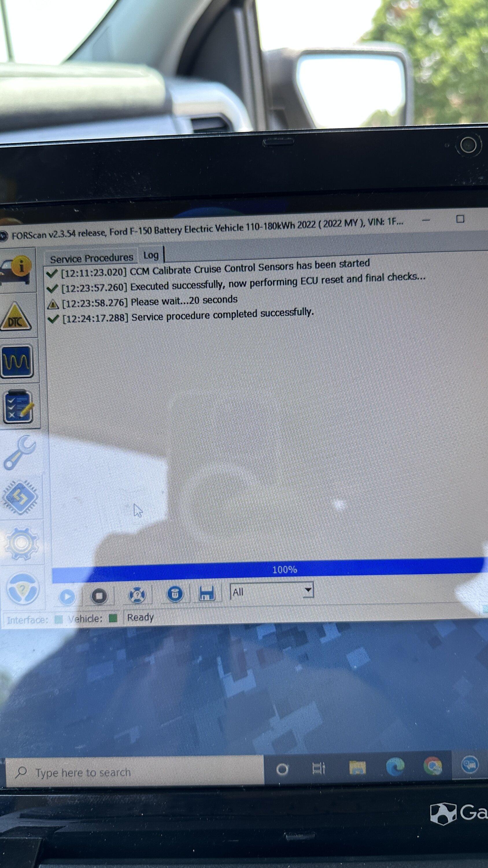

I started this morning at 7am, and had the truck operational with the additions at 12pm lunchtime. I took the last programming steps, while running around 45 to 60 for a few miles, without the bumper, and other un-needed parts, until I knew it was a success.

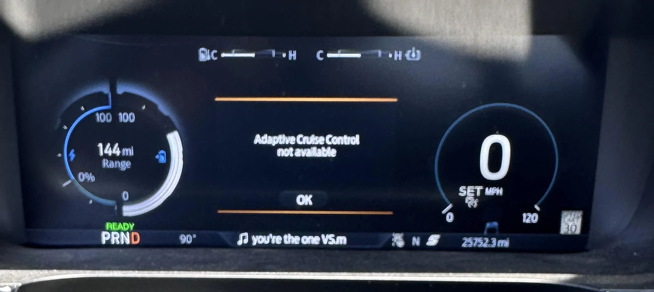

this is the first screen AFTER programming, but not yet 'operational'...
Ford F-150 Lightning DIY success: installing Pro Adaptive Cruise and Lane Centering (and frunk beeper) not yet operational

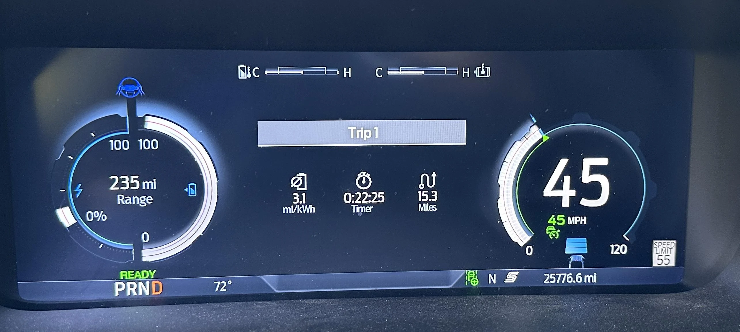

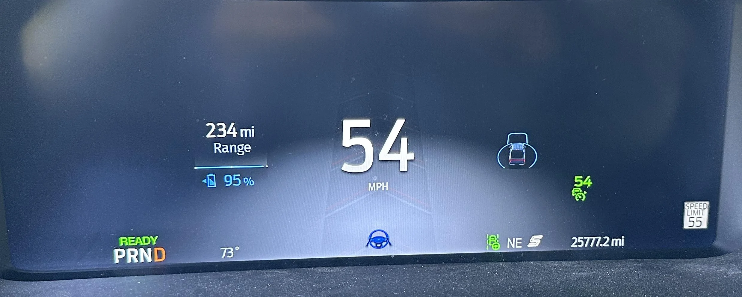

once the truck has time to 'rest', and possibly 'update', you can now Activate the ACC with the push of the Cruise button: The bottom right corner 'vehicle' icon indicates the ACC is active, with the 'default' 3rd level Following Distance, and the top Left 'steering wheel' icon shows that the system has found the lane and is now 'steering' for you... SPEED SIGN reading is also active.
Ford F-150 Lightning DIY success: installing Pro Adaptive Cruise and Lane Centering (and frunk beeper) 1 operational with FOLLOWING DISTANCE indicator
the bottom right original 'Lane Assist' icon now has the 'steering wheel' added, meaning that Lane CENTERING is now part of the activation.
Ford F-150 Lightning DIY success: installing Pro Adaptive Cruise and Lane Centering (and frunk beeper) 2 system working with SPEED SIGN Indicator

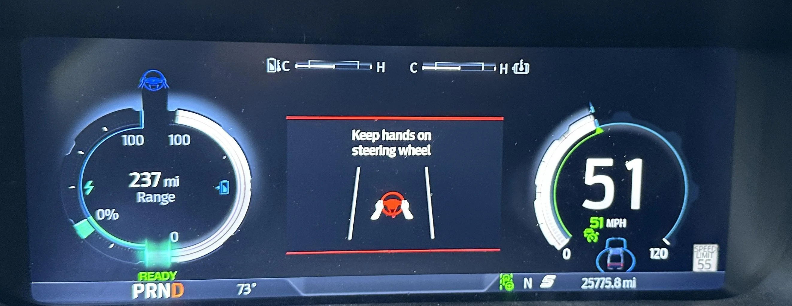

the FIRST warning, to grab the wheel, or at least 'move' it ever so slightly to let it know you are 'still alive'... this probably is happening much more than I would like, every 10 seconds or so, but, it's still a great joy to have the option! It DOES keep the lane well, so no worries there...
Ford F-150 Lightning DIY success: installing Pro Adaptive Cruise and Lane Centering (and frunk beeper) 3 first warnin

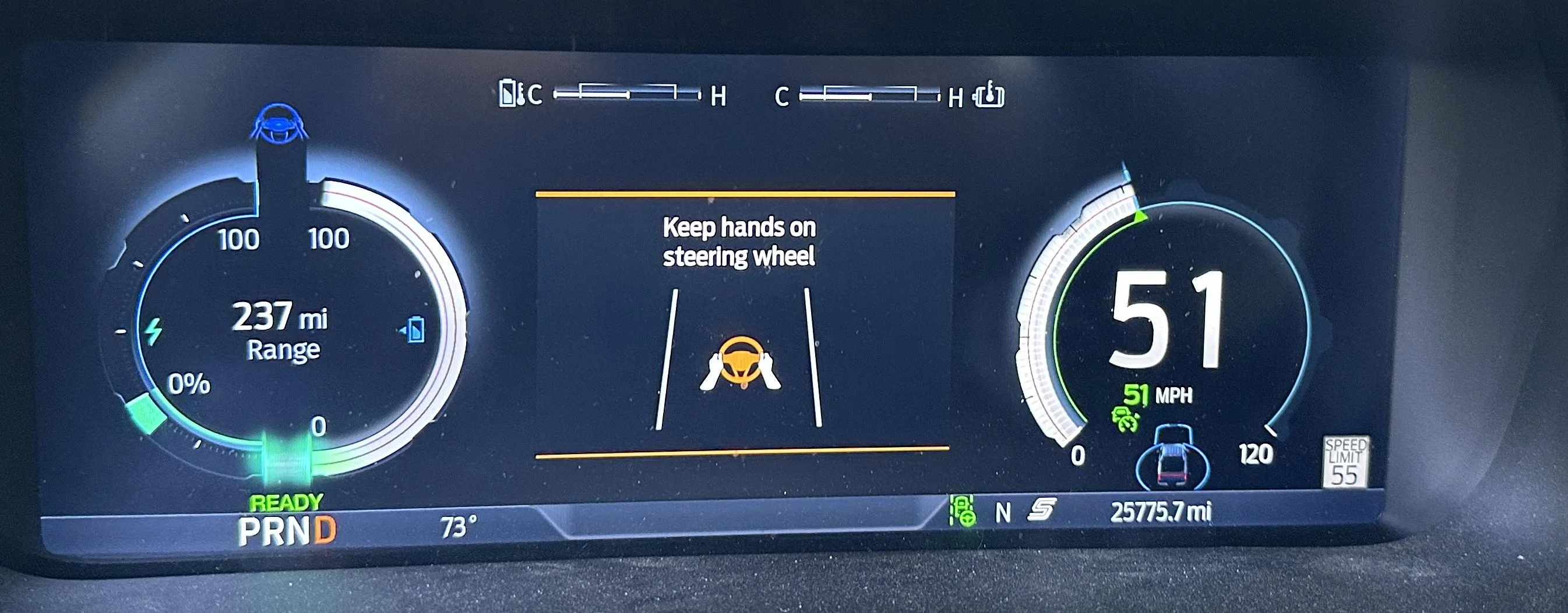

the SECOND warning, with audible BEEPING, and no Stereo or Radio allowed...
Ford F-150 Lightning DIY success: installing Pro Adaptive Cruise and Lane Centering (and frunk beeper) 4 second warnin

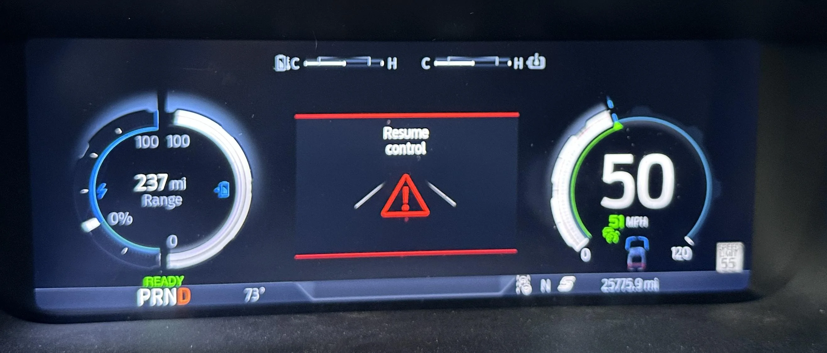

the FINAL warning, when the system will then DEACTIVE Cruise and you will immediately start to slow, although Lane ASSIST will still be active... a push of the pedal will REACTIVATE the Cruise, and a grab of the wheel will REACTIVE the Lane Centering.... nice.
Ford F-150 Lightning DIY success: installing Pro Adaptive Cruise and Lane Centering (and frunk beeper) 5 FINAL warnin

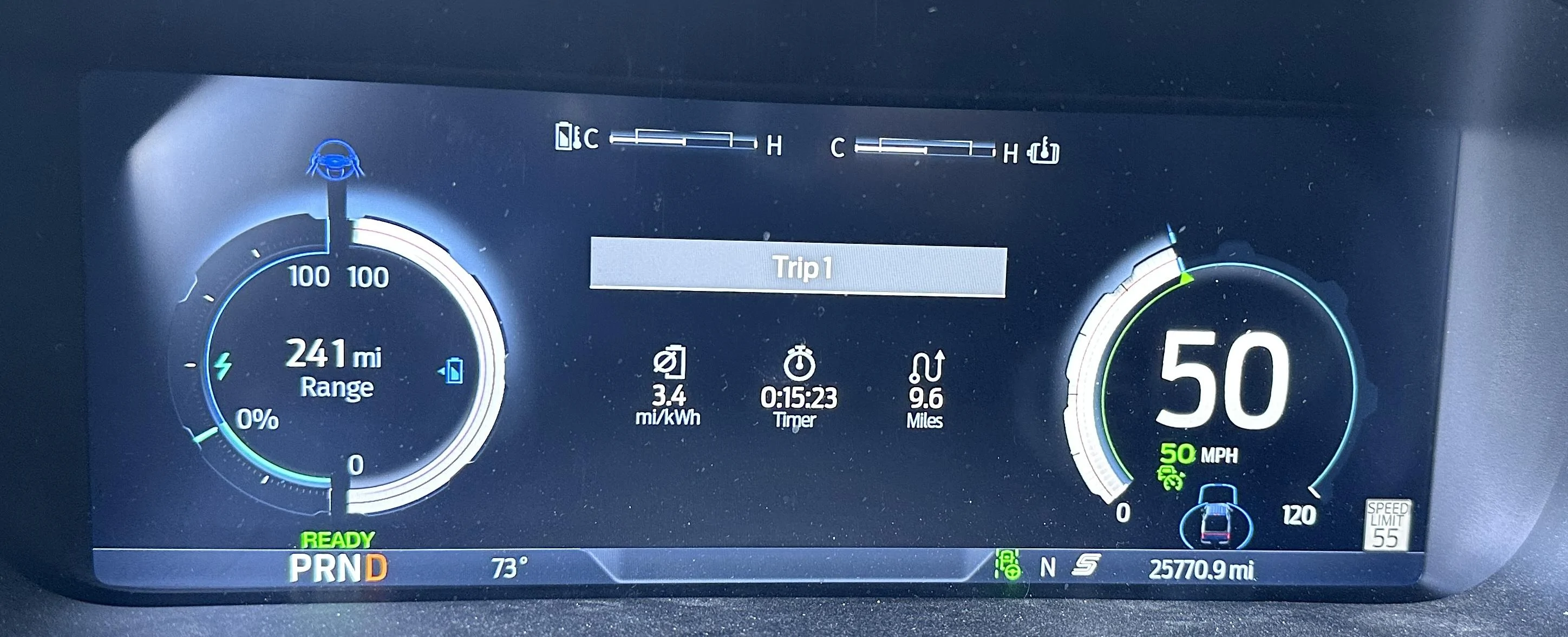

how the system looks within the CALM screen...
Ford F-150 Lightning DIY success: installing Pro Adaptive Cruise and Lane Centering (and frunk beeper) 6 operational in CALM screen mode

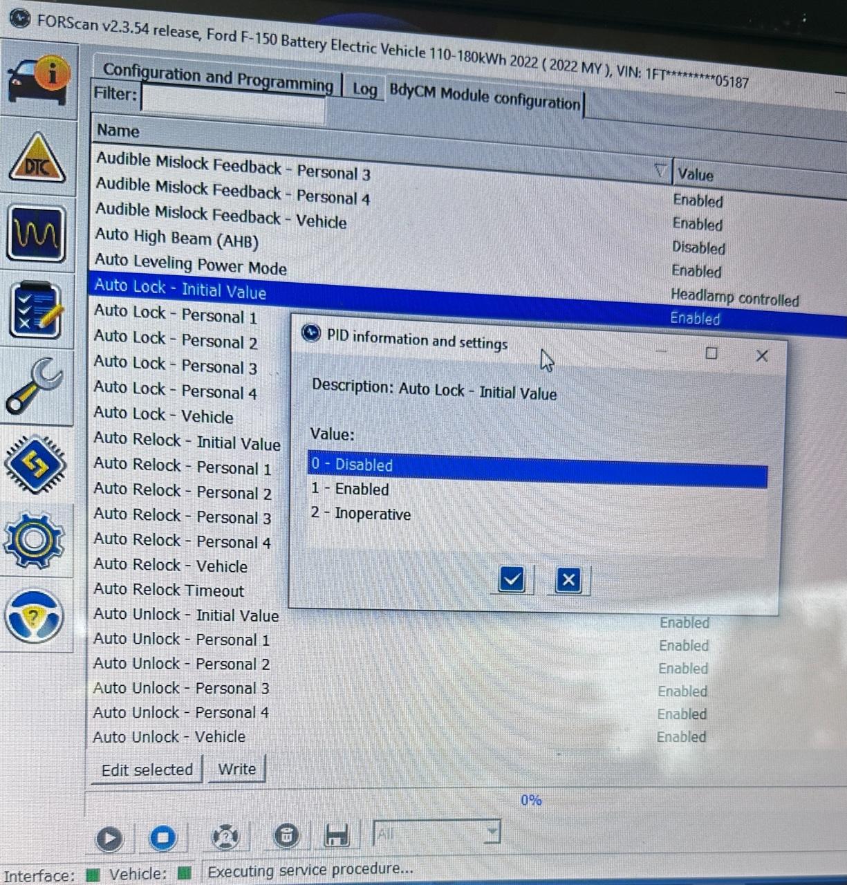

another MODIFICATION today:
I opened Forscan and shuffled through many of the Modules and their specific command functions - one that immediately caught my attention was the 'Automatic Door Locking', typically after reaching 10mph or so... aggravating for a long time, and now SOLVED! No more automatic door locking - I'll lock the doors when I get good and ready, thank you very Much! : ) Sweet.
Ford F-150 Lightning DIY success: installing Pro Adaptive Cruise and Lane Centering (and frunk beeper) BdyCM AUTO DOOR LOCK disabled
hturnerfamily
hturnerfamily
Jan 8, 2022
1,860
2,231
rural Georgia
Owner
you may have to recode not only AUTO LOCK, but also AUTO RELOCK, which is apparently the format to 'relock' the doors automatically after someone has exited, but the truck is still 'ON'... when you proceed, the truck then 'relocks' the doors automatically... I disabled ALL of these lines of code.
