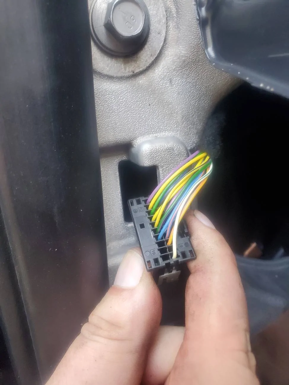

Ok so at the bumper harness connector the 4 wires are there but at my IPMA they are not.
Has anyone else run into this problem?

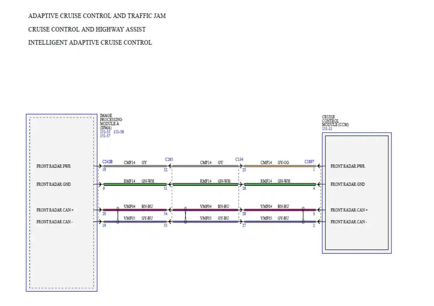

Yes, my buddies 23 XLT 311A SR was this way and we just used my old bumper harness to rob the bumper side pins and a CCM pigtail to complete everything in the front. So, if you want to utilize the outside harness OEM wires you'll have to wire from the IMPA to the driver side kick panel (C265). Everyone's truck is a bit different unfortunately thanks to FORD :(
Ford F-150 Lightning DIY: Installing ACC (Adaptive Cruise Control) and LKA (Lane Keep Alert) to 2022 F-150 Lightning XLT 1729702398450-2a
You would arguably be one of those cases to just go straight from the CCM to the IMPA and just not mess with any of the OEM wiring.

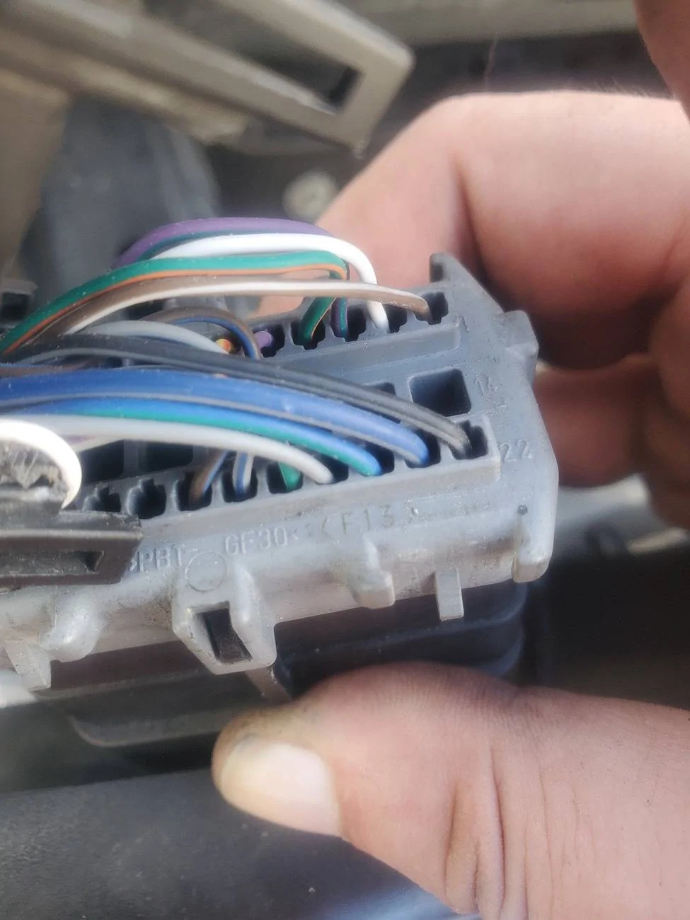

From the way you labeled your IPMA connector pins:
#1 (which is actually IPMA pin 20) goes to CCM pin 3 (CAN+ signal)
#2 (which is actually IPMA pin 19) goes to CCM pin 2 (CAN- signal)
#3 (which is actually IPMA pin 18) goes to CCM pin 1 (sensor power)
#4 (which is actually IPMA pin 9) goes to CCM pin 4 (sensor ground)
its really difficult to push the pins into the connector, is there a trick to it?
