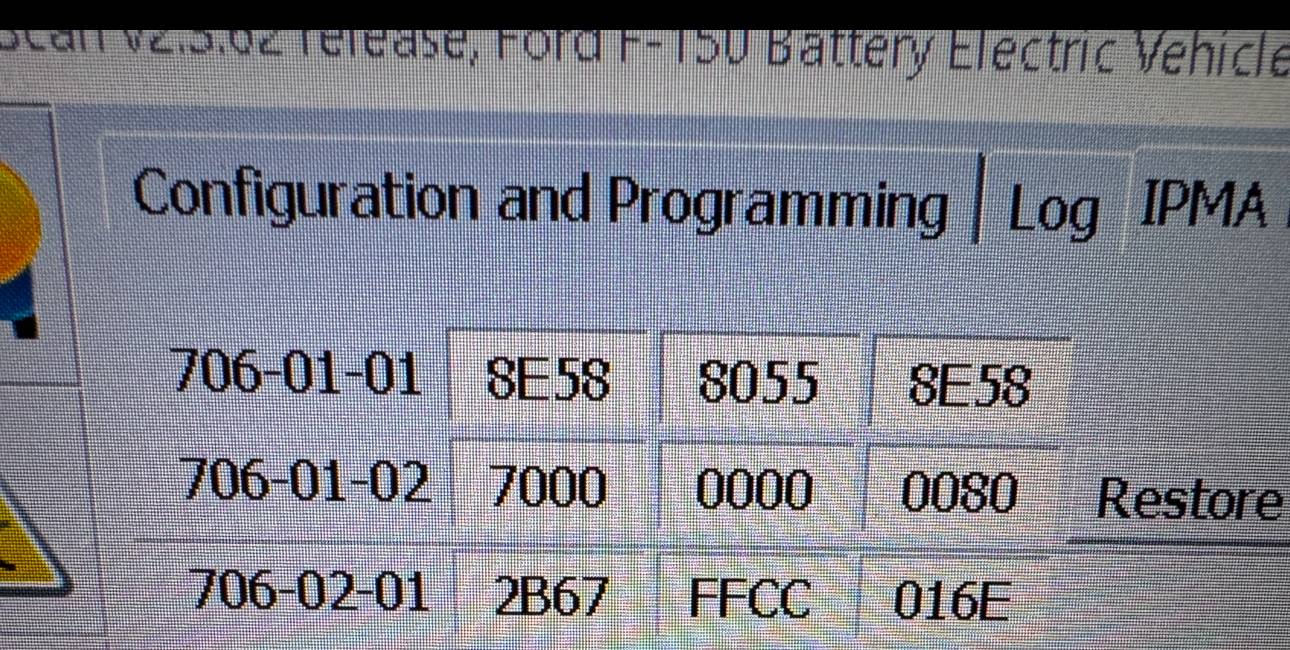

R1CH4RD
Richard
Aug 8, 2024
Hawaii
2023 F150 Lightning
Government

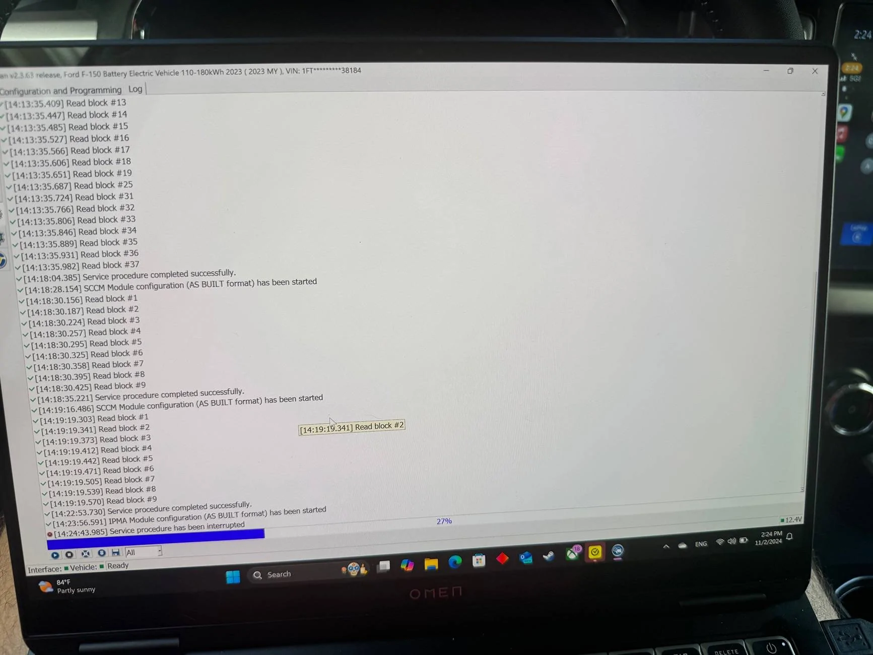

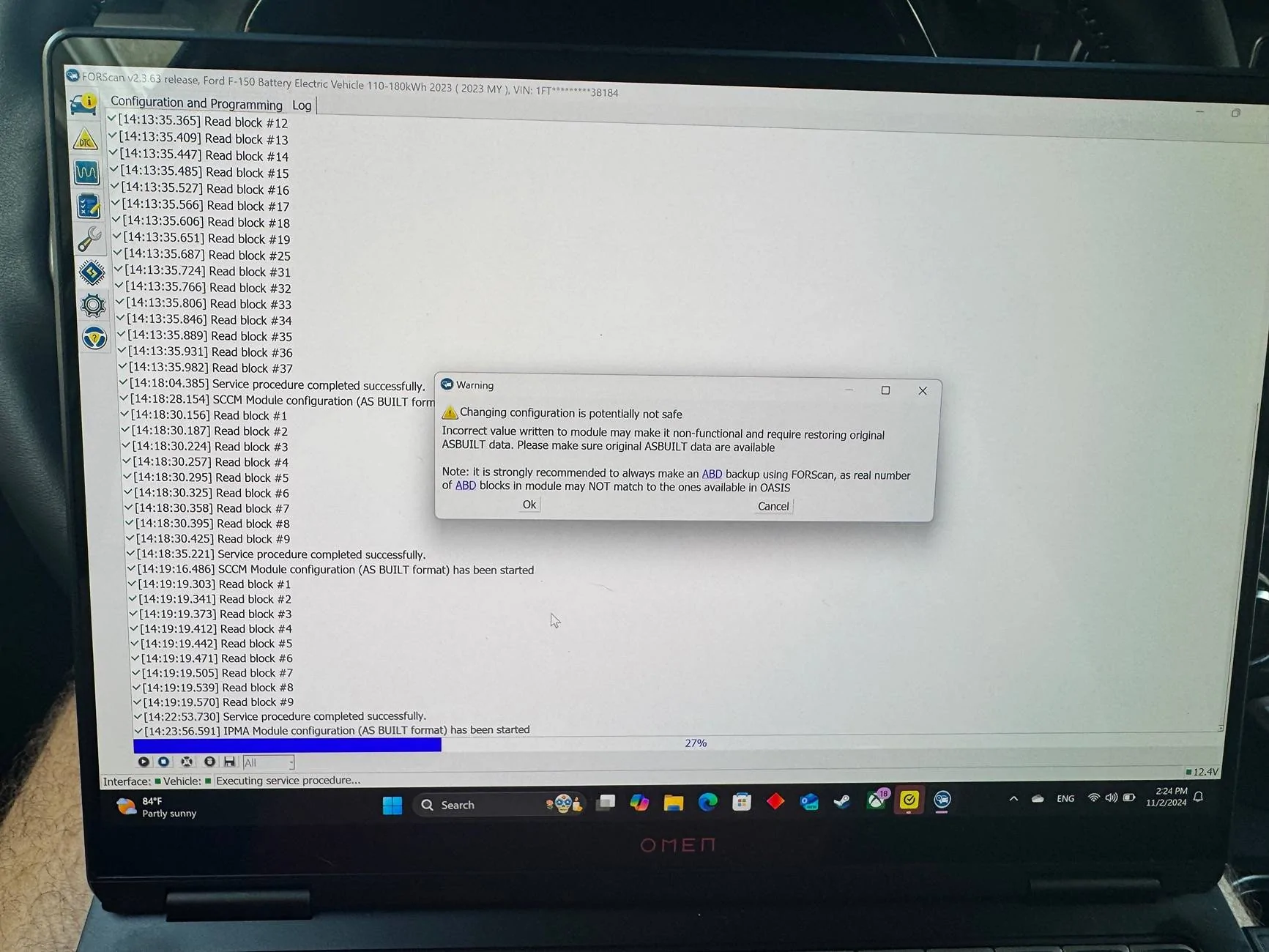

So I’m having issues getting into the IPMA module does not let me continue tell me “changing configuration is potentially not safe…” prompt (shown on picture) the service procedure has been interrupted prompt (also shown in photo) also I can’t find the CCM module part on FORScan can someone point me in the right direction
Ford F-150 Lightning DIY: Installing ACC (Adaptive Cruise Control) and LKA (Lane Keep Alert) to 2022 F-150 Lightning XLT IMG_1897
Ford F-150 Lightning DIY: Installing ACC (Adaptive Cruise Control) and LKA (Lane Keep Alert) to 2022 F-150 Lightning XLT IMG_1898
ZSC100
Zach
Mar 29, 2023
340
255
Tulsa, OK
Electrical Engineer
No finding it means it's probably not powered or hooked up correctly. You need to measure 12v at the bumper connector to verify it's on the correct pins. Use the wiring diagram and info in previous threads, several people have had this problem.

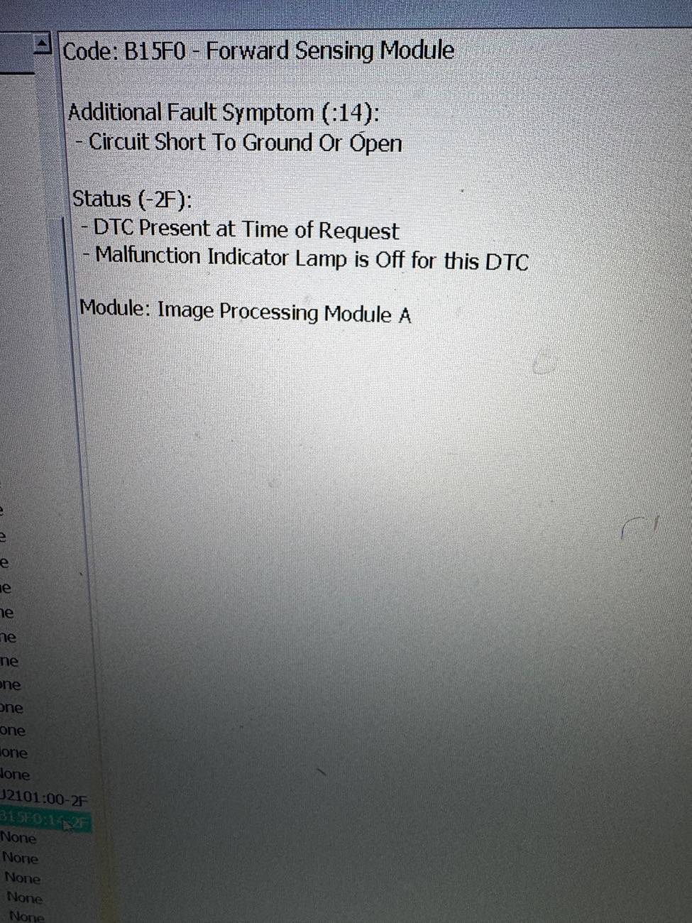

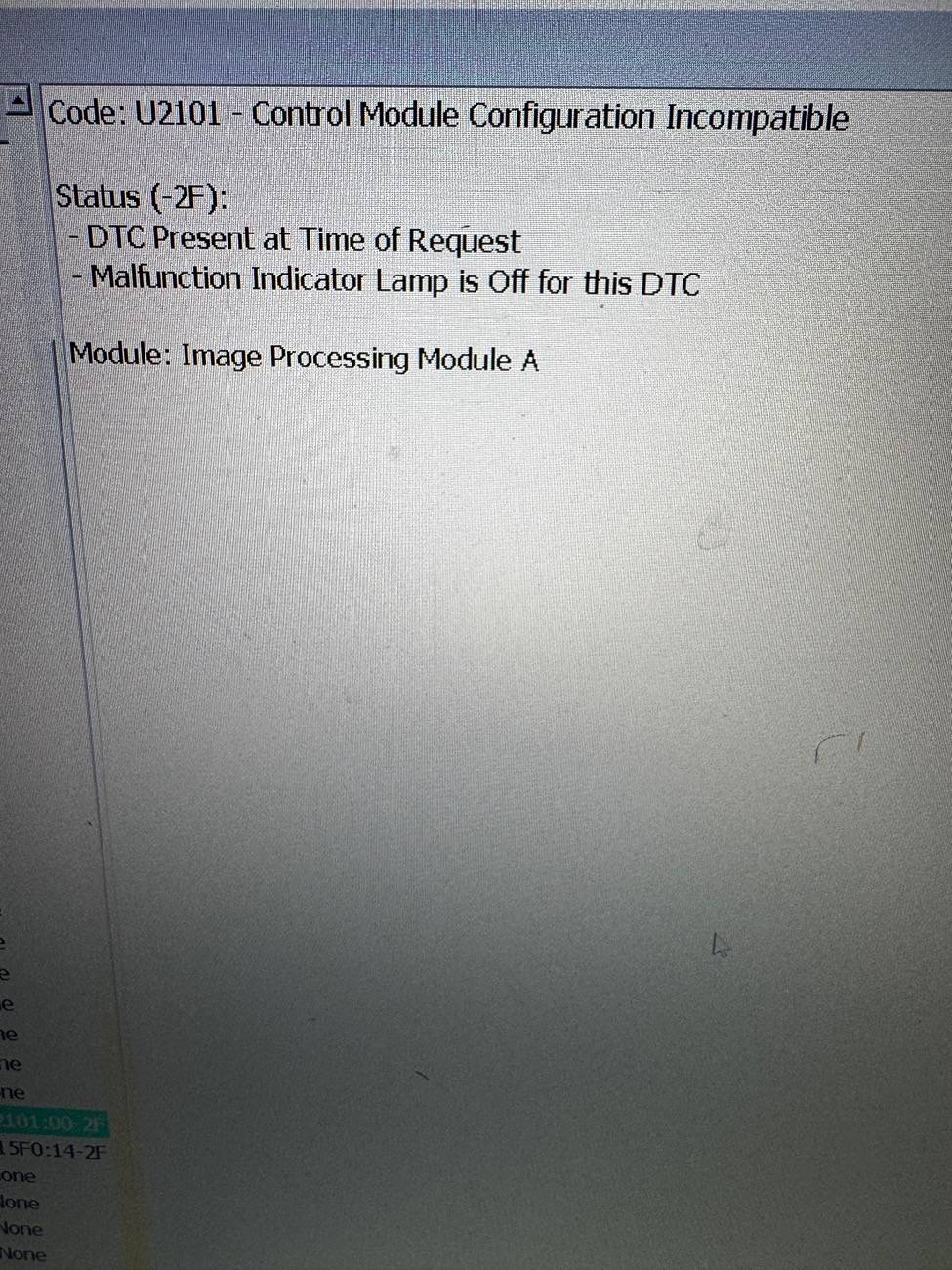

I’m having two issues :
1- CCM will not show up despite changing values at IPMA 706-02-02 to from 04 to 05
I’m Getting 2 DTC ( related to IPMA).
Connection to IPMA has been done with correct polarity…
2- One of the changes in forescan I can’t find the correct value in livnitups library… the value is located at the IPMA 706-02-01 according to literature it says I need to only change the first value but the library only shows solutions for 2 values
3 - Also not sure what would be correct value I need to change at IPMA 706-16-01 4th digit in first block

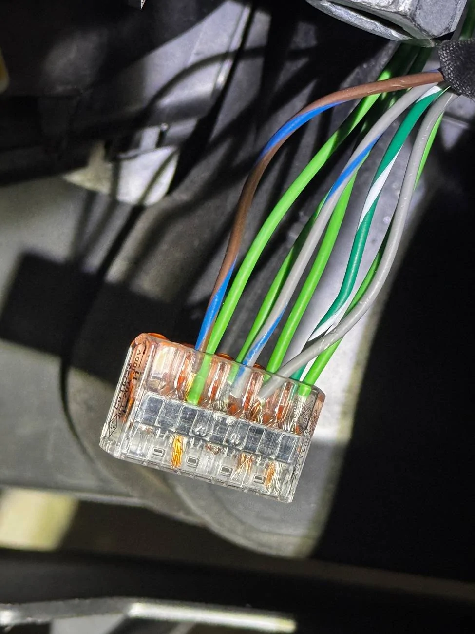

2nd picture shows connection at CCM module
I have a 2024 XLT with 360 camera
