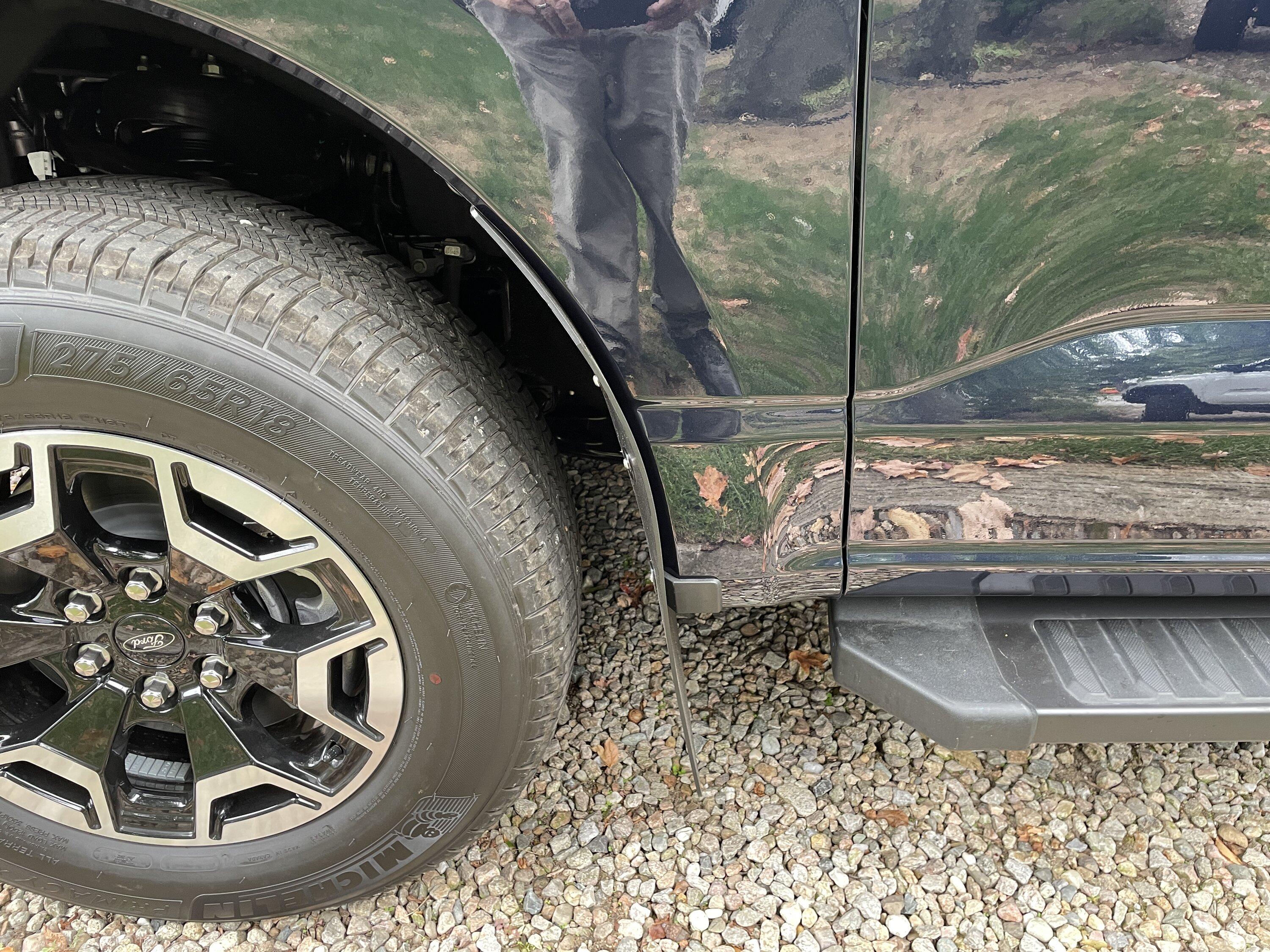

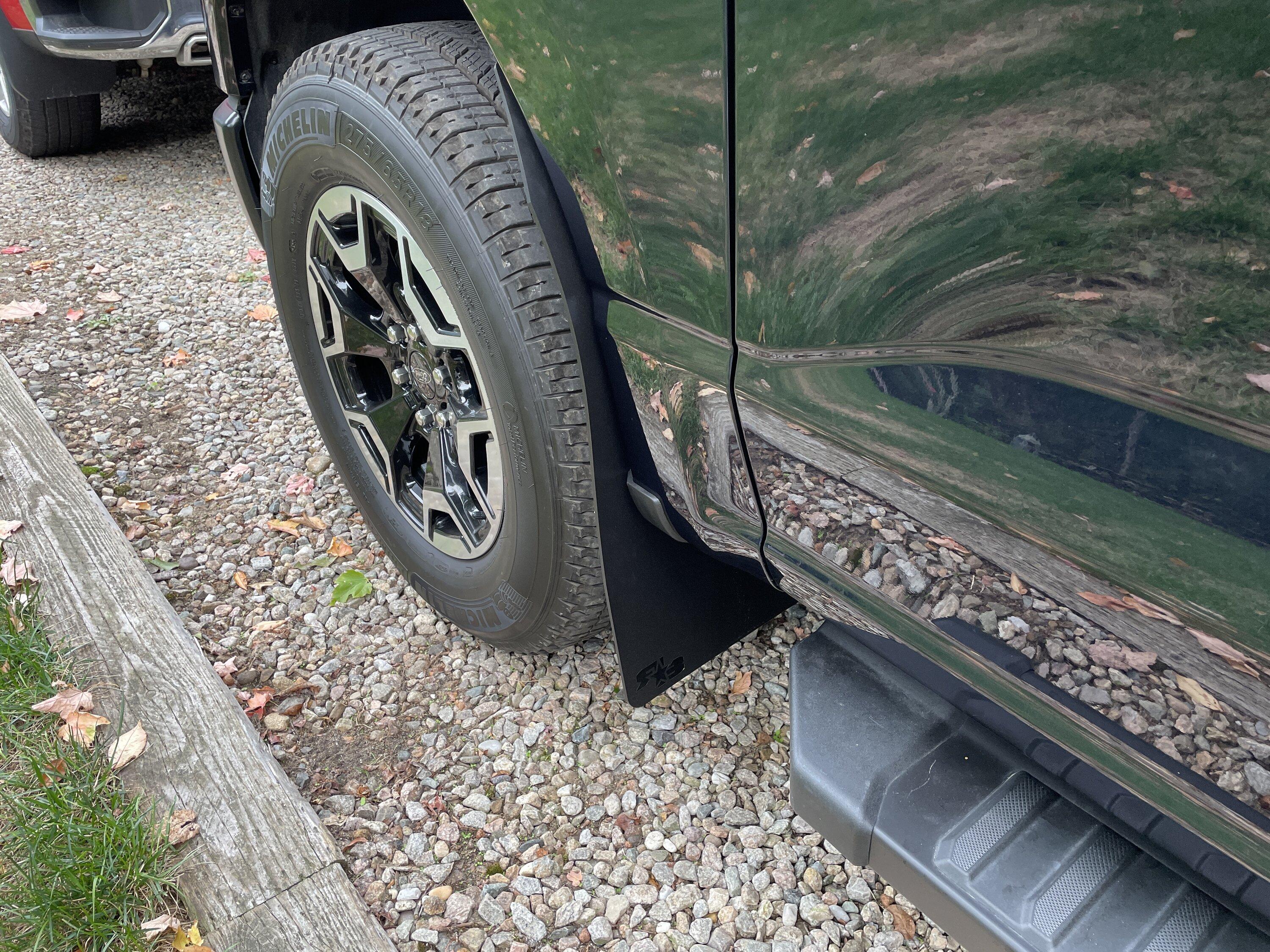

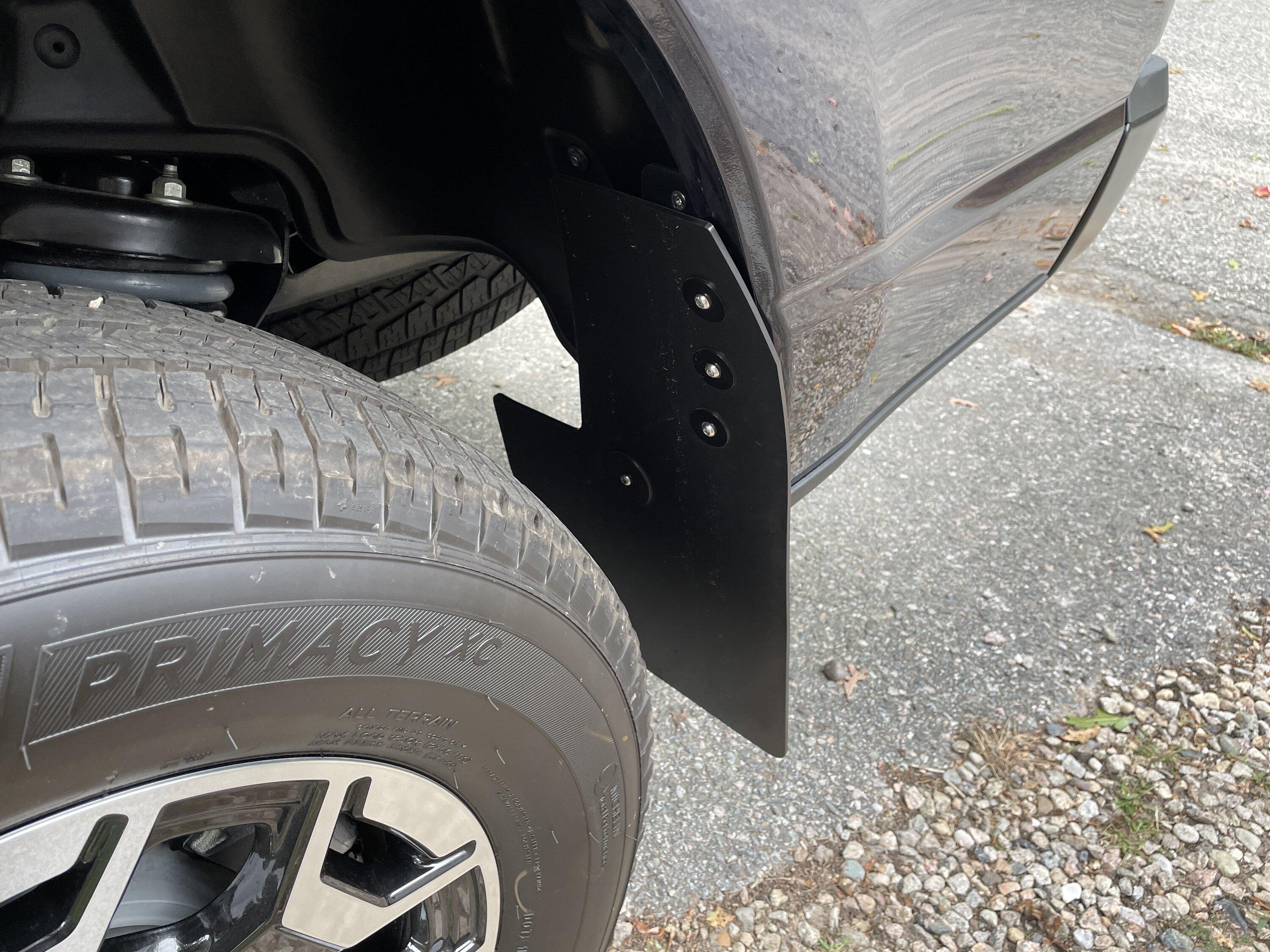

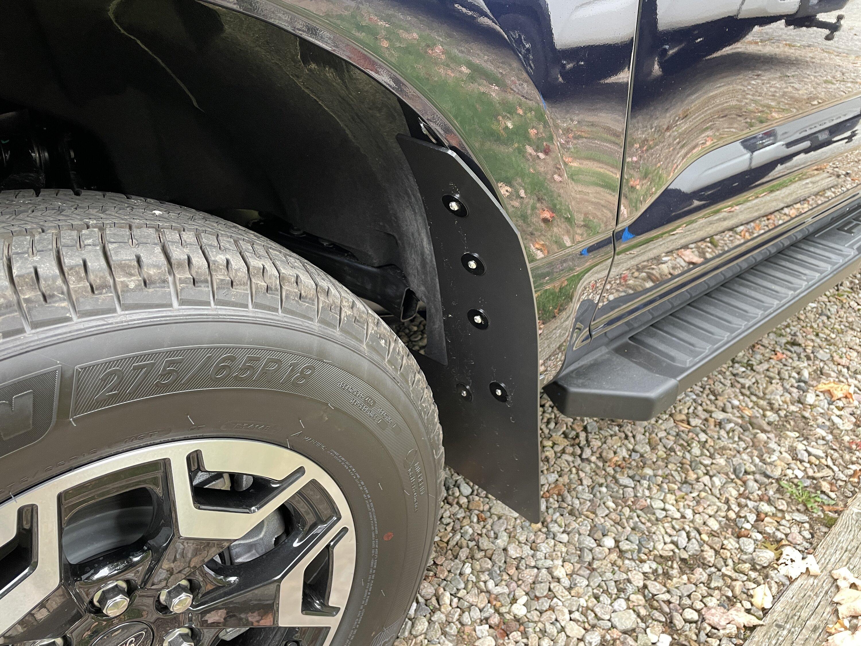

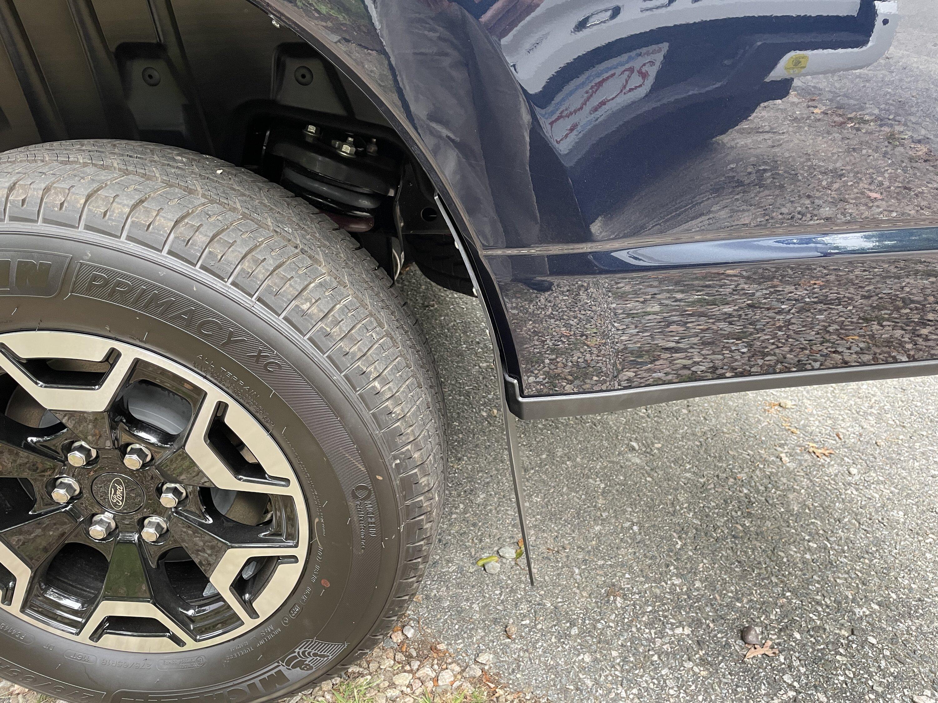

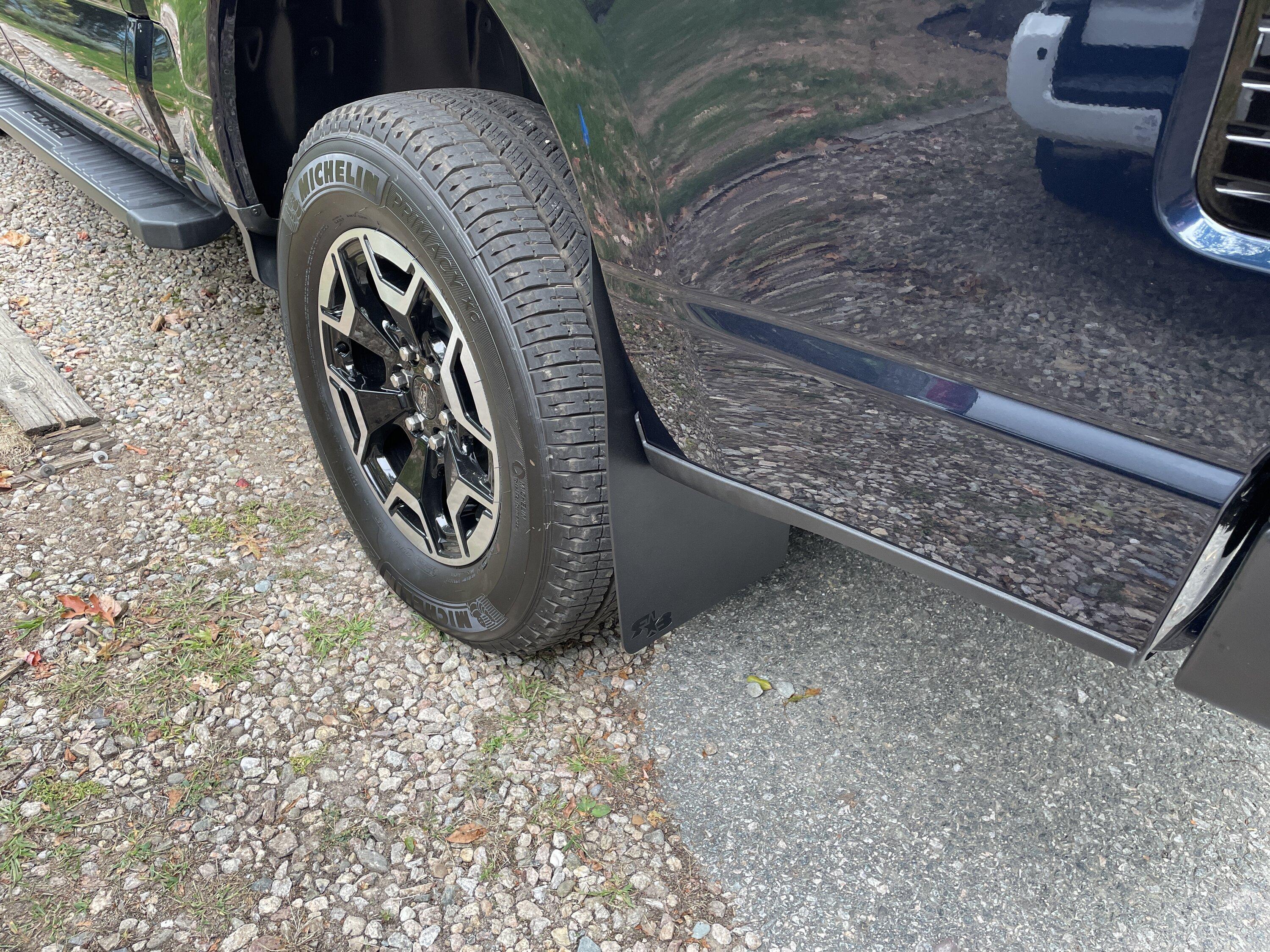

I installed the Rokblokz mud flaps front and rear on my Pro today. The front bolt on according to the instructions, the rear were more of a project but ended up working just fine with some modifications. The biggest difference on the rear is that one of the holes to attach the bracket that tucks fender isn’t there. I used their metal angle bracket to secure the bottom of that tuck behind bracket. The hole to do this is not in the bracket as shown in their YouTube install video, so I had to drill some. Unfortunately those didn’t line up with the mud flaps, so another hole and hardware was needed. If they make a specific fit for the Lightning later I might ask them to send me the rear parts, but for now I’m pleased with the fit of the ICE ones.

Here you go. I ran some 1/2” PPF tape anywhere the flaps touch the paint. They are very sturdy and I prefer the look over the factory mud flaps.
