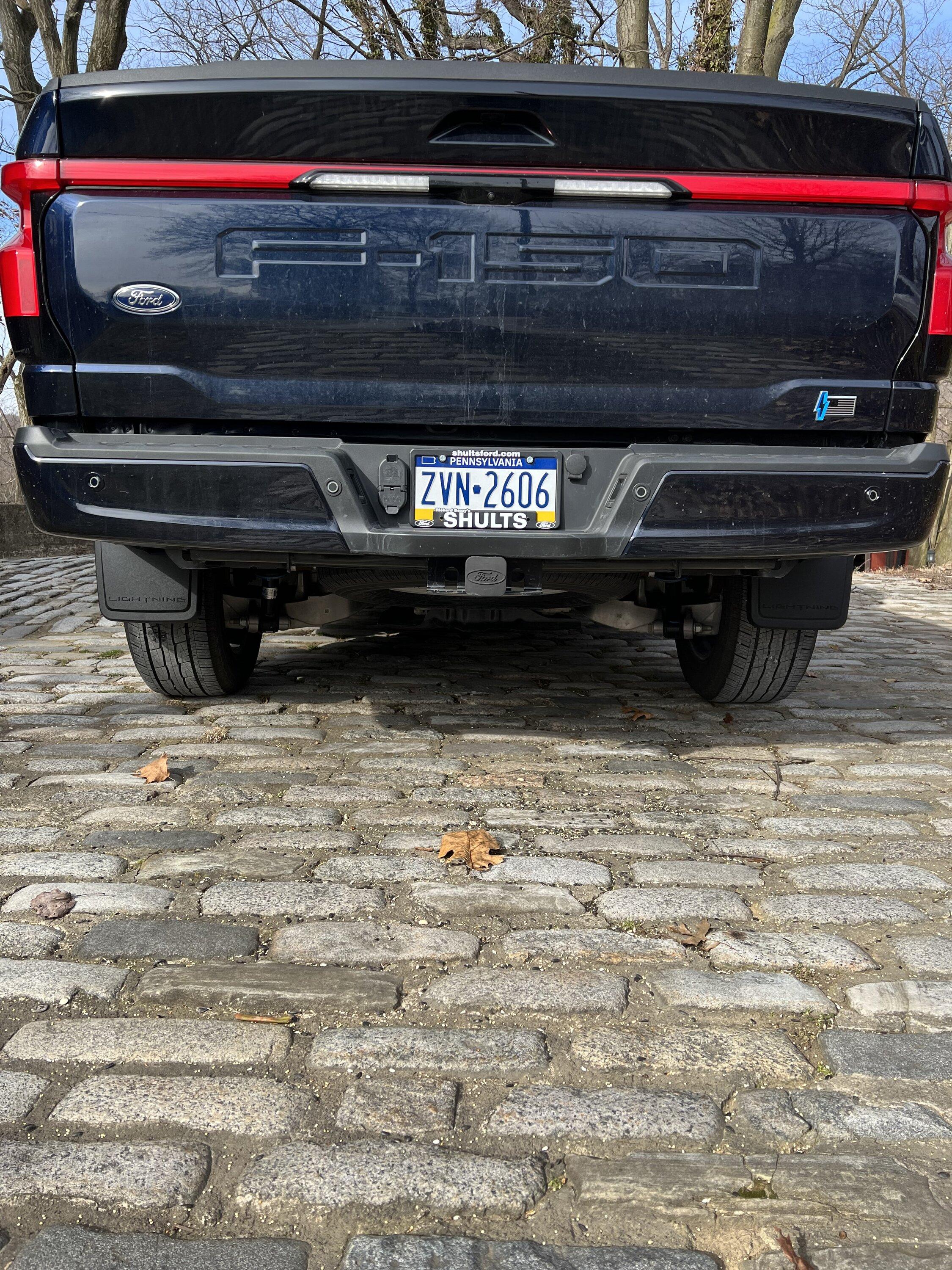

I installed mine today. The rears take a little longer to install partly because the instructions were hard to make out, pictures only, no text. A little pricey for injection molded plastic but they fit perfectly.
Can you share some pictures of the whole vehicle?

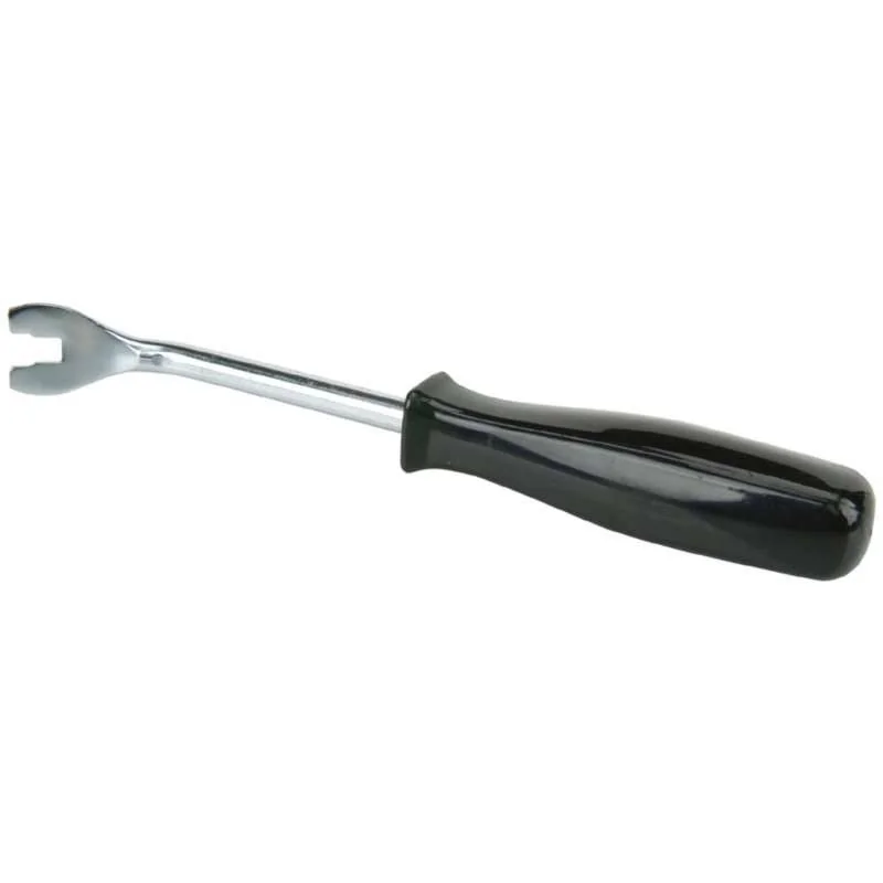

Any easy way to get those Christmas tree clips out of the rear existing guards? Just trim removal tool?

Anyone have a specific link to this exact tool? Or is this fairly standard as a "trim removal tool" ?
You'll be throwing those plugs away because they get ripped up pulling them out. I ended up snipping the post with a pair of side cutters, then pulling the heads out by hand.
THIS was the type of thing I was hoping for. Made it much easier to get them out.
