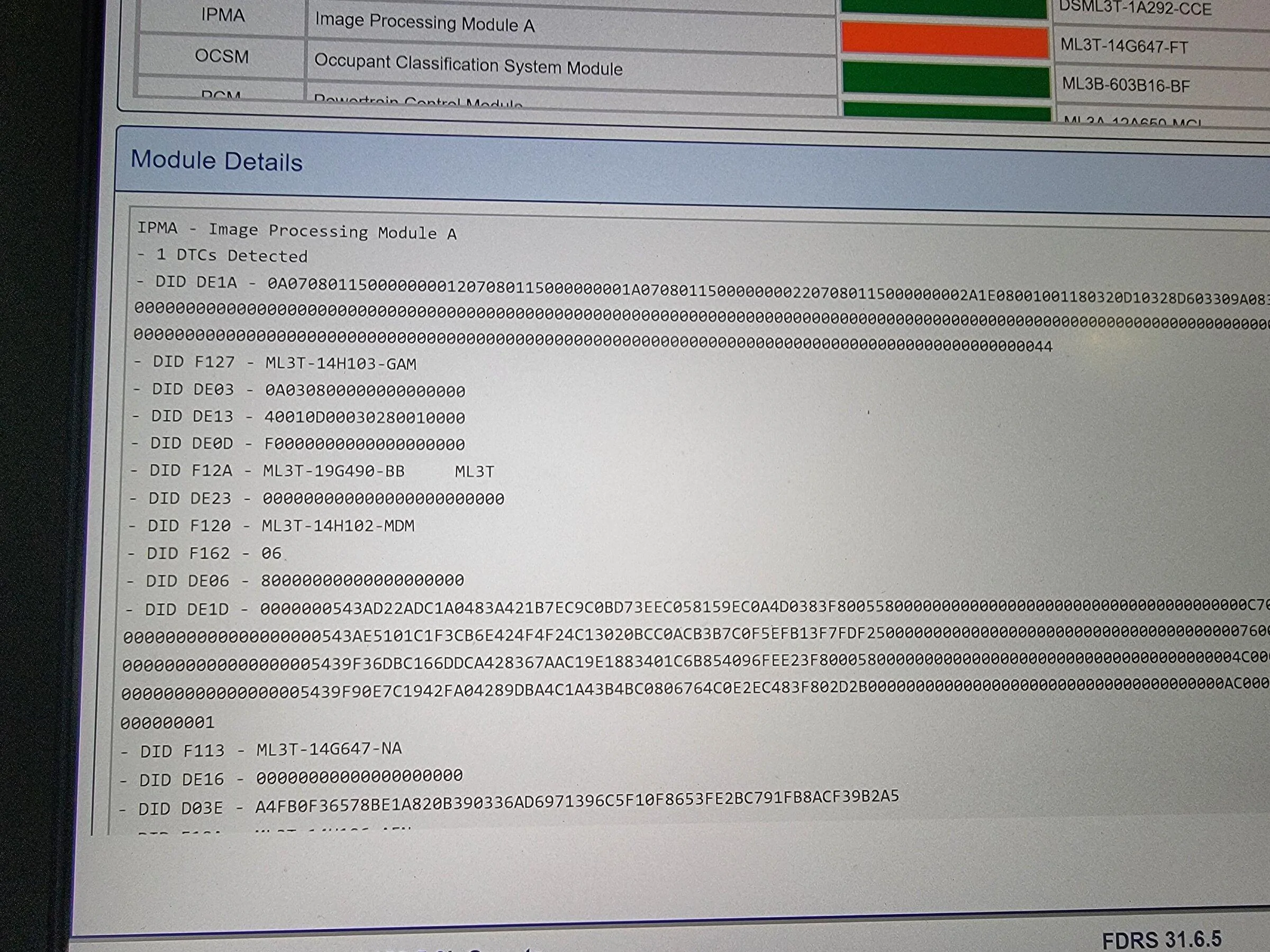

@Jesse-Infotainment @iceman77 we have an issue. My updates were fine when installing and now I am having issues as others have indicated. Taking a drive bought it to my attention when I saw "Pre-Collision Assist Not Available". I'm getting the extra 'ML3T after whitespace and a persistent DTC U2101 and using the Mongoose, see below:
Check your as built. The as built should change. Show me just the top line of the ipma
I looked up IPMA DTC U2101 in the shop manual. It provided the following description: “This continuous memory DTC sets when the IPMA As-Built data installation was not installed completely or incorrectly.“ Shop manual further says the fix is to: (1) clear the DTCs; and (2) Install IPMA As-Built data from PTS following scan tool instructions. Can you reload the as-built data via FORScan or the FDRS module configuration tool?

I looked up IPMA DTC U2101 in the shop manual. It provided the following description: “This continuous memory DTC sets when the IPMA As-Built data installation was not installed completely or incorrectly.“ Can you reload the as-built data via FORScan or the FDRS module configuration tool?
I did in both FORScan (forced) and FDRS Configuration

Well I thought I did but that is the correct change.
IF that is what the actual module is showing. Is that what it shows in Forscan?
The old config was
8A58 - A215 - 8Cxx
Not sure if you did the headlight change.. but if the new config is not working it may be an issue with the file loaded. Need to confirm the files were replaced..
The new as build is what you have except the
Xxxx - xxx8 - xxxx
That I don’t believe is standard. I is lol have to look but if I were you I’d write a as build straight from a 22 to see if the error goes away. Just that top line.
You could also write it back to what it was prior to and see if it goes away.. if it does we know you had an issue with a file

I did the FORScan change to Disable Auto-Reverse Braking & Alert... let me reset back to defaults

Ok, we now have a serious problem and although I don't think this affects everything but, FORScan changes could make life rough when doing updates. I changed it back to the default and the error as well as the DTC are now gone!
