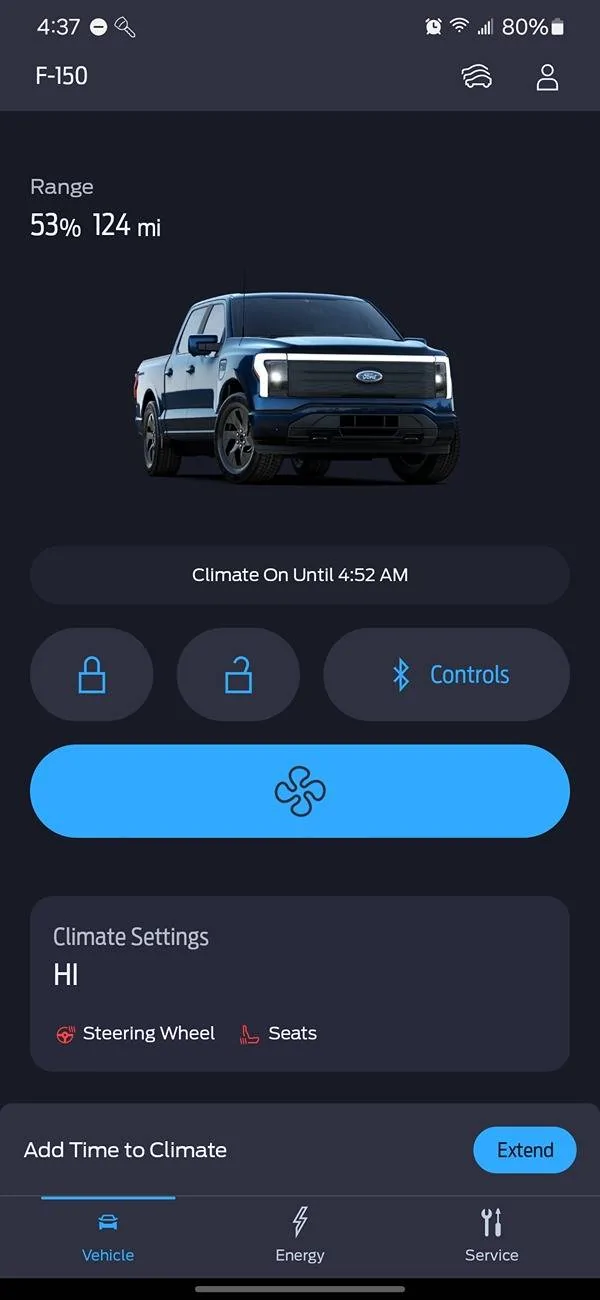

Well guess the trick is to hit the lock button followed by the remote start button twice. After starting, this is what I see in the app so it seems to take whatever settings you have set in the app. Repeating the process while running is supposed to extend the time but didn't see the ford pass app update. Pressing the remote start button once turns the truck off.
Yes, since we don’t have that feature out of the box, it’s not in the instruction manual (I don’t think). But on other Fords we have had, that was the process. Here’s the entire instruction note:
https://www.ford.com/support/how-tos/keys-and-locks/key-fob-and-remote-start/remote-start-system/
Describes extending time, memory seats, etc. Says it even turns off radio. As they say, YMMV.
