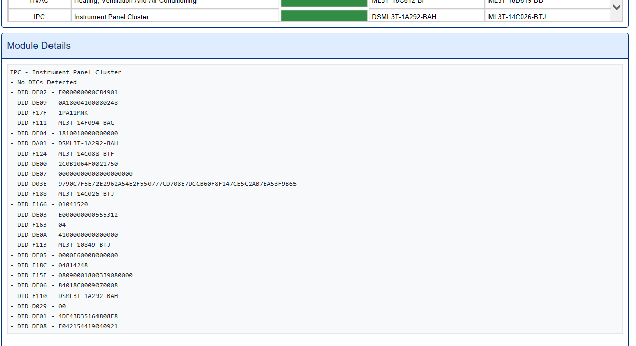

@Jesse-Infotainment I have updated to 21281 and the only other updates I now see are the phantom GSM and and ACM that consistently fails. Here are my IPC files since it sounds like that may be what is holding me up (never did see an IPC update). For reference I have a 302A XLT without adaptive cruise. VIN is 1FTFW1ED4MFB09963 if you need to look that up.
I am starting to think that may be the limit for rear cam only trucks. The guys that are all in the same spot as you are all rear cam only.
If I am wrong please let me know.
I have also found it almost impossible to nail down these cluster files. Your files are different that others but same as someone else. Its just hard to know for these 8" cluster trucks because I believe there are different files based on different engines.
I have 360 cams, but no adaptive cruise. Curse the dealer for not adding that one extra option when they optioned this thing. (had to replace a totaled truck so didn't want to wait months for a custom order). So maybe lack of a CCM is the difference stopping further updates? Also, powerboost if that matters. If nothing else maybe this helps you with the data of what is out there
Yeah I have had a hard time nailing anything down for these trucks. If you can send me your vin so I can look at all your modules.
You can add the adaptive cruise. I did. Especially since you have the 360 Cams. Just the CCM and 4 wires and the switch.

Thanks. This is helpful. We have the same values for 7D0-01-02 and 7D0-01-04. They didn’t do the trick because of issues with your IPMA.
Oddly, my original number was 6, not 2 or anything else like others. Job 1 platinum. I think Ford just hates us ?

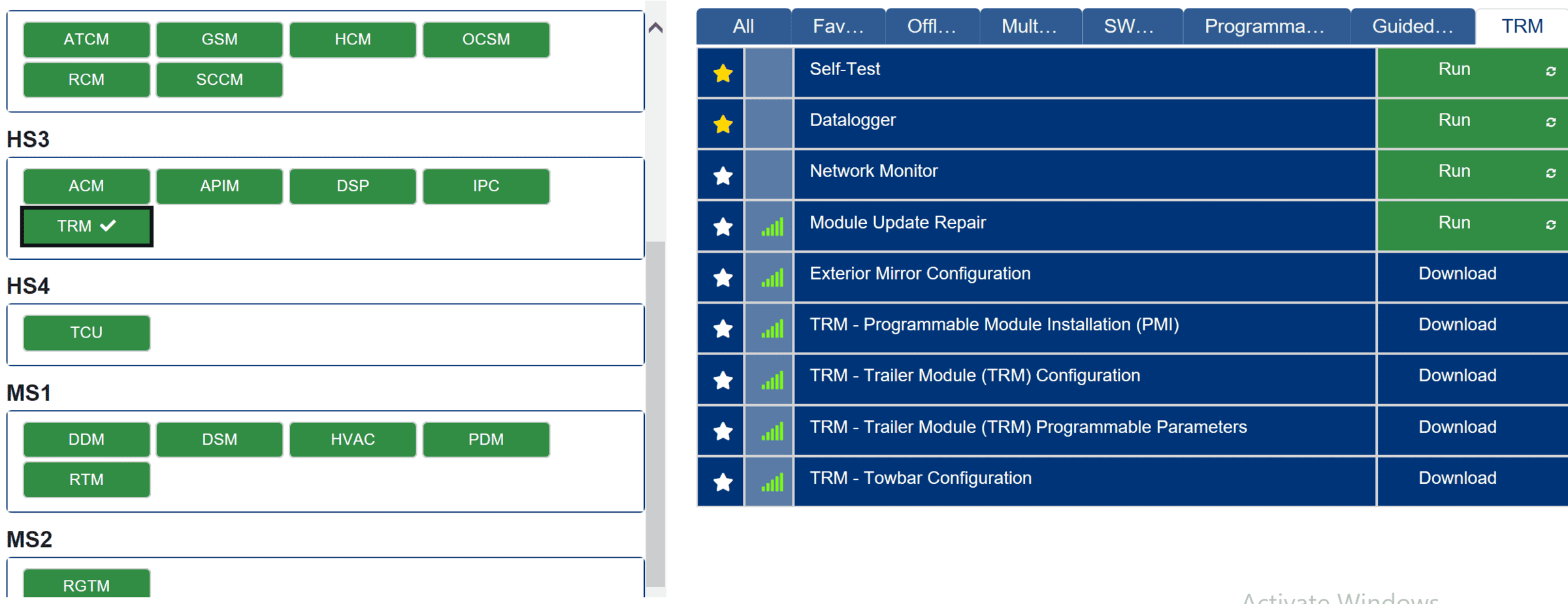

I saw on another thread that Ford just issued a recall to address an intermittent trailer brake failure. The recall involves reprogramming the TRM. It’s unclear whether the software is available yet—the recall is dated 3/25/22–but if you see a new TRM update in FDRS, I’d appreciate it if you would post it.
This is not the same TRM update released earlier this month.
Saw this too. I'll keep checking for an update. TRM was actually the first module I tried to update on the 25th and it was the only one that failed on my way to BlueCruise - but disappeared from the list when the update terminated. I can select the TRM module, and there are tools available, but I'm not brave enough to explore that. Would be nice if there was a TSB-style guide to follow.
Thanks for posting this. You have just confirmed that the TRM update is not there, yet. It should be labeled “TRM—Trailer Module (TRM) Software Update.” None of the tools you have helpfully screenshot are so labeled. But I for one would appreciate it if you kept an eye out.
