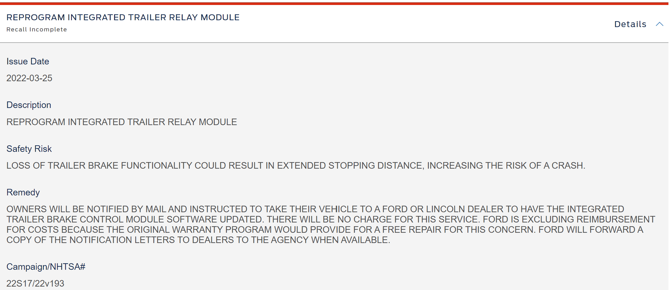

Thanks for posting this. You have just confirmed that the TRM update is not there, yet. It should be labeled “TRM—Trailer Module (TRM) Software Update.” None of the tools you have helpfully screenshot are so labeled. But I for one would appreciate it if you kept an eye out.
For the record this is what I found on my account today:
Ford F-150 Lightning ECU module programming guide using FDRS Screenshot 2022-03-29 195722
