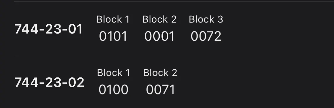

Got it figured out. There was a DSM SW update today so I did that and it fixed everything. So with the DSM update it put the boards back to factory original settings but instead of the annoying locking the truck from the door outside button the steps going up and not even 2 seconds later they come back down, it appears Ford fixed the bars and they stay up when pressing the outside door button, door outside keypad lock, or fob lock button is pushed and you around the vehicle walking away. This is nice that's finally fixed as that was annoying.
Now before I did the DSM update I was doing some testing in Forscan and found a great setting with the step bars only coming down when the door was opened but as you approach they stay up and your approach lighting still works (as long as you don't have Lincoln AutoFold Mirrors set instead of the original AutoFold Mirrors) as well as the step bar switches will work. This is great when you are walking around your vehicle but tired of the steps going up and down constantly. My settings on the sync screen are Power Running Boards Auto, Timer 5 min, Approach Setting and Lighting set to on. After you have this all set leave it and don't touch. Make the changes below in Forscan then do the module reset and away you go. So the settings I used were the following.
744-23-01 > 0001-0001-00XX
744-23-02 > 0101-0000-XX
or for those with older block setup for that line 744-23-02 > 0101-00XX
I think for Approach Detection Power Running Boards it is enough to set the ADPRBOC flag to 0 (or DISABLE). OEM value is 1 (or ENABLE).
744-23-01 -> 00xx-xxxx-xx--
Works just fine for my '22 F-150 Platinum PowerBoost. The lights lit up when approaching the truck but the power running boards stay in. They deploy ONLY when doors are opened!
Perfect. Not sure what the rest of your 22 OEM settings were for those 2 lines? Did it add an extra block to your 744-23-02 Line? Also did you check your switch on boards if you like them left on?

My problem with these “Welcome Lights” is that every time I approach the truck with my keys in my pocket, apart from activating the external lights, it also activates the USB ports as well as the APIM/SYNC screen inside the truck that stays on for 10 minutes before shutting it off (just like you would step out of the truck and closed the driver door). This will not sit well with my battery over time.

FYI - Here are my OEM values for DSM
Ford F-150 Lightning ECU module programming guide using FDRS 1649037864984
I just changed the 23-01 1st octet from 01 to 00. The rest I left untouched. Did the trick with auto power board deployment on approach, but as I mentined above, the activation of the USB hub and sync unit inside the truck (without opening the door) does not sit well with me.
Your truck is a PowerBoost? You wont have any battery issues. There is a secondary battery as well thats supplemental battery power and good alternators on these trucks with a AGM battery and you also have the onboard battery that runs the truck so you have plenty of battery.
Yes those were my factory settings as well now I just tweaked it a bit.
Did you notice any change by setting the 2nd octet on 744-23-02
744-23-02 xx01-xx—
My OEM is 00 there
744-23-02 xx01-xx—
My OEM is 00 there
None that i no of. I left those both as configurable. I figured that was to allow it to be changed in the Sync 4 Screen if wanted but I find when you make changes on the Sync 4 screen it sometimes messes things up so I haven‘t done much for turning off and on the settings via Sync 4. Maybe if we turn those off it makes it not change at all if you toggle Sync 4 settings on and off. I dunno. I wondered out loud if Livinitup or Jesse Infotainment know what the added second block adds with this latest DSM update.
