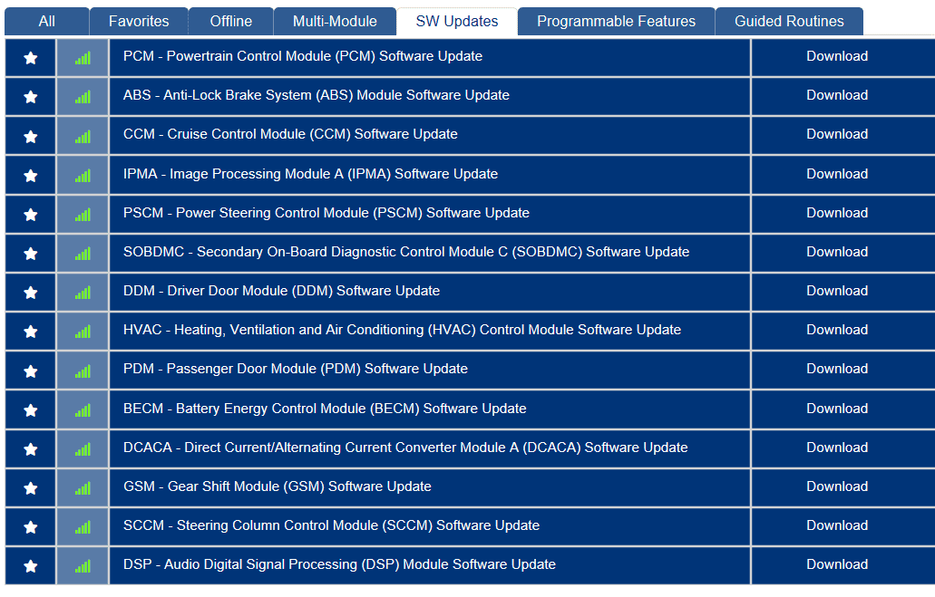

You have 14 software updates in the queue.
I'll give you a screen shot shortly

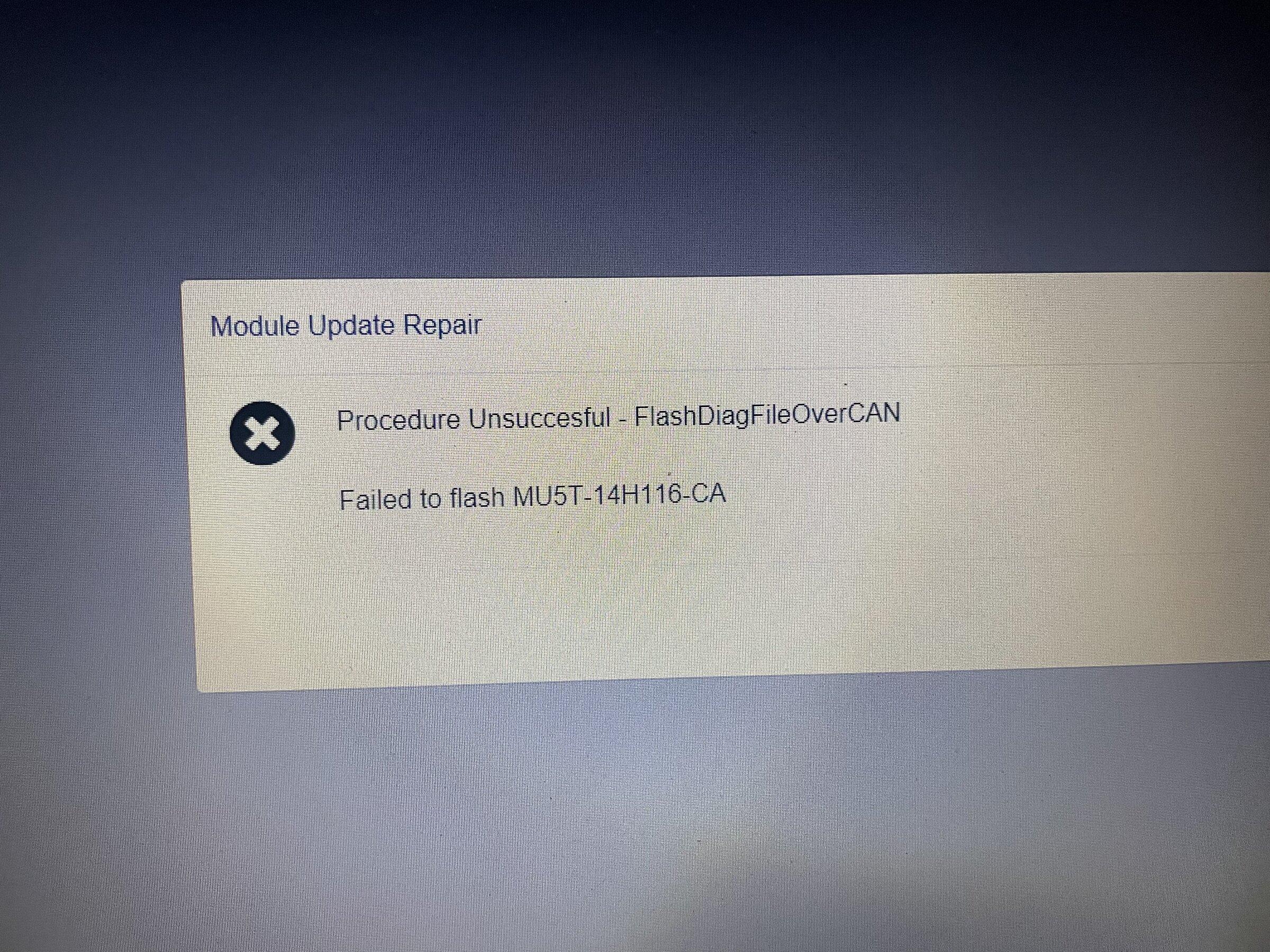

Got my mongoose adapter today. Running all the updates for Blue Cruise. Started off with attempting to get my APIM to update to no avail, and also tried running the TSB again to no avail. Uninstalled FDRS and reinstalled, didnt help. Still getting this persistent error.
Ford F-150 Lightning ECU module programming guide using FDRS DE828F8E-192F-4D10-AF5F-452520C076C0
Was hoping the mongoose solved this but didn’t. Im out of ideas. Starting to think im going to have to rely on the dealer for this one, maybe i need the APIM replaced for real.
Still at sync version 20312. ???
Actually the info on being up to date was from Ford support center. My dealer told me that if any updates needed, they would be applied over the air. Its been about a week now and no OTA updates have happened. I wonder why so many if in fact OTA is really working?
