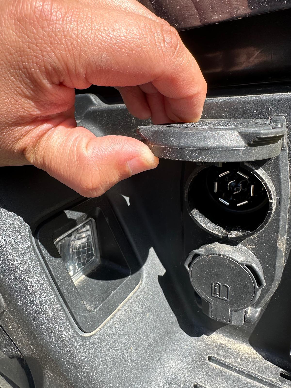

Not a fan of the trailer plug design on Lightning with a flip down vs up as on my older Fx50s.
Pulled a trailer 300 miles in rain, since disconnecting getting screen errors for brake controller and turn single is doing the “rapid” flash I historically attribute to a burnt bulb.
Looked in the 7 pin and it’s full of water and fine sand (this was highway towing). I’m hoping once it dries out the errors will stop…
however design wise the flip up protects the connector and a slight downward angle drains. This design does neither.
I never had a problem with mine, but...just replace it?
If you have one that's the other way, or pick up one up that's the other way around. It takes maybe 30 seconds to pop out and plug in. Here's mine from when I did the trailer cam upgrade, opens up instead of down:
