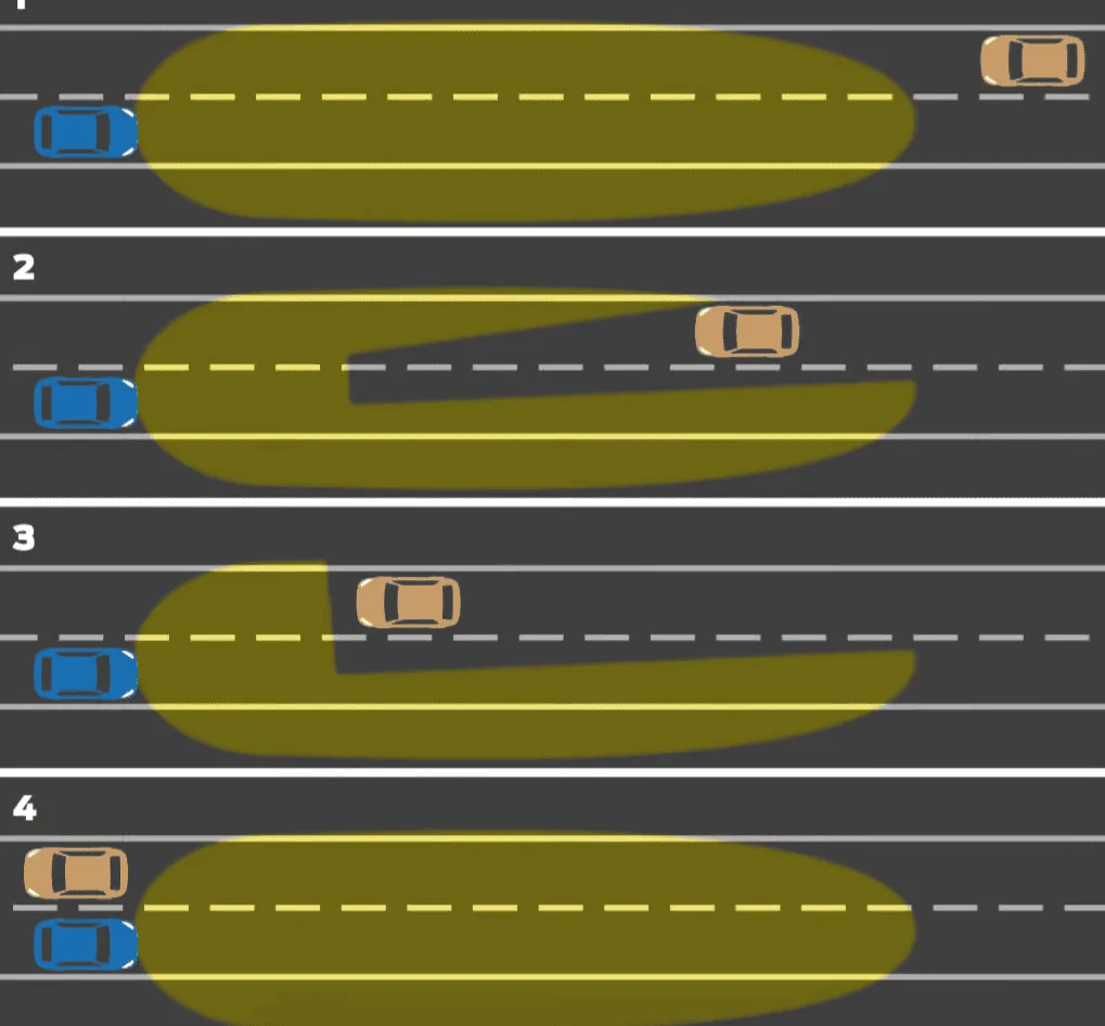

Glare-free (matrix) headlights (localized dimming of brights based on surrounding traffic): Successful. The necessary hardware is available in my Lariat ER trim. The swiveling (dynamic bending) lights continue to work with these settings. Settings were adapted from this F150gen14 ICE forum thread.
APIM7D0-09-01x1xxxxxxxx--
APIM7D0-09-03xxCxxxxxxx--
IPMA706-01-01xxxxxxx9xx--
SCCM724-04-01xxx4xxxxxx--
HCM734-01-01xxxxxxx0xx--
HCM734-01-02xxxxx2xxxx--
HCM734-11-01073589

I wonder if all trucks have the same sensor package. I’d assume glare free is using the cameras. Do bluecruise trucks have extra cameras or sensors?

Was able to enable glare-free headlights on my Lightning ER. See OP.

Nice! I didn’t get this one to work. I got the glare free to show up but lost movement o the headlights so I went back to stock
