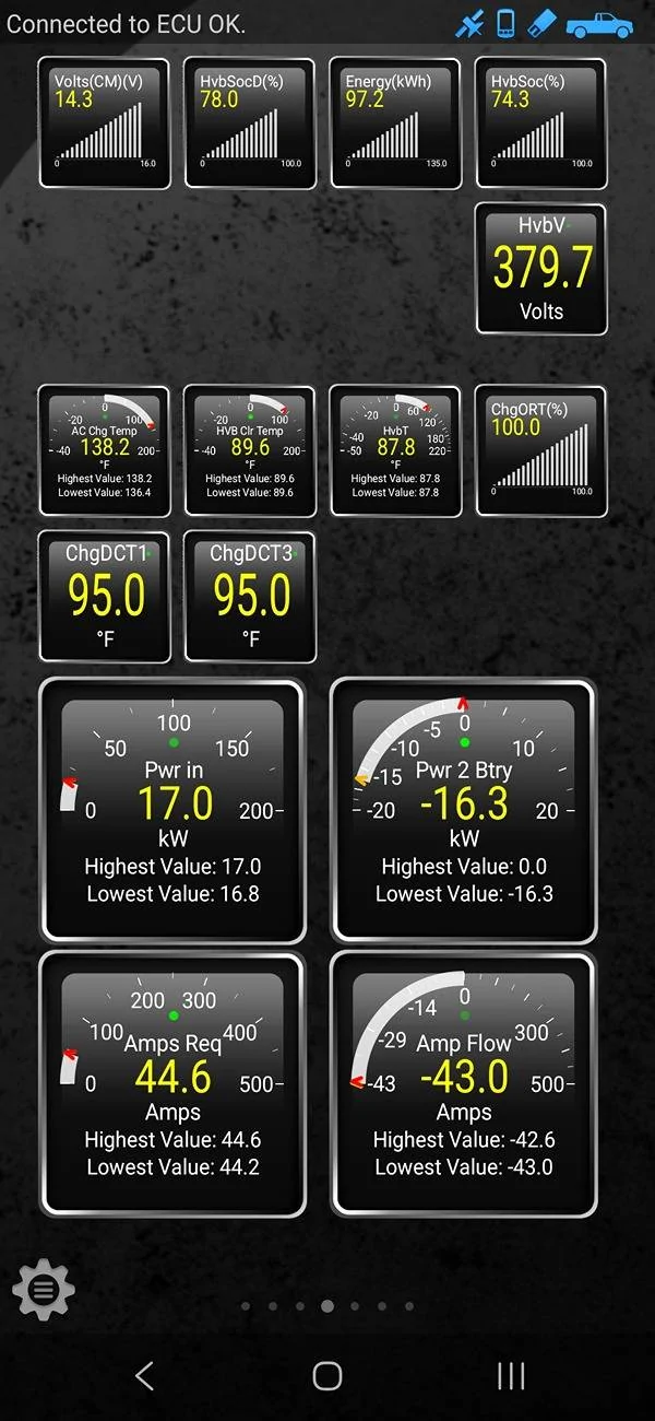

Took a quick screenshot while I'm topping up from the day's errands.
I think I grabbed these using the spreadsheet you referenced. I'm definitely missing some of what you have on the consolidated over. Great idea to give torque a dedicated thread. I'm also a pro user, I really like the customization available. I'm still playing with the arrangement and trying to rename for better clarity.

As a side note, how is 44A equate to 17kW power? I'm a little confused, maybe I have some things mistakenly labeled?

Good question.
A quick look and at a pack voltage of 379v, 44.6a equals 16.9kw. I think its all correct.
Not sure where the 43a fits in there though.
I'm guessing you are running a FCSP?

Oooohhhh, yeah I was using 240v for my math and didn't consider that the power to the battery would be at pack voltage. The -43 is current flow into/out of the battery. When I'm driving its a positive number which goes negative during braking. So it seems a neg number is power into the battery.
