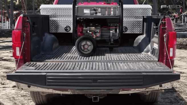

Wasn't sure if you knew that, because you suggested a gas generator to charge while driving (if you do use a generator to charge, it needs to be a pure sine wave inverter generator)
You seem to have missed that it was a joke.
