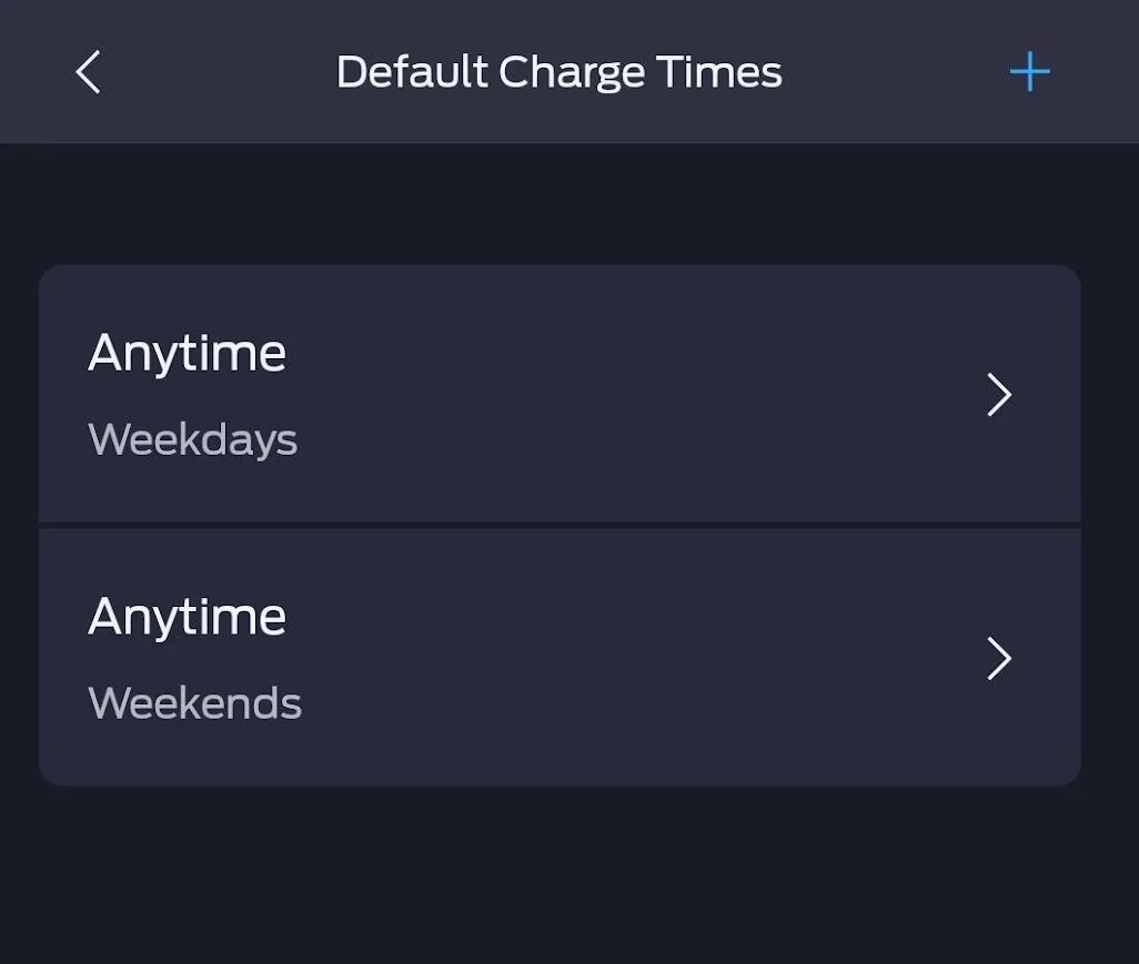

Do you use time limitations on your charging scheme, what are they?
I wonder if the BMS logic is "pausing" because of the low temps until your charge and departure windows coincide for just in time charging and battery conditioning to be optimized????

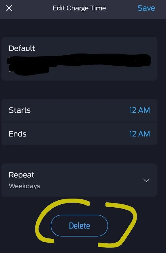

Reset departure times and charge location and try again.
I've never had the pleasure of -11 weather yet.
I have my Preferred Charge Times set to 12am - 12am so that I can charge any time I plug in. Departure is set to 8am so there isn't any overlap. I would guess that 7 out of 10 times I charge with no issues.
