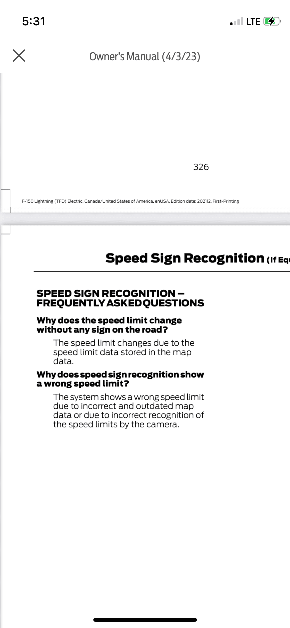

Wonder if there has been issue with the mapped data:
Ford F-150 Lightning First BlueCruise Oddities IMG_1657

The system does not use OCR. It uses here, technology.

Were you using the built-in navigation map, or your phone's navigation? My built-in navigation sometimes loses connection to the GPS satellites, and it has no clue where I am unless I reset the system. If the system can't read an actual speed sign, and instead tires to go off of mapped data, maybe it thinks you are somewhere you are not?
