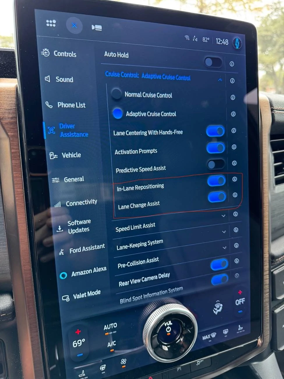

If you are up to date on OTA software updates and your dealer performed CSP 24B56, then you already have the lane change assist feature hidden in the software of your truck. You next have to use FORScan to unhide the toggles in order to enable the new BlueCruise features. By default, they are off until you physically toggle them on. As of right now, you only have the improved lane centering software that was updated via CSP 24B56.
Alternatively, you can just wait until Ford send you an OTA update that enables these new features, but many of us got tired of waiting and enabled them ourselves via FORScan.

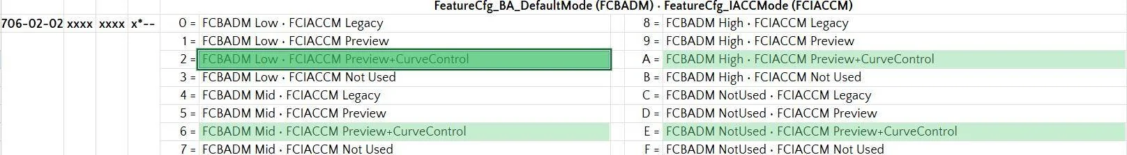

yeah I have it enabled on my 23 and noticed the lane change and in-lane repositioning were missing. Still need to go back in FORScan and disable that stupid curve assist as it's practically useless and dangerous with it's manic behavior.
What are the steps to disable curve assist with Forscan?
To disable predictive speed assist:
IPMA (as built)
706-02-02
xxxx xxxx 00--

yeah that's the value I was looking at. Any idea what the difference is between FCIACCM Legacy and FCIACCM Preview? I was considering changing it to 1 to just remove the curve control but hadn't gotten around to it.
No idea, but if you're going to experiment, make sure you back up the IPMA config. That is one module you don't want to FAAFO with or it will throw all kinds of codes and prevent other features from working.
