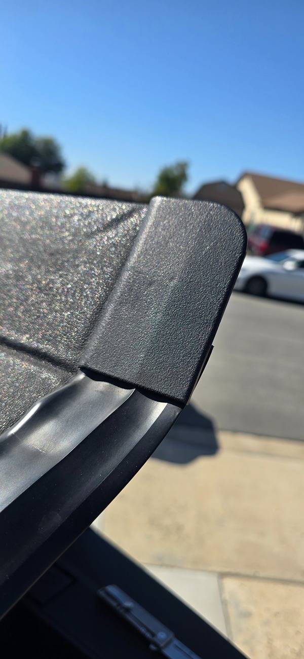

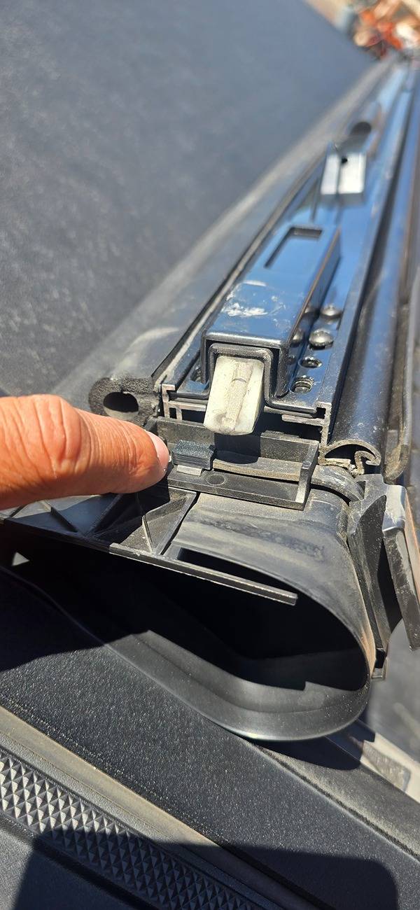

Hey Guys. I love these Revolver tonneau covers. But the one issue is the corner covers pop off and get lost. Its a known issue and Bakflip will send you new covers.
I just made these little plastic plugs that fit into the back of the clips preventing them from loosening. They are easy to make. If anyone wants them I'll sell them for $2 plus shipping.
If you have a printer I can send you the file.

Yeah these plastic pieces have been loose on mine since day 1. I’m not quite sure I get how this plastic plug helps though. I’ll have to go out and see later when it’s not raining.

The plug squeezes between the clips in the back. Preventing them from loosening.

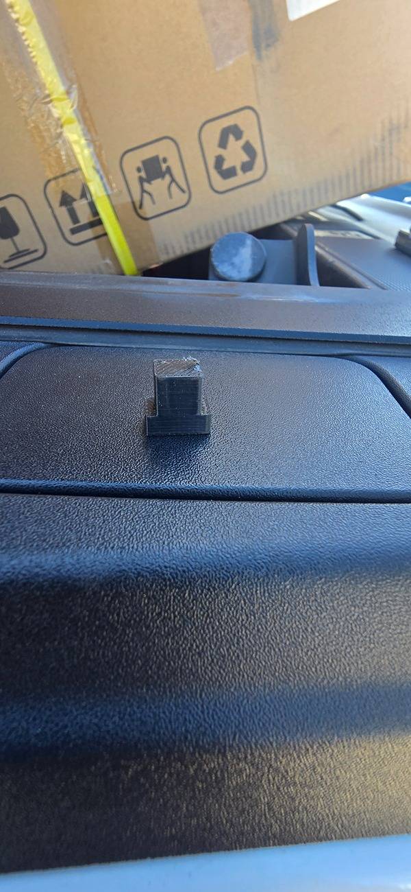

Here is a picture of it installed. It can easily be removed.
