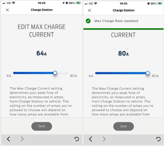

I have the Beta test version of Ford Pass & can confirm that my version of the Ford Pass will let me adjust the Ford Station Charger in the app - see below. I couldn't get the Ford Station Charger to talk to Ford Pass until just recently. I've been able to adjust the Charger ever since.

How do you get access to the beta app? I am able to change this slider, and it shows success in the app, but it doesn’t change anything. Turned the breaker on/off a few times and still can’t get my charger to go to the full 80. Internal dial is set properly and I used to be able to control the rate from the app.

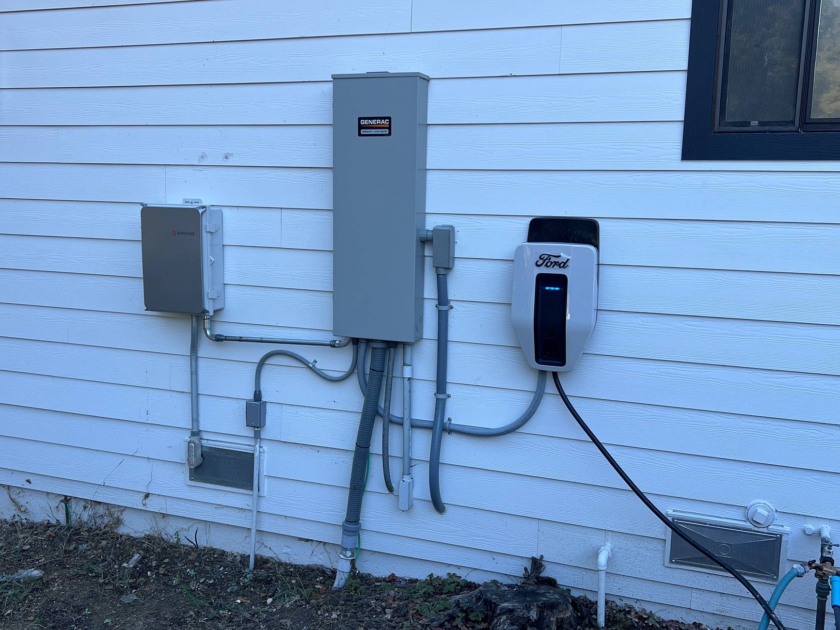

When I first installed CSP I set the HW dial to enable 80 A . When I connected to the car it maxed at 6 KW and amber led was lit while charging. I went into the Charger Settings from FordPass and noted the max current was set too low (25 A). I dragged the slider up to 80A and max charge is 16.7KW. So I know there is some connection working now in the app for current setting. Just set to 80A and left it there.

Figure I paid for 80A so i wired to do so. Right next to main panel and short #2 copper wires.
