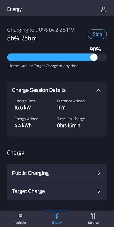

So you can see the charging status and rate in FordPass while using the mobile charger, that tells me the telematics communications should be OK.
That should also work with the FCSP or any third party EVSE
Just to be clear this is what I'm referring to, the active charging session data screen on the energy tab of Fordpass

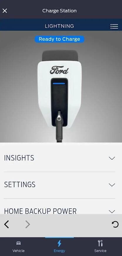

Is your FCSP always powered up? If you switch on the breaker only when you use the FCSP that could be part of the issue, sometimes it takes 5 to 30 minutes to reestablish FCSP data reporting to the cloud). But the basic charging details in the active charging session on Fordpass come from telematics not the FCSP directly.
There are multiple channels of data flow occurring.
Is your local network signal strong enough to reach the FCSP?
Reconfiguring / installing Fordpass might have hosed up the association to the FCSP data account, (not certain about this)

BTW: for the sake of clarity: Ford Pass> Energy Tab> Charge Station:
If you're showing off line, then it's a networking issue, not enough time to communicate with the cloud after power up.
