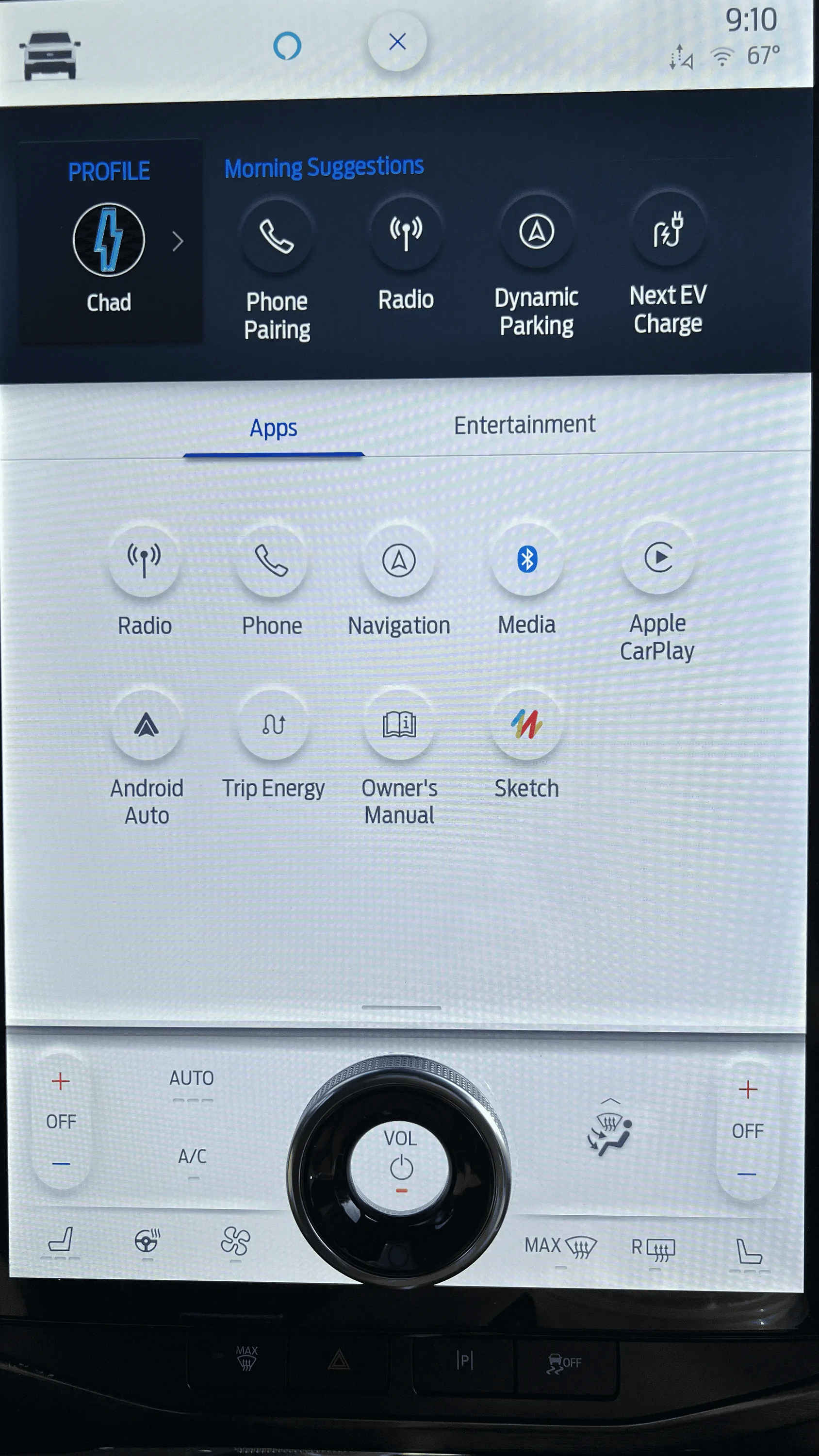

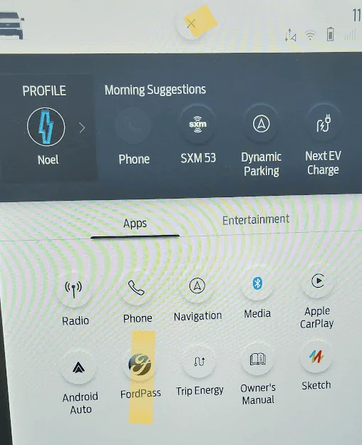

While poking around the Sync 4a screen, I tried out the FordPass Icon under Apps.
Ford F-150 Lightning FordPass on Sync 4a Screen 1670349442604

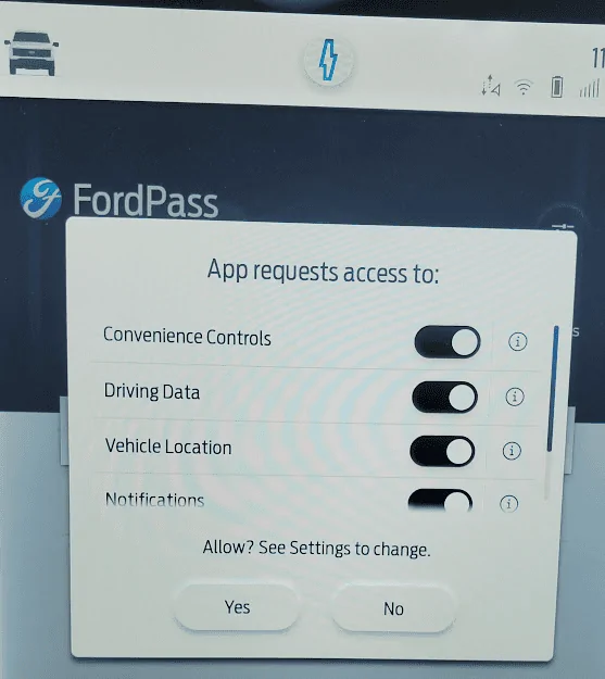

This triggered the following consents, I thought I had done this previously elsewhere in settings, but apparently what happens here has additional impact of truck telematic functions.

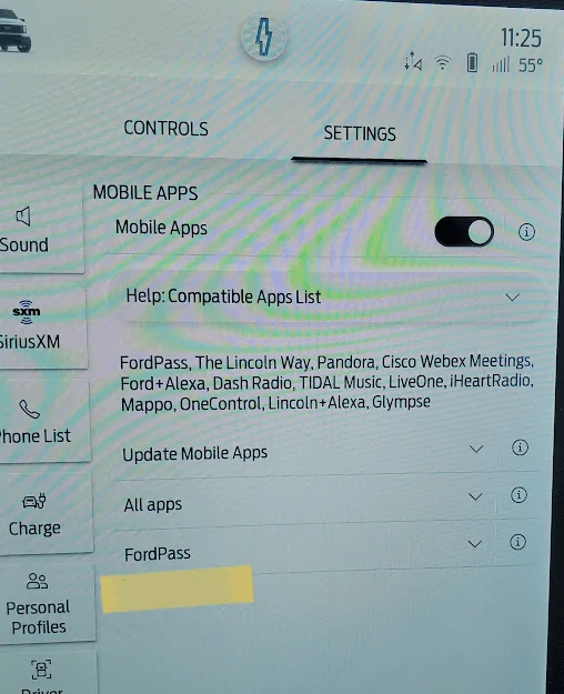

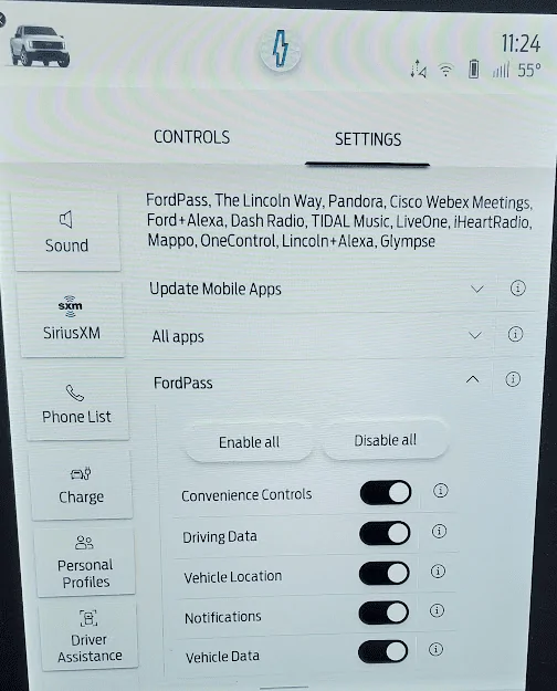

Now "FordPass" is listed and you can tailor your consents at risk of losing functionality.

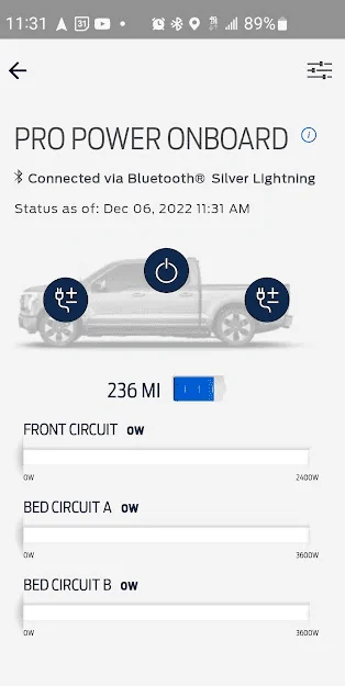

Pro power onboard is now controllable from the mobile app truck still needs to be "Running"
You can switch the PPOB on and off (while truck is on), as well as the Front & Bed inverters.

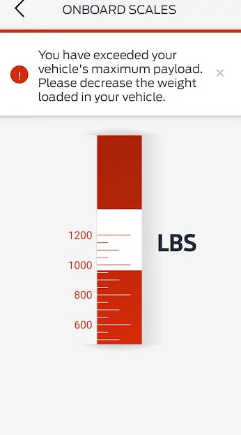

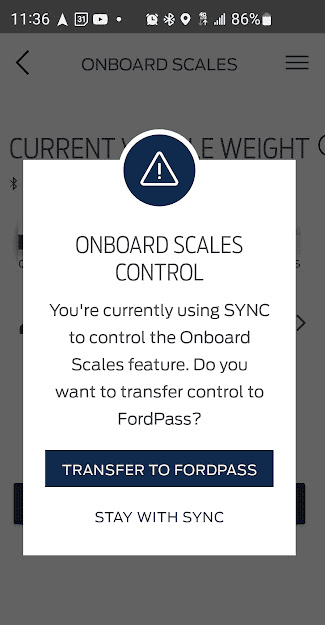

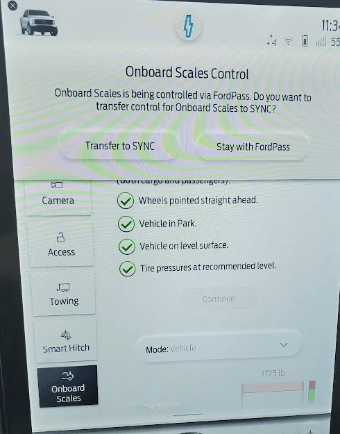

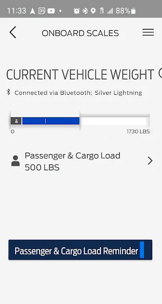

Scales work too, note you will see this pop up on the Sync console if the scales are displayed and you start the scales function in the App, either of them will warn and offer you to stay with or switch to the other mode of operation as you need it. Can not display both at the same time.

Display of the scale data can be in either format, touch the ⇶ at the top right to show the scale display mode and the passenger load adjustments

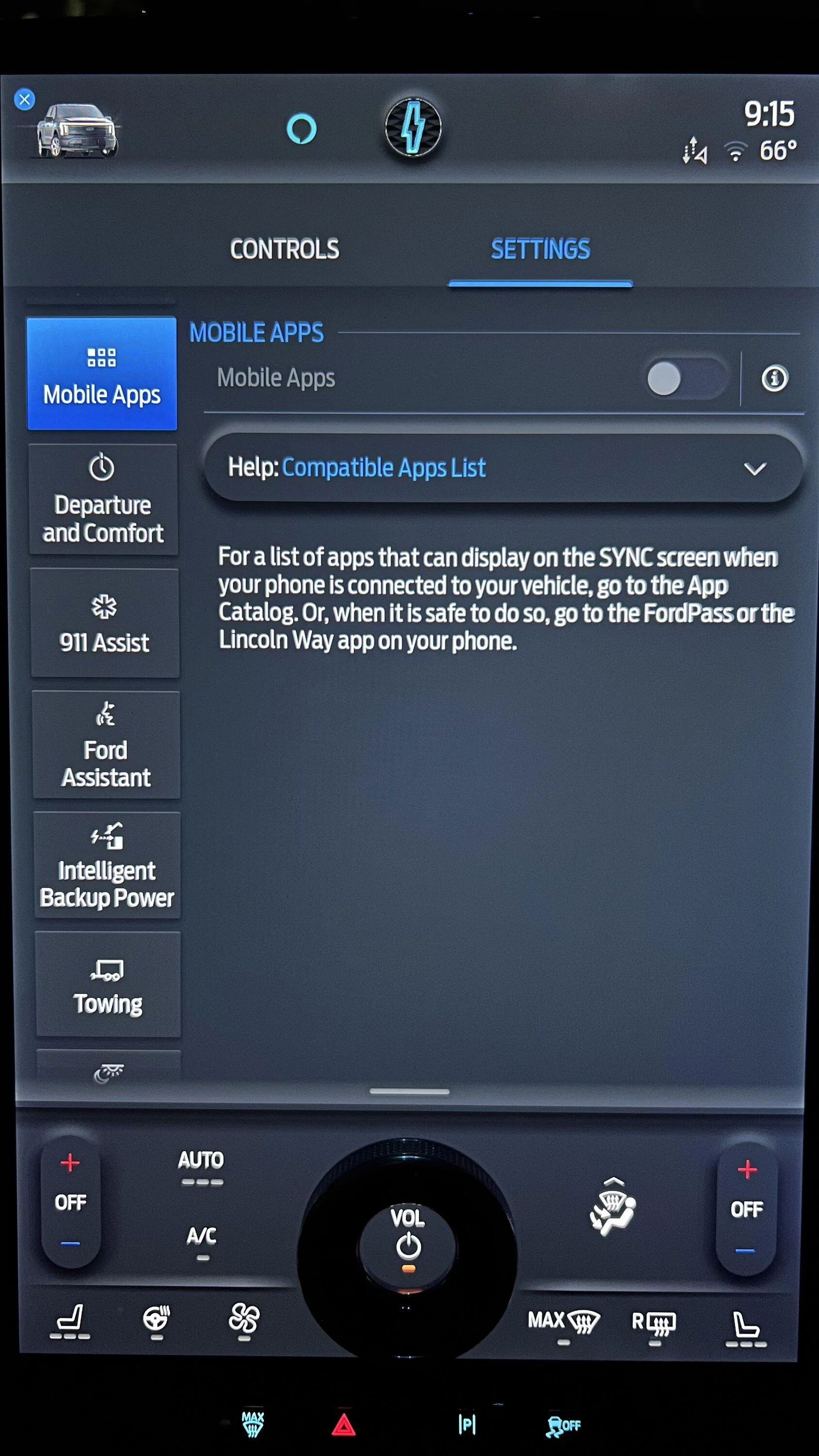

I’m on CarPlay, PU 3.5.5, 22-PU0929-BLM-UP. PAAK is active, and we have the same Features & Settings in the FordPass app, but the Mobile Apps setting in the Sync4A settings is grayed out. Is it only active with Android Auto?

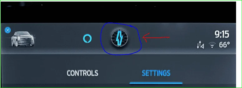

Double check these steps.
Step 1
Click the Icon with the Lightning symbol for profile information
Ford F-150 Lightning FordPass on Sync 4a Screen 1670383693031
Step 2
Within that menu you should see a FordPass Icon under Apps, tap it
Ford F-150 Lightning FordPass on Sync 4a Screen 1670383816762
Step 3
Click Yes to allow these functions to work, the consent process to unlock the grayed out switch.
Ford F-150 Lightning FordPass on Sync 4a Screen 1670383896225
Step 4
Return to Truck Menu, Settings, Mobile APPS,
Look for Mobile Apps switch to be on or tap to turn on.
If it's still grayed out, I have no idea why, other IOS users should confirm.
Ford F-150 Lightning FordPass on Sync 4a Screen 1670384006019
