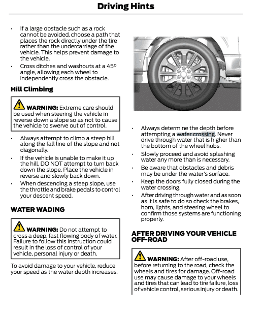

Hello folks,
I'm a relative EV newbie, I was pondering a dilemma.
In my area, we have been experiencing heavy rains here in the SF Bay area.
With my 06 Taco 4x4, & work Trucks, I had forged large puddles occasionally, pushing non flowing water to get to the other side.
What is the capability of the Lightning?, would you try it? or would it be, water & electricity don't mix?
Any thoughts, or your experience in a similar situ.
Thank you for any insights....
