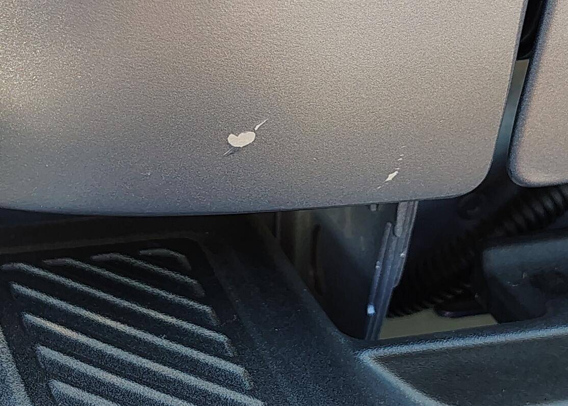

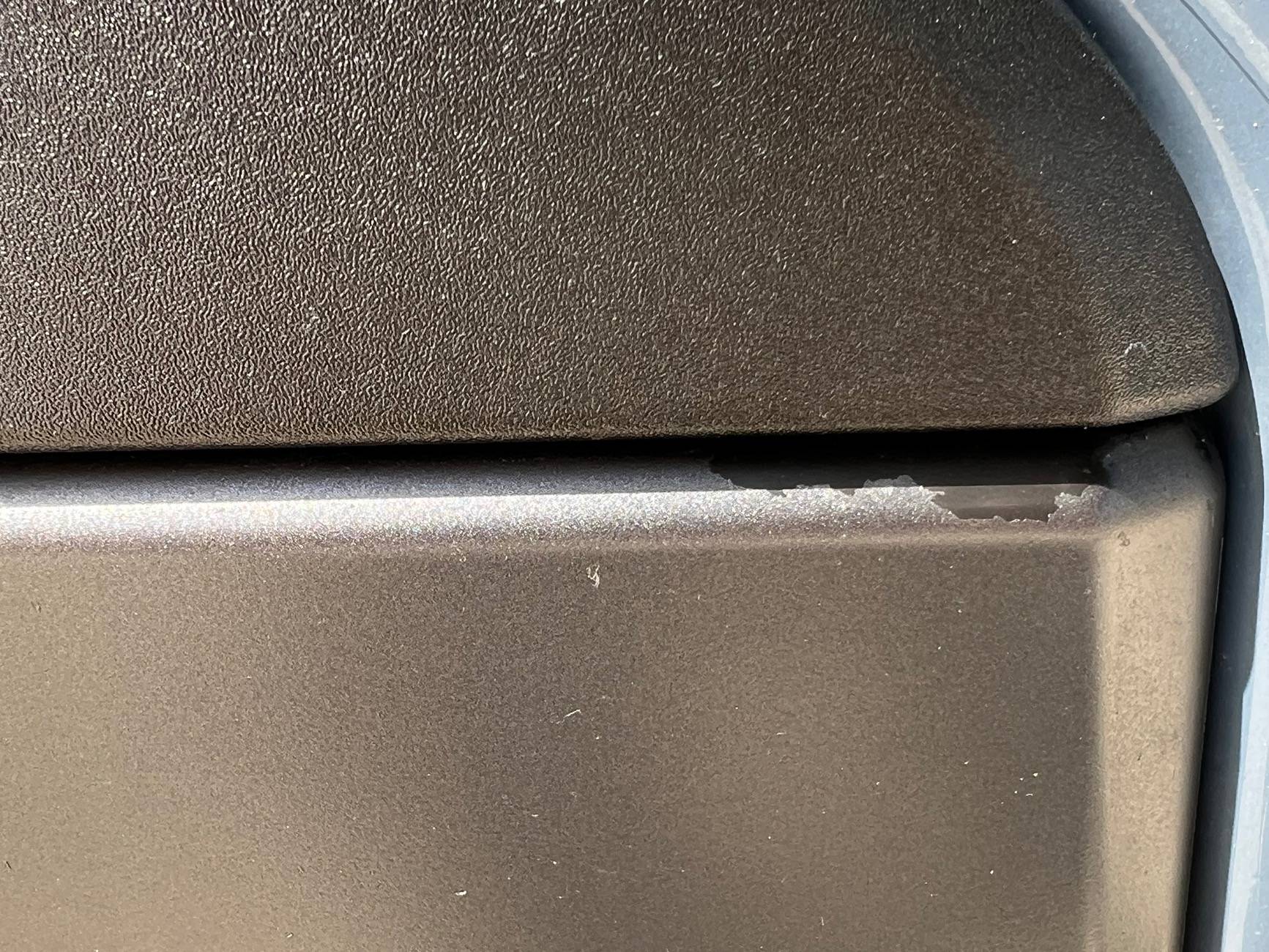

I have some paint peeling on my 23 Lariat. Has anyone else experienced this? I brought it to a Ford dealer with a body shop and they are confident they can fix under warranty. Still annoying though as I will likely be without my truck for a couple of days. I am unable to find touch up paint for the gray plastic bumper.

Very easy to nick the paint; wish the paint was tough like our washing machine. Below is my rear bumper area scratch & flake...I swear it wasn't me, but it probably was. There are Ford TSB's (G0000108 and TSB 19-7033 paint concerns) showing examples of how a dealer should examine and or test to see if should be covered by warranty. There is a mention of a masking tape pull off test. I wonder if the various cheap to expensive ceramic coatings are any good, compared to a full on paint protection film?

I had much worse on my front bumper. I used Black bed liner paint from Amazon and its a perfect match you cant even tell. The dealer also said they would respray but I didnt want to deal with not having transportation...

Good note/ Did you tape it off and spray it?

yes I taped it off, sanded it and wiped it down with acetone. gave it multiple light coats. It was just the bottom part of the bumper so it blends right in with that Black plastic air dam.
