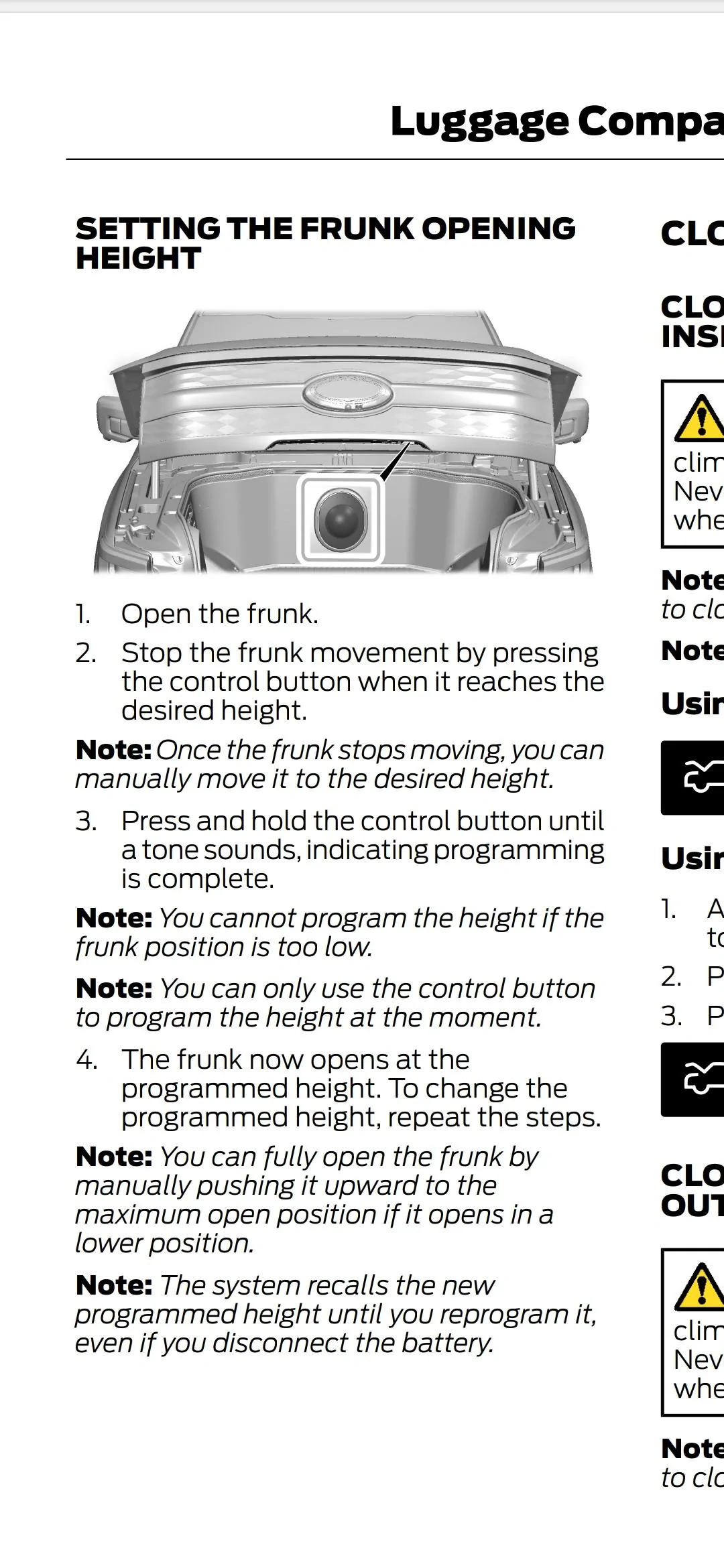

Did you try a frunk height reset?
Maybe. When I first hooked the battery back up the frunk wouldn’t go back down. So I gently pushed it down into the locked position.
