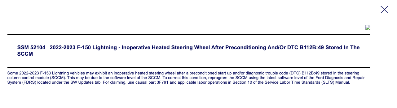

Ford F-150 Lightning Heated Steering Wheel Not Working After Preconditioning 1705771242366
Here is the technical service bulletin. Dealer should fix it if you don't want to wait for 6.5 OTA. Anybody's guess how long that will take. I got 6.5.0 in December after 6 months of no updates.
