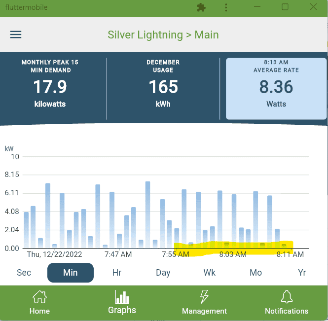

Well, 15 minutes was not enough time, when I went out to the truck it was still "idling" ie. the cabin blower motor was still operating and the truck was still drawing a modest amount of current, and the steering wheel was cabin temp not majorly warm
Preconditioning kicked off at 7:30 and ready to drive at 8:00 am, but it "idled" until I unplugged the truck at 8:15 am

I'll increase the margin to 20 minutes Thursday morning and 25 minutes Friday, 30 minutes on Saturday to see what happens, might be depending on the 30 minute idle timer to shut down the truck in this scenario.
190
14,209
15,398
20 minutes might be the sweet spot, the truck stopped pre-conditioning at that point.
After starting the truck normally it only took a couple minutes for the steering wheel to come up to temp, which is an improvement.

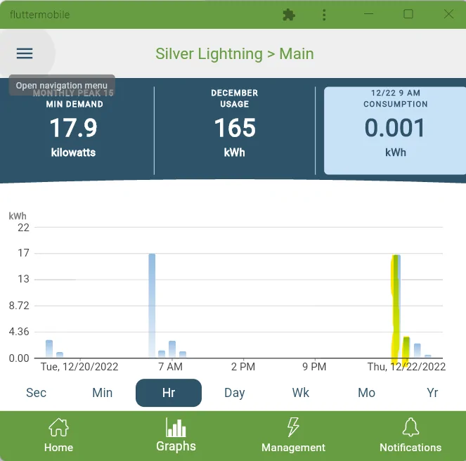

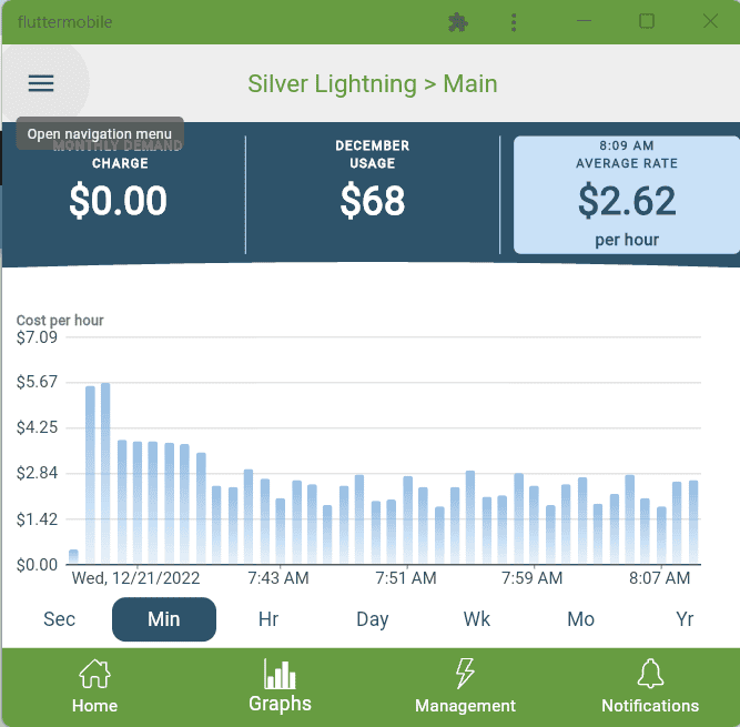

This mornings charging session ran 71 minutes to take on ~20.7 kWh of energy from the FCSP.

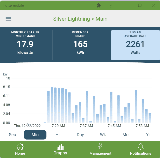

The station paused, until 7:26 am running until 7:55 for battery & cabin conditioning.
