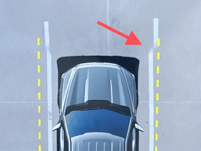

So obviously since there's a thread there, this isn't too abnormal, but how many others are experience this sloppy stitching at the corners? My MachE was perfect at this, just some weird warping at the corners. But all 4 corners of my Lightning have straight up image rips.
Is there anything I can do about this without FDRS or is this a service appointment to resolve? Can it even be resolved or does it plague everyone?

There is a camera calibration process, mentioned in an older thread, take it to the dealer let them give it a recalibration.

never had this problem in my May 2022 build ER Lariat.

Called the dealership I bought it from today to see if they can take a look. They want my truck for 3-5 business days just to diagnose it. Considering my wife and I share this as our only vehicle I asked if they'd be providing a loaner, of course they won't until it's diagnosed. I just bought it from them 2 months ago. I wish I noticed it before I left. Calling another dealership and they couldn't get a service advisor on the line to tell me how long they would need it to diagnose. I need to do this in a day, whatever happened to scheduling an appointment and actually having it looked at that day? @Ford Motor Company you seem to take an interest in things like this, can you help me out?

If you have Forscan you can try to run a calibration for the 360 cameras in an empty parking lot. You drive below 4mph down the empty rows until it’s complete. Could fix it before the dealer gets a chance to get it in and looked at.

I agree, it is unacceptable to require having the truck for that amount of time for something that can diagnosed in 10mins. I call BS that and go to the service manager and/or the GM.

I don't have Forscan, or the required cable. Sure DIY would be faster than the dealer, but I can't really justify that cost at the moment.
