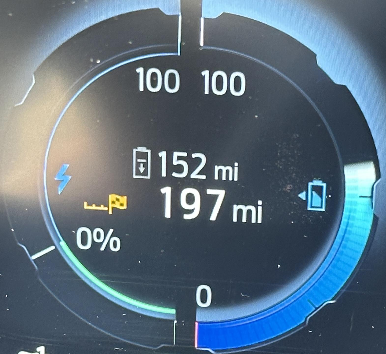

Hey, forum. I’m currently renting a Lariat ER, and somehow managed to change a setting that “locked” the battery charge indicator at 197 miles (see pic). The display reads the accurate charge level in gray above the 197 miles.
I’m assuming it has something to do with the yellow / orange checkered flag icon but I’ve been through the settings and can’t figure it out.
Does anyone know how to change it back to the standard view that only displays the miles left in the charge? Any help you can lend is greatly appreciated. Thank you.

Looks like you have a destination route active on the Ford Navigation map, try closing out that route, the value you're seeing is the distance to the point of concern.

Thank you for the quick reply. Yes, I thought of that and checked the native Ford Navigation App. I don’t have a route active, and have never actually used the Ford Navigation app. I’ve only used Google Maps through CarPlay.
Is it possible that the owner of the truck has set something on the Ford Pass App? I rented the truck for a week, but I am due to return it tomorrow. So maybe that is it?
Or is it possible to drop a waypoint in the Ford Navigation App, but not actually navigate toward it? That’s the only other alternative I can think of, but, again, I never actually used that app so that would just be another mystery.

Go into the Ford nav, enter a destination, and go. Then cancel the route. That should clear it.
This bug has been reported in the Mach-E which has the same Sync 4A system. This might be the first one I’ve heard about in a Lightning, but not surprised.

Yep! That did the trick. That was an easy fix. I really appreciate you taking the time to reply.

I was tested this issue while driving home from breakfast this morning, set a destination for home, and I changed the view of the map to route overview and certain other views, in those modes, you do not see the address bar with the red X to cancel the route function, when I returned to the view where I could see the address bar I could cancel the route.

The strangest part of this glitch was that I never even opened the native Ford Navigation Map before I noticed the issue with the battery charge readout on the instrument cluster. I had only used Google Maps over CarPlay for nearly a week. So it wasn’t like I set a destination and forgot to close it. I didn’t opened that native Map function until the issue occurred.

As I mentioned, people with Mach-Es have reported this issue and swear they didn’t use the nav. Chalk it up to some obscure bug.
