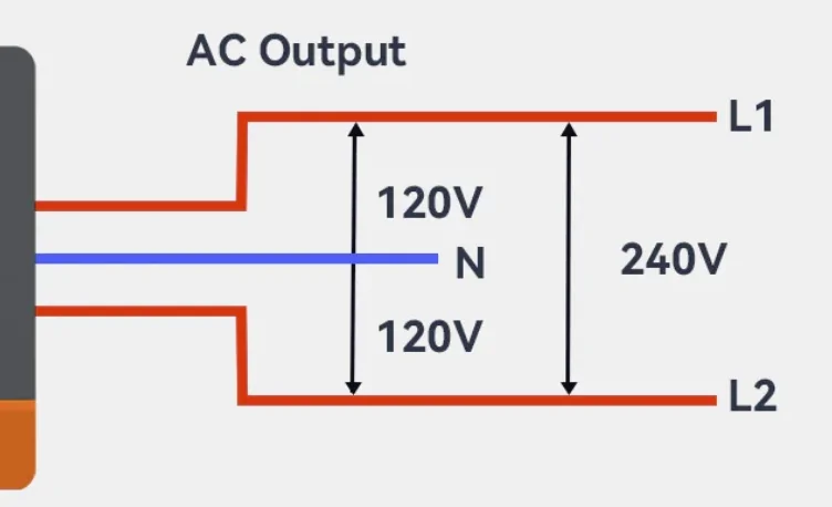

Didn't really mean to kick off so much anxiety here, just wanted to reduce some potential risk of fire in the future.
The way this is protected in your home is by having a breaker set for the houses wiring, but you could use a 15 amp extension cord on a 20 amp outlet in your home and achieve this same result. My concern is that this is a fair bit more than 20 amps on a single 5-20p outlet, and it looks like the truck might let you draw as much as 30 amps on a normal extension cord from the bed outlets, which is a really bad idea. They should really have 15 or 20 amp breakers somewhere in the system; I'd put them on pairs of 120 outlets.
I had the same concern - 20A outlets drawing 30A for a sustained period of time would worry me.
20A outlets with no overcurrent protection (breakers)? What could go wrong?
EDIT: So must be a split phase inverter driving the bed circuits with the 120v's on opposite sides of the split something like this. And with 30A available from the inverter.
Ford F-150 Lightning Ice Storm Power Outage — Pro Power Onboard to the Rescue! split phase inverter
