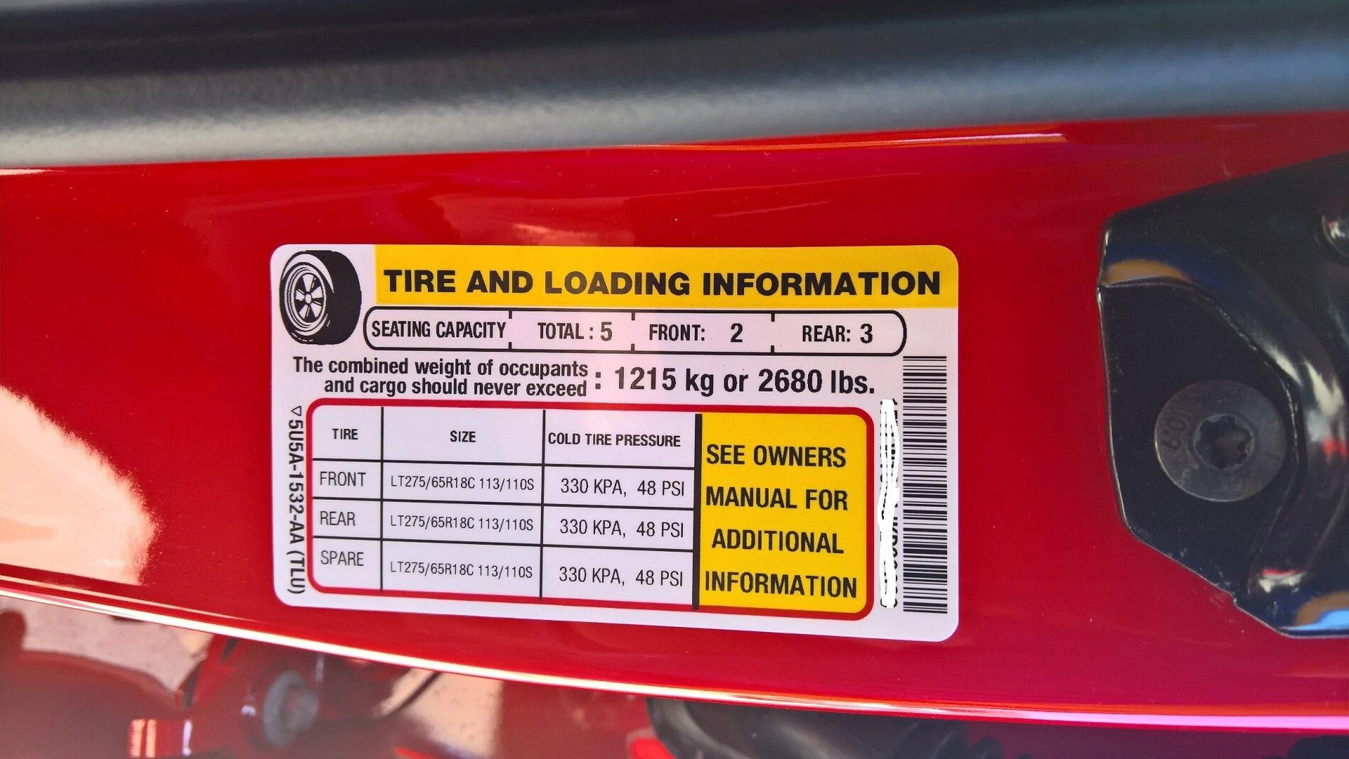

I like your viewpoint.
But what were you saying your weight increase would be for the battery size and motor size required to meet your desires of a PHEV? (I mean increase over existing Powerboost battery/motor)
Keep in mind that once Cargo Capacity drops below ~1500lbs, the crying begins amongst the folks that choose a 1/2 ton for towing loads with a WDH. Basically RV towing. The current Powerboost is already barely hanging on to 1500lbs, unless you start with a stripped XL trim. That'll give you 1900lbs in 2WD. But few purchase XL's to sit in for 1000 mile weekend and summer adventure.
Again, with the additional ~800-1000lbs of Cargo Capacity afforded with the HDPP F150 chassis, your wishes would be possible today! But at this point Ford will not allow the HDPP option for the Powerboost or any trim above XLT.
Here's my brother's XLT 3.5 Ecoboost HDPP F150's Payload capacity. He can drop ONE THOUSAND POUNDS on his truck and STILL have more Cargo Capacity/Payload left to use than my Powerboost starts with. Simply amazing, if you think about it.

I've got Payload envy! My '18 Ecoboost Platinum has 1512 lbs payload, the one '21 Powerboost Platinum I looked at earlier this year only had a 1279 lb payload capacity. :cry:
I assume HDPP rides better than an empty Super Duty and definitely provides a lot of weight rating.
I would have thought HDPP would include additional cooling, but apparently it's just gearing and springs.
It seems to me there should be at least one spring option between standard and HDPP.

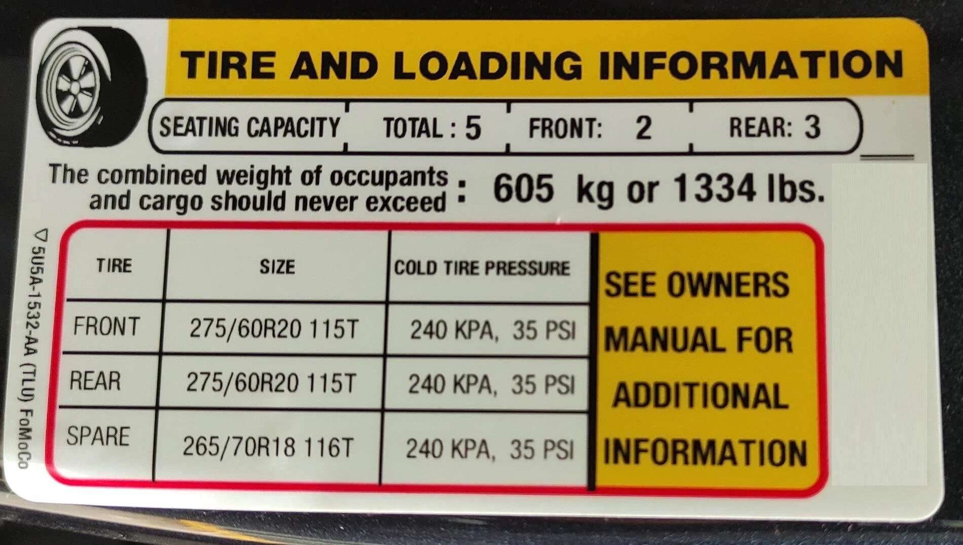

My PowerBoost has the Max Tow option and the payload is 1334lbs which I could exceed by having a metal bed cover and a bed full of tools and gear.

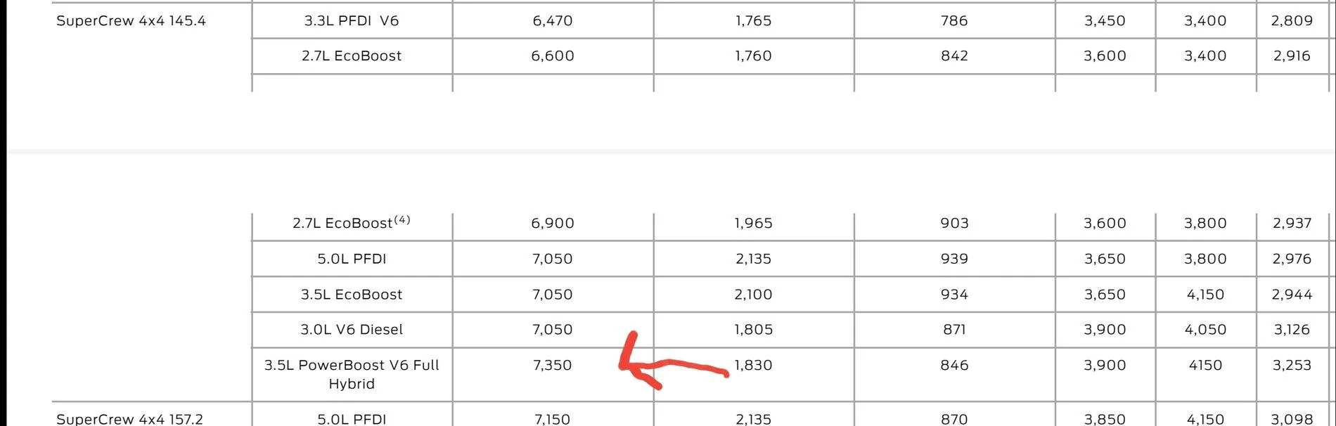

Excellent post ^ because it is actual experience with the Powerboost towing near Cargo Capacity. :)
You might not know it but somehow Ford added a three hundred pounds to GVW for the Powerboost. I can't find any documentation that accounts for what they did to achieve it. Same axle and leaf pack as the non-Powerboost. My only guess is that the battery storage area crossmember might have allowed for the frame to be specified to carry that additional GVW?
Without that #300 increase, you would have been 100#'s over?
So can I ask about the "supposedly Ford is working on a Super-Powerboost" ? ??
It sure seems like they should offer the "utility" of the 7.2KW power grid to the SuperDuty line for all the obvious reasons.
(Although I will still dream about Ford allowing the the current F150 HDPP motor choice to add the Hybrid 3.5 to the current choices of 3.5EB & 5.0 Coyote)
Ford F-150 Lightning Impressions from Ford F-150 Lightning EV Tour -- Boston Screenshot_20211022-140253_OneDriv
