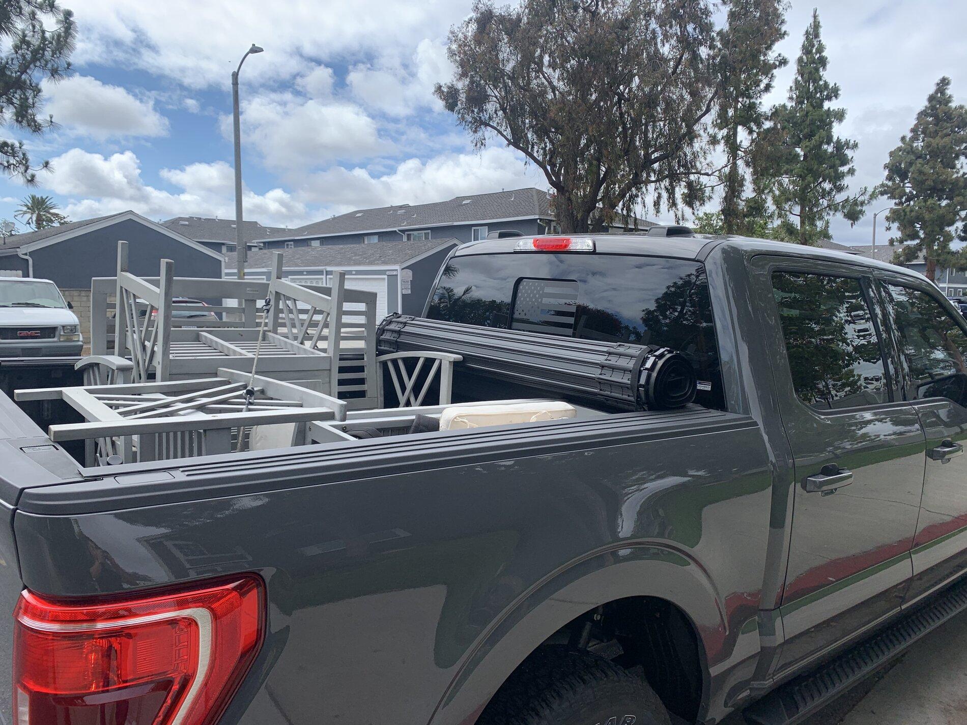

Finally got to test the new X4s with a loaded bed and I love it! It’s nice to be able to roll it out of the way and still be able to see out of the rear window.

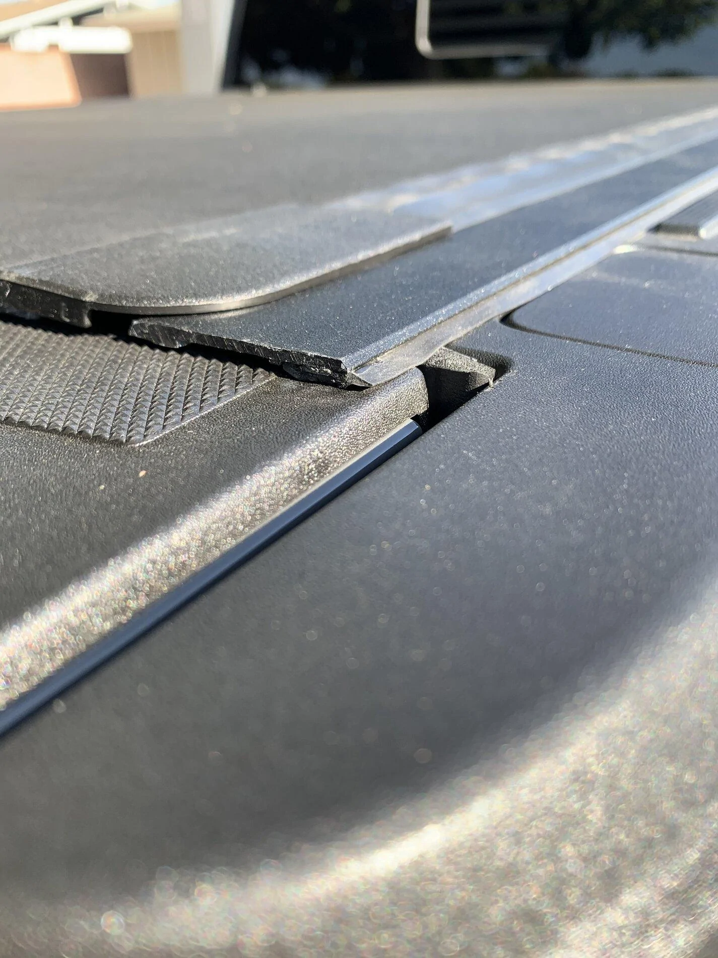

Is anyone else having issues where the rail meets the tailgate? Both my rails had the rubber coming off the rail when I closed the tailgate, looks like the adhesive wasn’t done properly. I managed to gorilla glue one side and don’t have issues anymore but the other side doesn’t seem to stick, anyone else having this issue?

My auto down works and I can close it with it down. I would say you are hoot to go.
How far is does that 'roll' stick out into the bed? I have the mini and just curious, sorry if you have already answered this.

I had to glue mine and then put a little silicone spray on the top of the tailgate.........Stays put now

Perfect thanks! I reached out to Bak and they are sending me a new rail so I will do the same.

I just installed mine yesterday and have the same thing you do, plus the adhesive nearest the drivers side cab is not what it should be.
Was the Customer Support from Bak easy to deal with?

Yes, super easy to deal with! They sent me new rails hassle free, haven't had a chance to installed them yet but I will send an update here tomorrow when I do. One thing they did recommend was for us to install the rails while the tailgate is closed. This way it is adjust properly and we don't have that issue anymore. This info would have been good to know before installing but I cant remember seeing it anywhere on the instructions or videos I've seen. After this experience I highly recommend Bak as a company, they stand behind their product!
