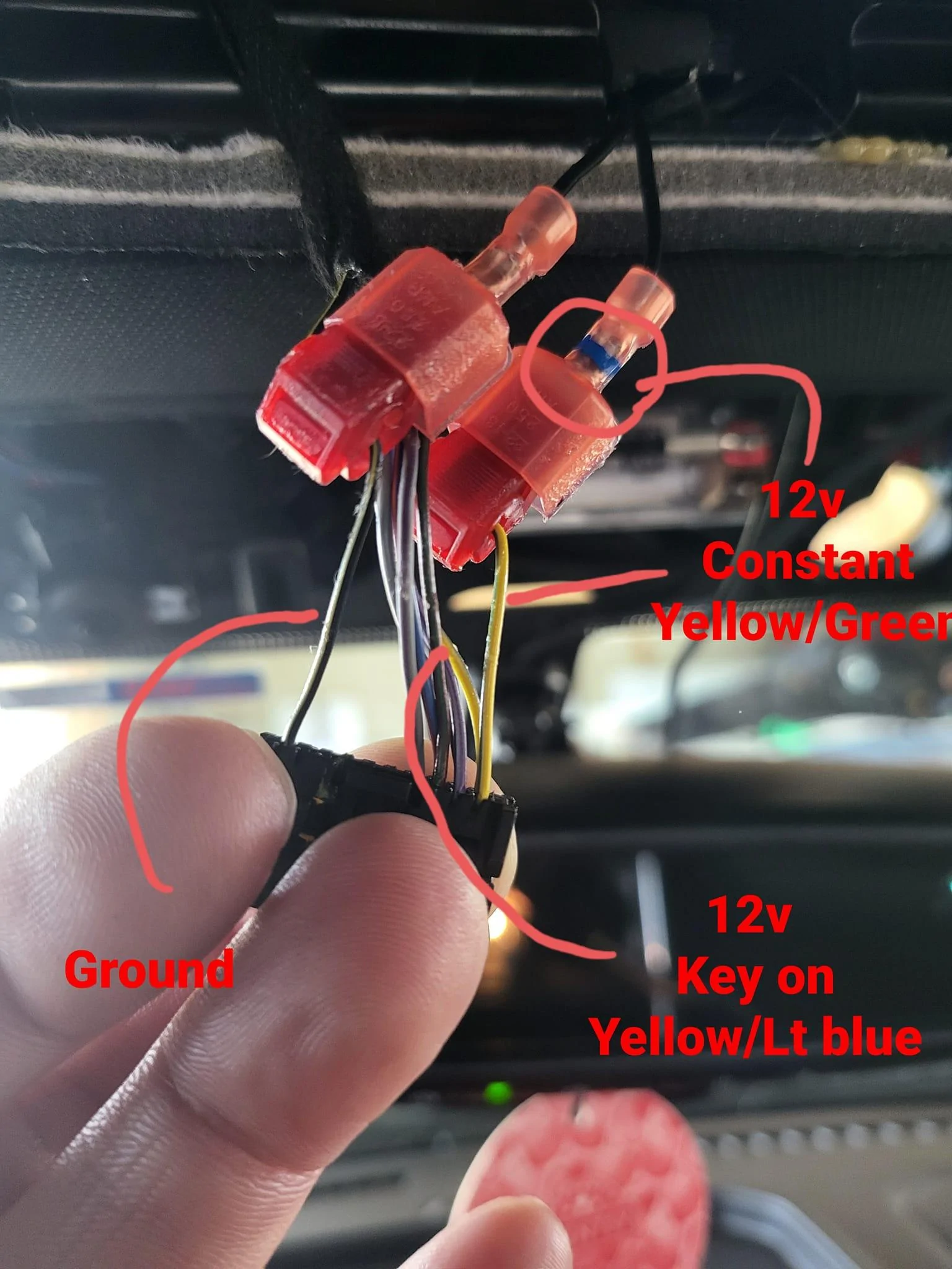

No, you have to use the line taps provided in the kit from Kia. It's as simple as plug and play tho. Some people on the 14th gen FB group have modified the two harnesses to make it plug and play.

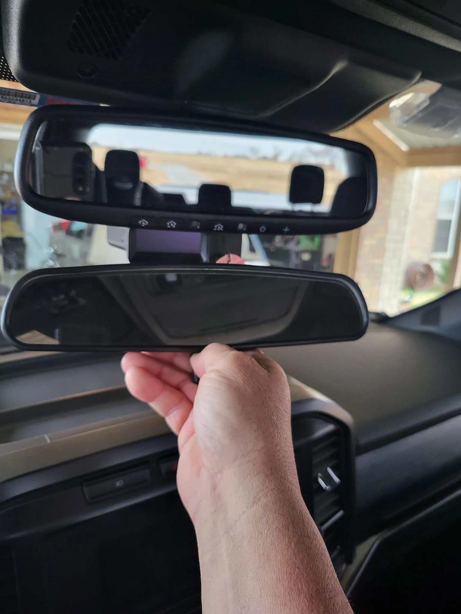

Can I trouble you for a pic? Just super curious on if it looks out of place. Thanks man
Nah, it looks great. Even better than Fords, imo, because it's more rounded/ squared off.
Here's a link to a write up someone did, took me all of 15 minutes including programing to do.
Here's the same photo incase the FB post doesn't load for someone. Top is the Kia, bottom is Ford

I mean is an $140 is worth the 'plug and play' aspect? Otherwise, the mirrors are nearly identical. Looks like the removed the compass from the kia and added a separate button for something, auto dim on and off? (vs just one on/off button)?

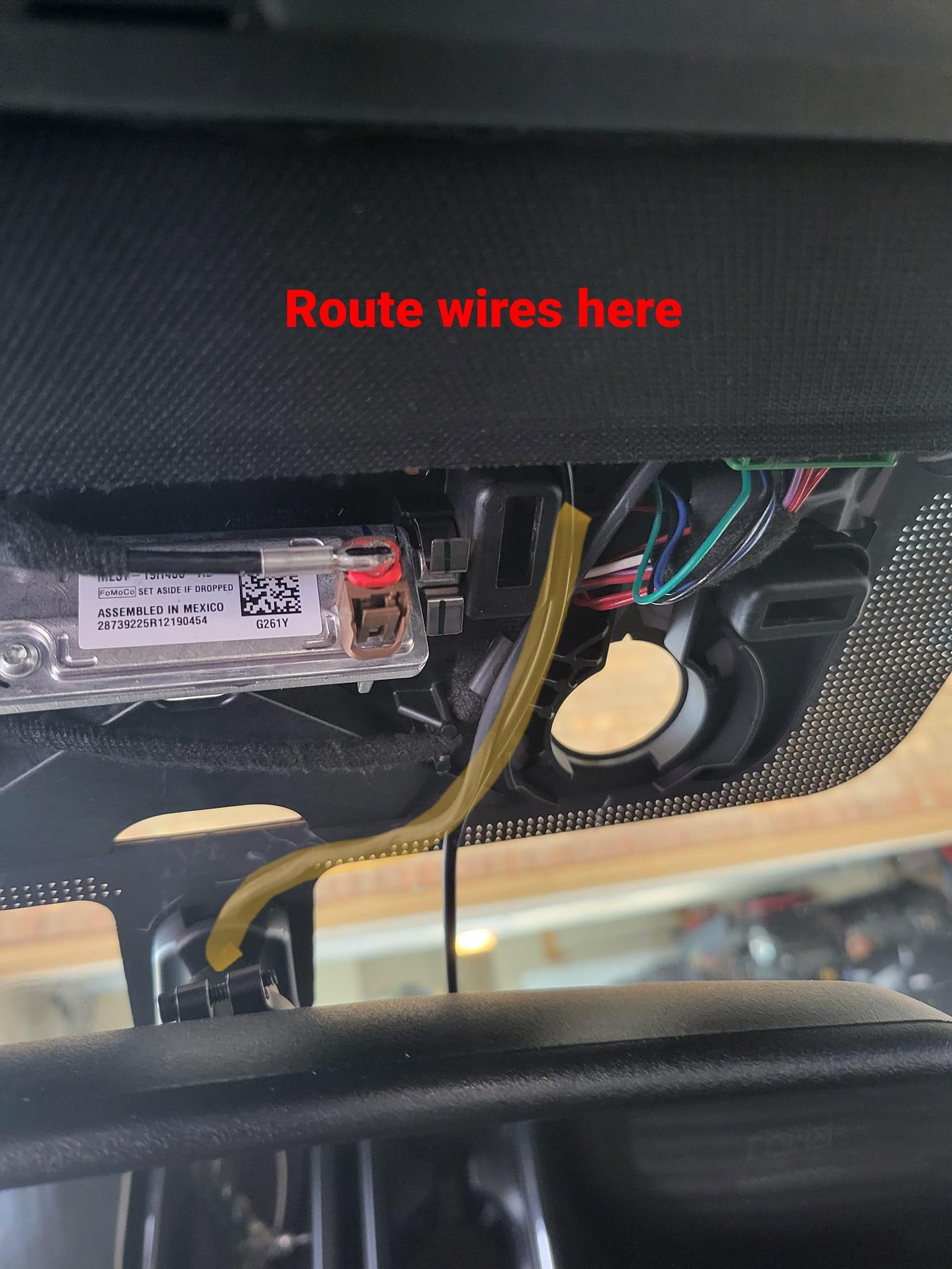

I'm guessing the thing that says set aside if dropped is the camera?
Nah, all of the comments are either; thanks installed it was easy, how do you pop the covers off, or poor 'pheasants,' should have got a loaded lariat.

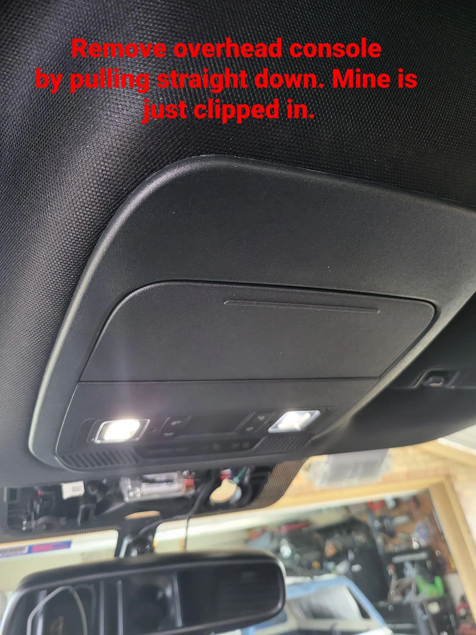

Im not following, sorry. You do have to remove the cover which as the lane keeping camera in it.
You can read sticker on the camera in the one pic. It says if dropped set aside . Must be really fragile. Thanks for getting back. Looks like they are on backorder now. Everyone thinks it's a good idea.
