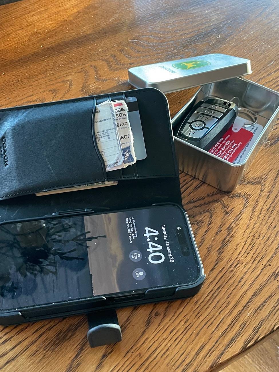

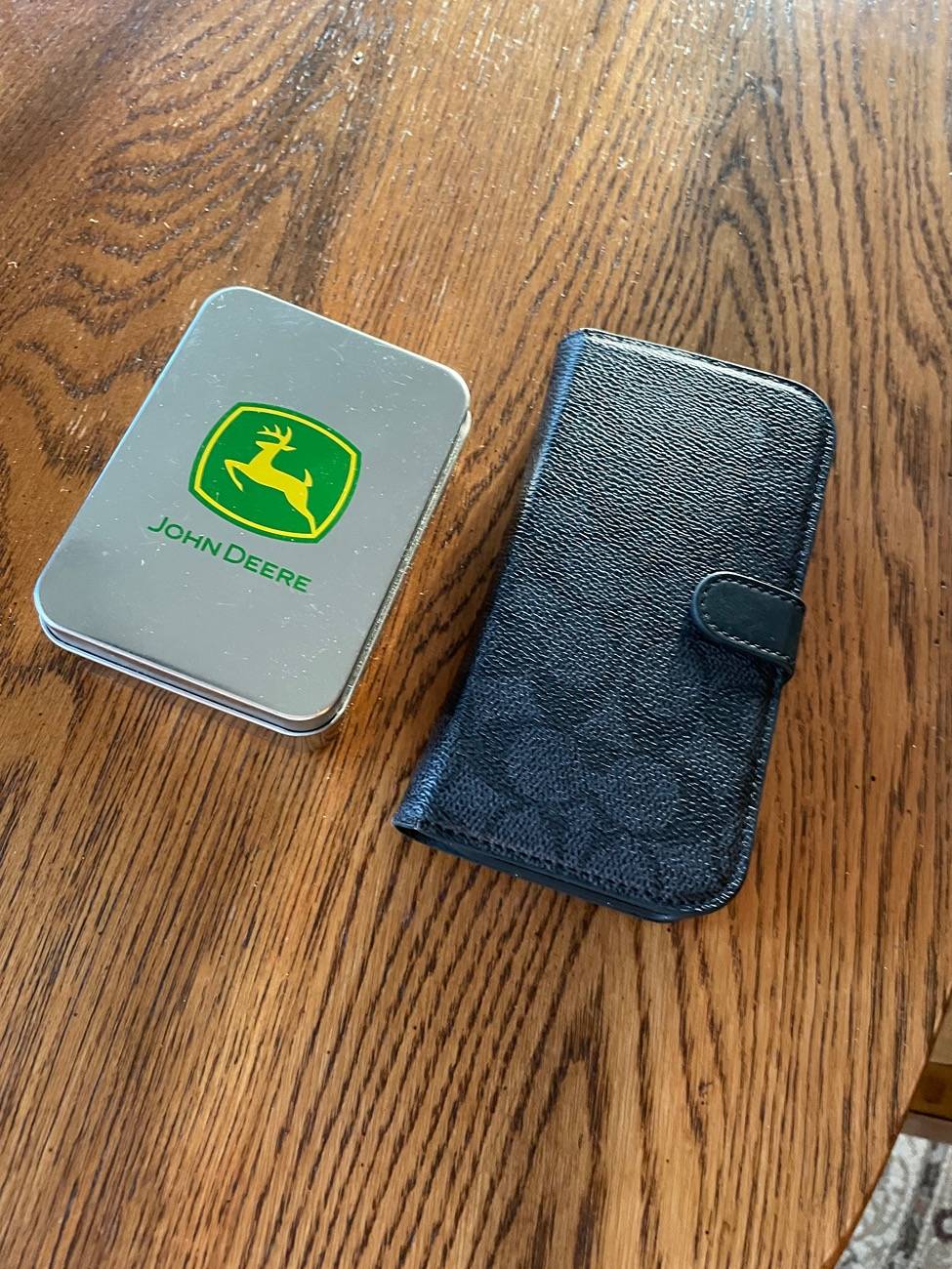

The metal container from a deck of cards works as a Faraday for the key fob.
I did splurge on a Faraday pouch for my phone.
Both seem to work for anti-theft of signal.
