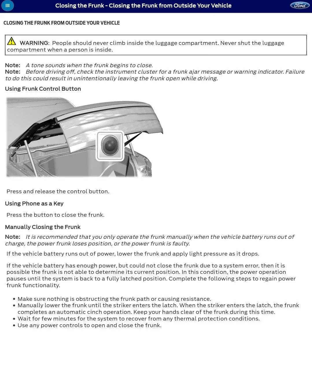

If the truck fully powers down it will lose the position of the frunk and you have to close it manually so it can establish known location again.
So @Firestop you can leave it open as long as you want but you will have to close it manually. It is not broken.

@Gimme_my_MME , I too thank you for that info! I had read that page in the manual while I was following up on my experience….I didn’t read it to mean that this would occur when the truck fully powers down…as mine had.
@Ford Motor Company may want to elaborate in the manual on what actions/conditions could cause a ā€œsystem errorā€ in the operation of the Frunk. It hadn’t occurred to me leaving it open overnight while on the charger would allow the truck to fully power down….and create an error condition…
Again @Gimme_my_MME , thank you for your help…it was exactly the way my truck behaved and I take this one off my punch list??
