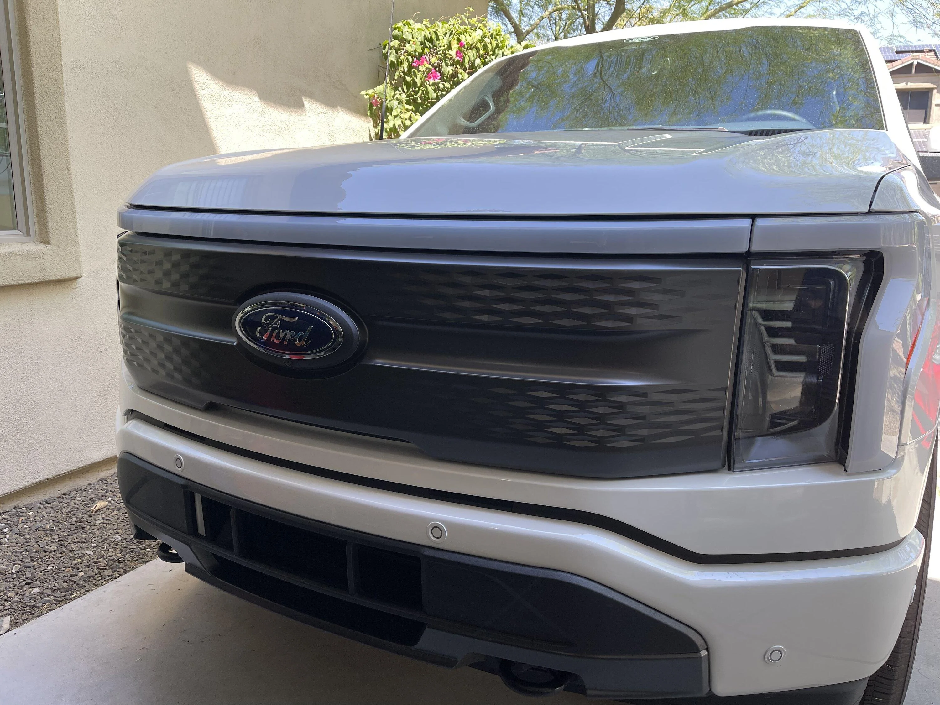

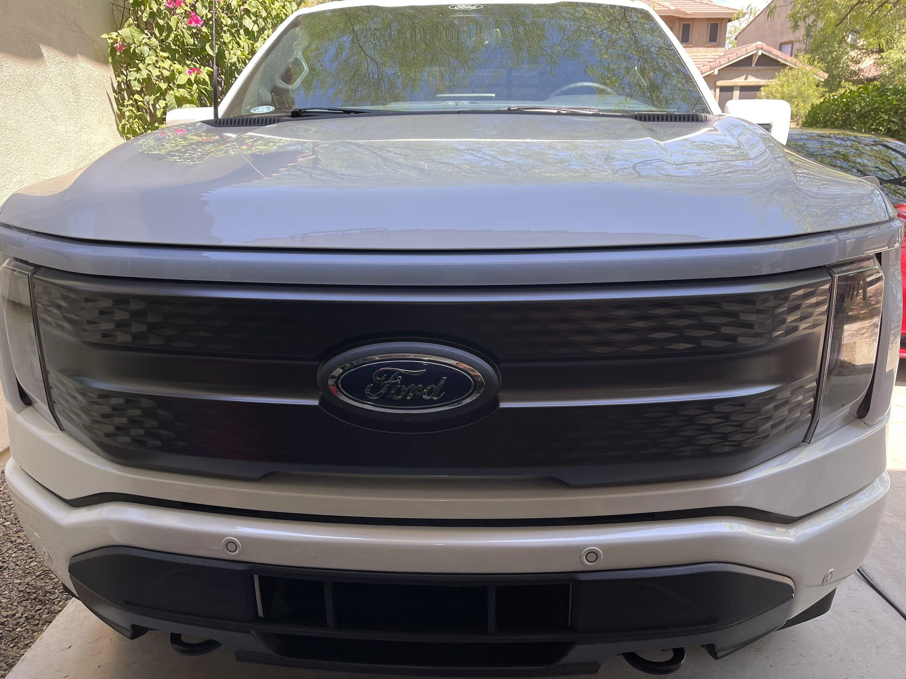

So less than a month into ownership, I was washing her up and lost a piece of the paint on the grille!! No pressure washer was used this time just a garden hose. Contacted the dealership about a replacement as it seems very likely a manufacturer defect with no luck so far. Am I alone with this small but sad issue?
This is a warranty issue. Don't loose faith. Ford will cover the repair and the dealer should replace it. Make your claim.

What was the ultimate resolution?
Apologies for the delay,
Ford came thru and brought out a new grille to replace the damaged one when they came out to fix my broken Frunk which was awesome! They did however put the wrong grille on. I got it back with an XLT grille that apparently no one noticed. The correct grille is at the dealership now. Just need to be home long enough to get it replaced
Are they letting you keep the XLT grille? Probably could sell it to someone with a Pro (I can't imagine it's cost effective to ship it, or I'd be interested...)
I donā€™t know but it makes sense to me! Iā€™ll find out next week when I get it swapped
Unfortunately, I would not count on it. In my experience, the dealership needs to keep the part in order to substantiate the warranty claim.
