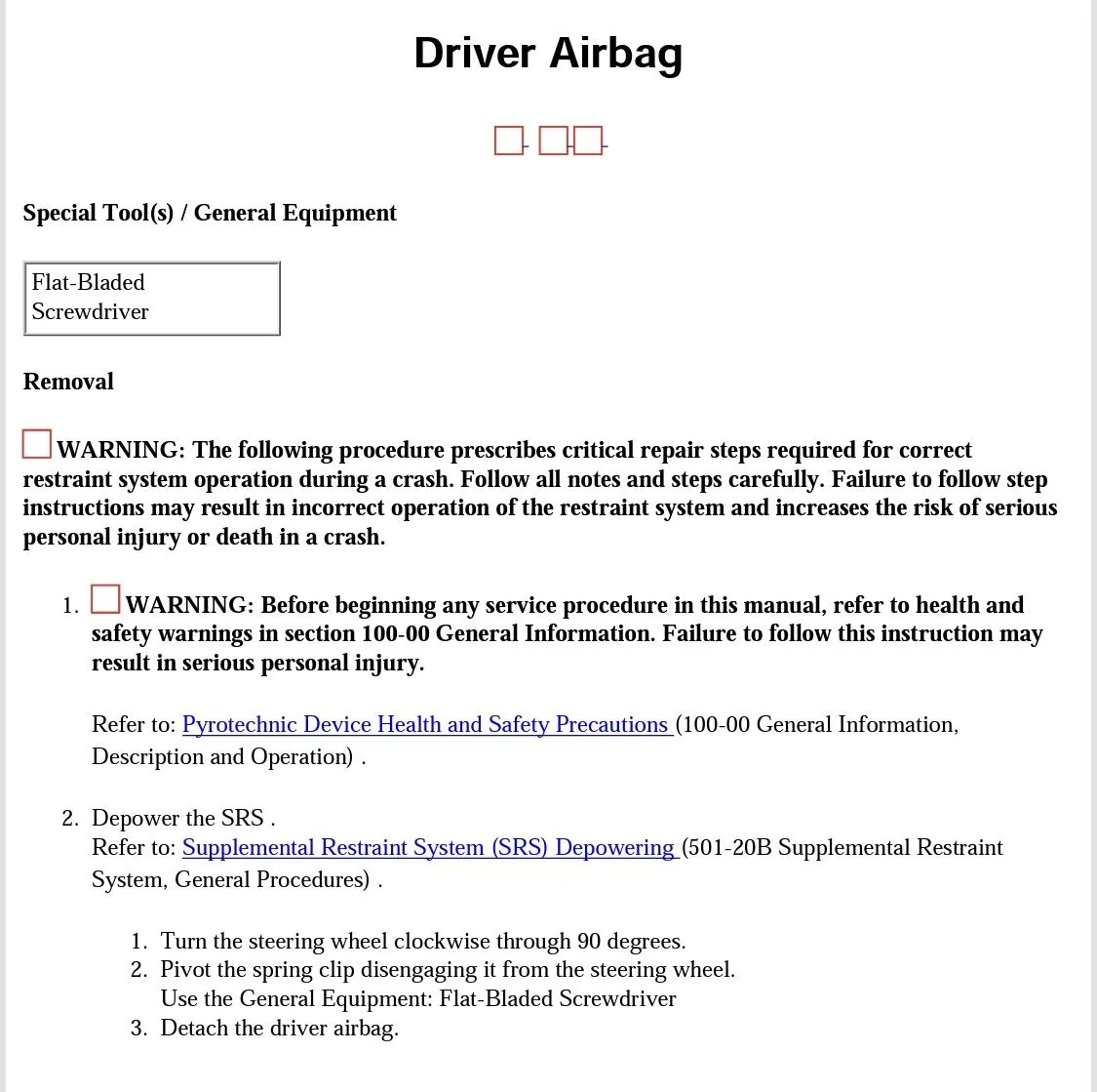

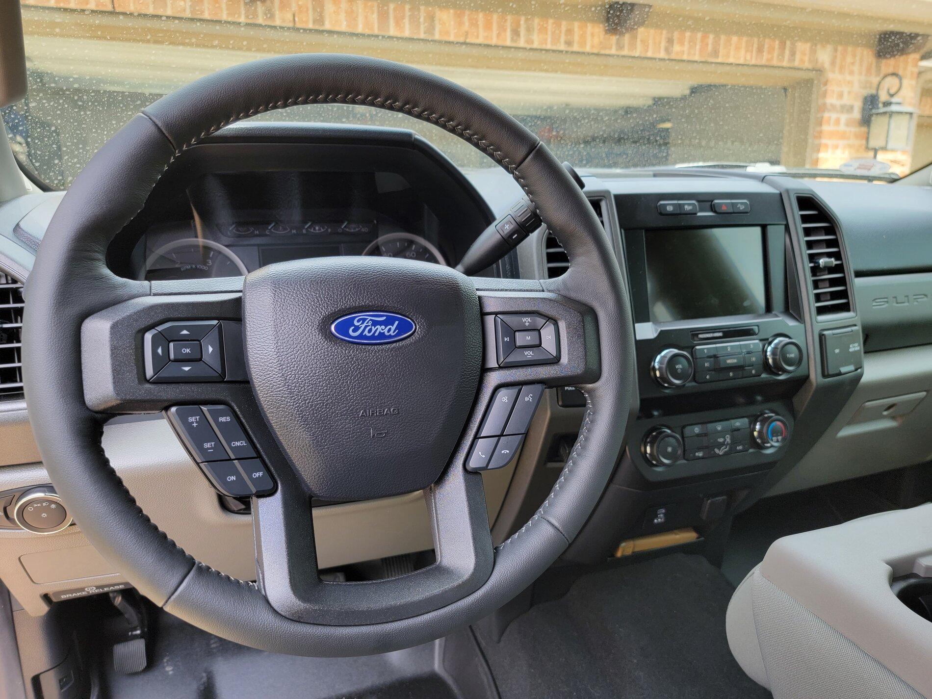

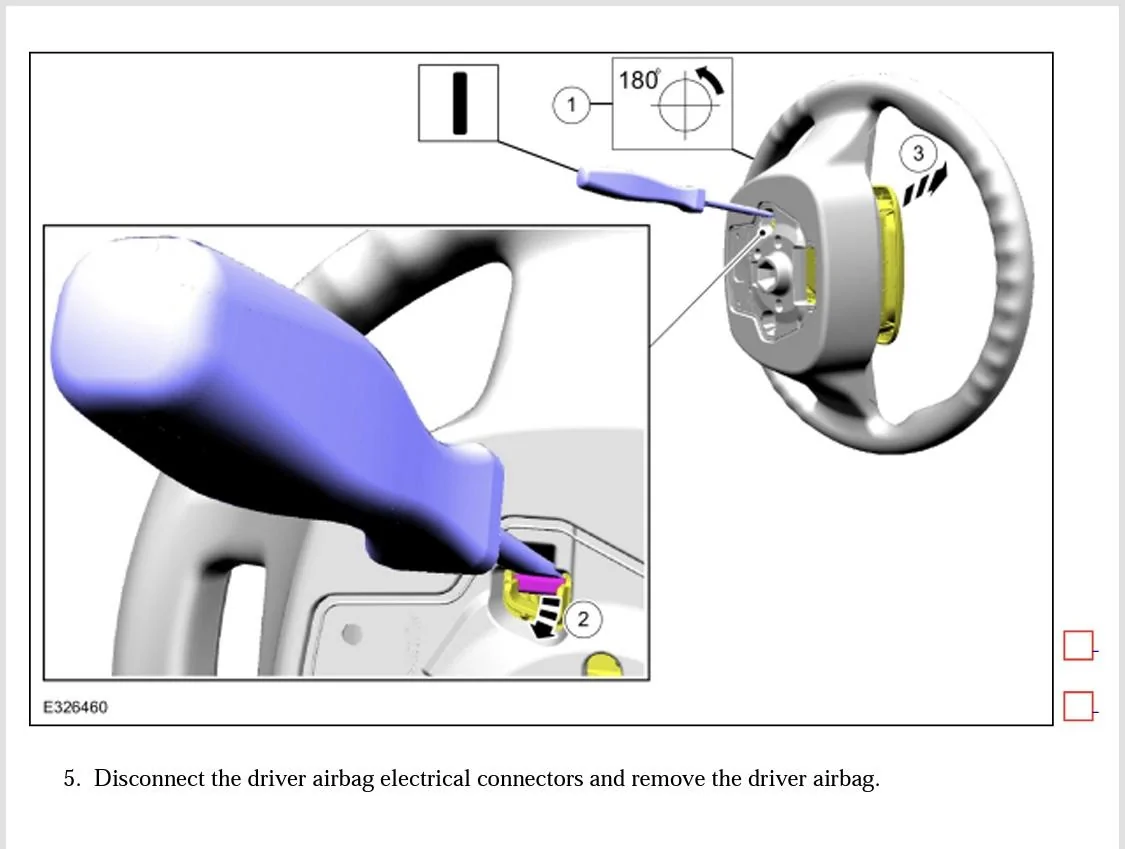

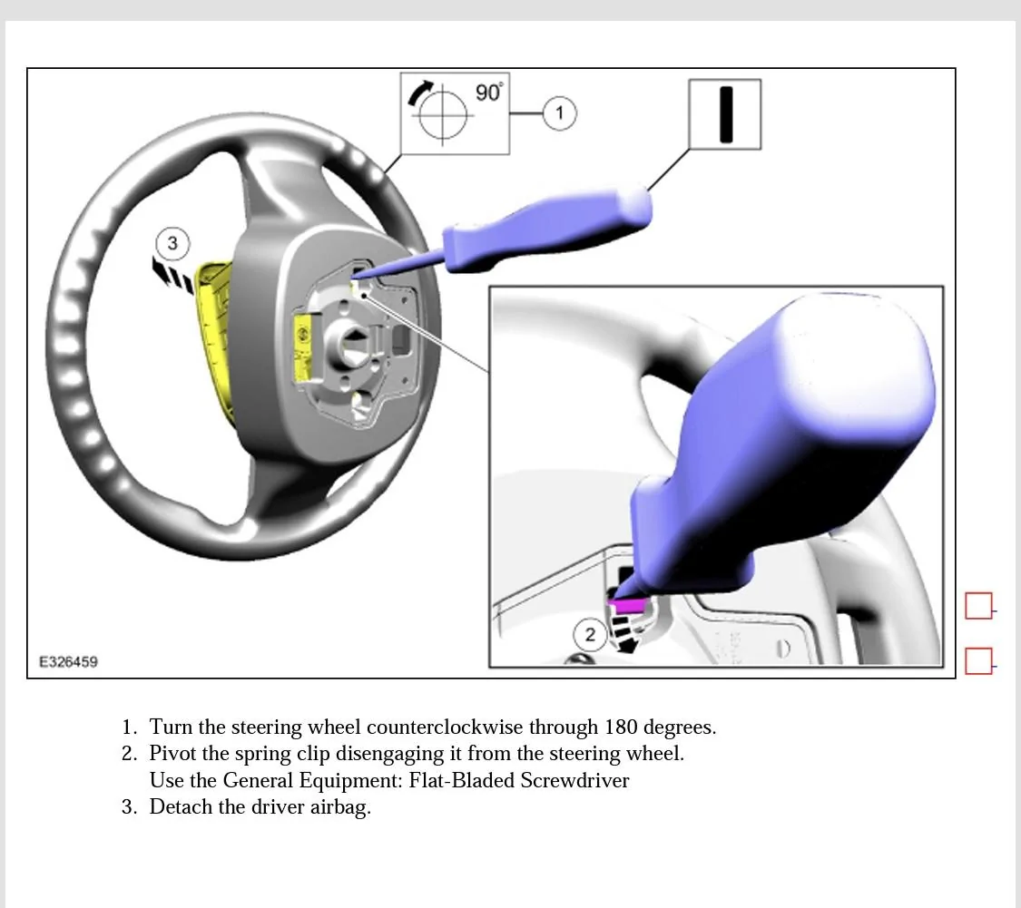

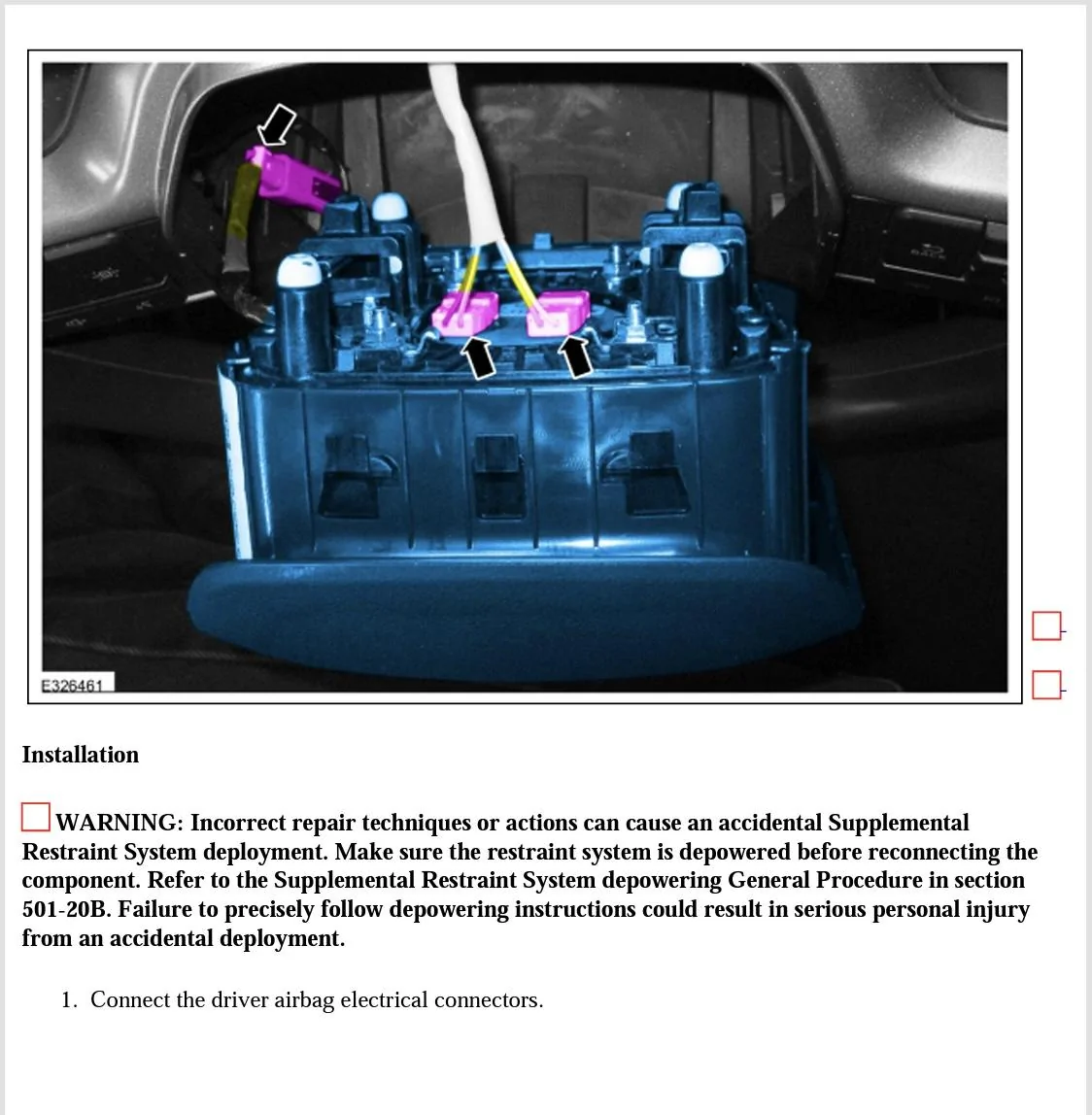

Ford F-150 Lightning Leather Steering Wheel Swap 9C5362D4-4461-4C71-8F5D-4628DAEC136D
Ford F-150 Lightning Leather Steering Wheel Swap AB81A161-588F-4EC3-B115-1ED0B8FF6B31
its not bad
