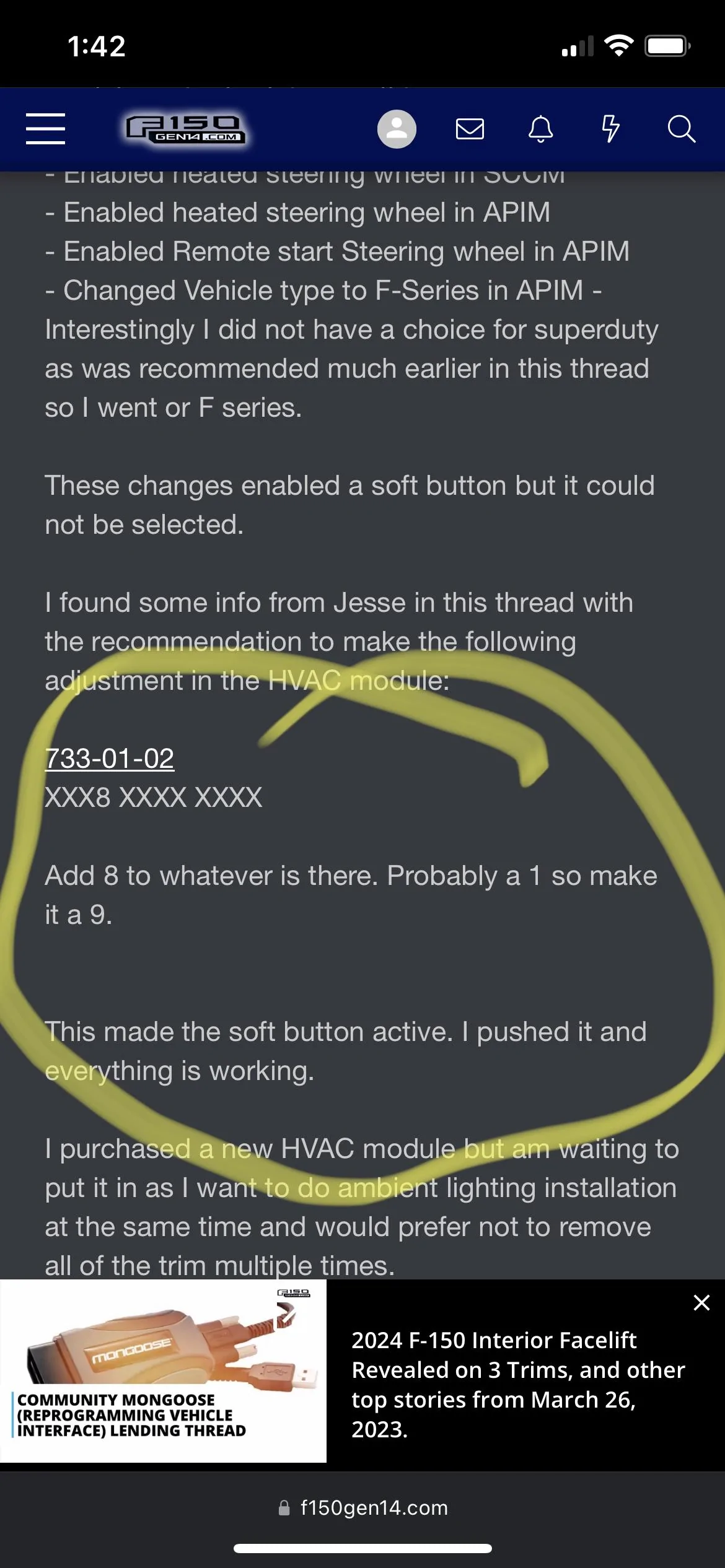

Has anyone confirmed that the software button option will work on the lightnings?
I have not but believe this is the value to change. You may need to change the value as this was for an ICE F150.
From the forscan settings I've seen I don't know that that would work. My module has an A in that spot, which also means that it is stating that I have a heated steering wheel. I think the problem is that there is no climate screen I can access on my truck, it is all done through the controls under the screen.
You can still change the A to the numerical value. Also, I think there is a (slightly hidden) climate screen, just not an easy way to get to it. I believe by pushing one (or some) of the hardware buttons, a pop up appears on the screen that shows you the Heated Steering Wheel option.
I haven't done the mod, and no longer plan on doing it (cost vs benefit analysis). I'm just speaking from memory of making climate adjustments and APIM adjustments on my previous F-150.
That I'll have to check on. My HVAC setting of A should show my truck as having a heated wheel (although I didn't make the change so I'm not sure why it is like that). I'll see if I can find the way to access the climate screen, thanks!
Your truck recognizing that you have a heated steering wheel, and having it show up on the UI may be 2 different things.
